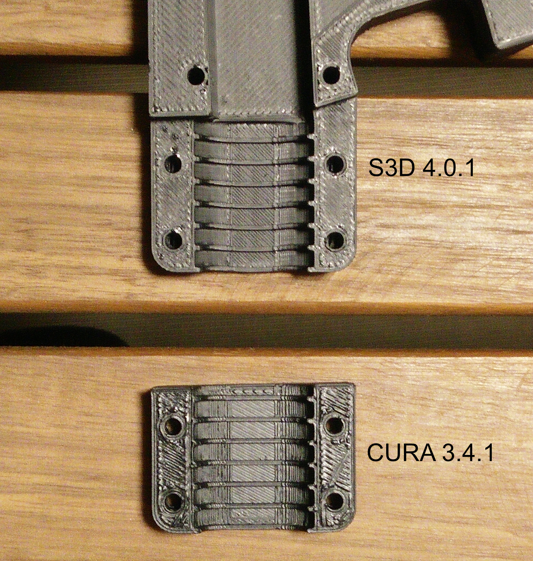

Post by polygonprint » Sat Oct 27, 2018 12:41 pm
Came across another odd thing today while printing. See attached. Not having much luck with S3D at the moment. The fine ribs on the S3D print are warped. Feed up with results using S3D I jumped across too Cura and quickly setup a profile at 0.2 layer height trying to match setting as best I could. I printed a small portion of the part and the ribs look straight. The S3D print is at 0.1mm layer height however.
Would anyone have an idea why this is occurring?
