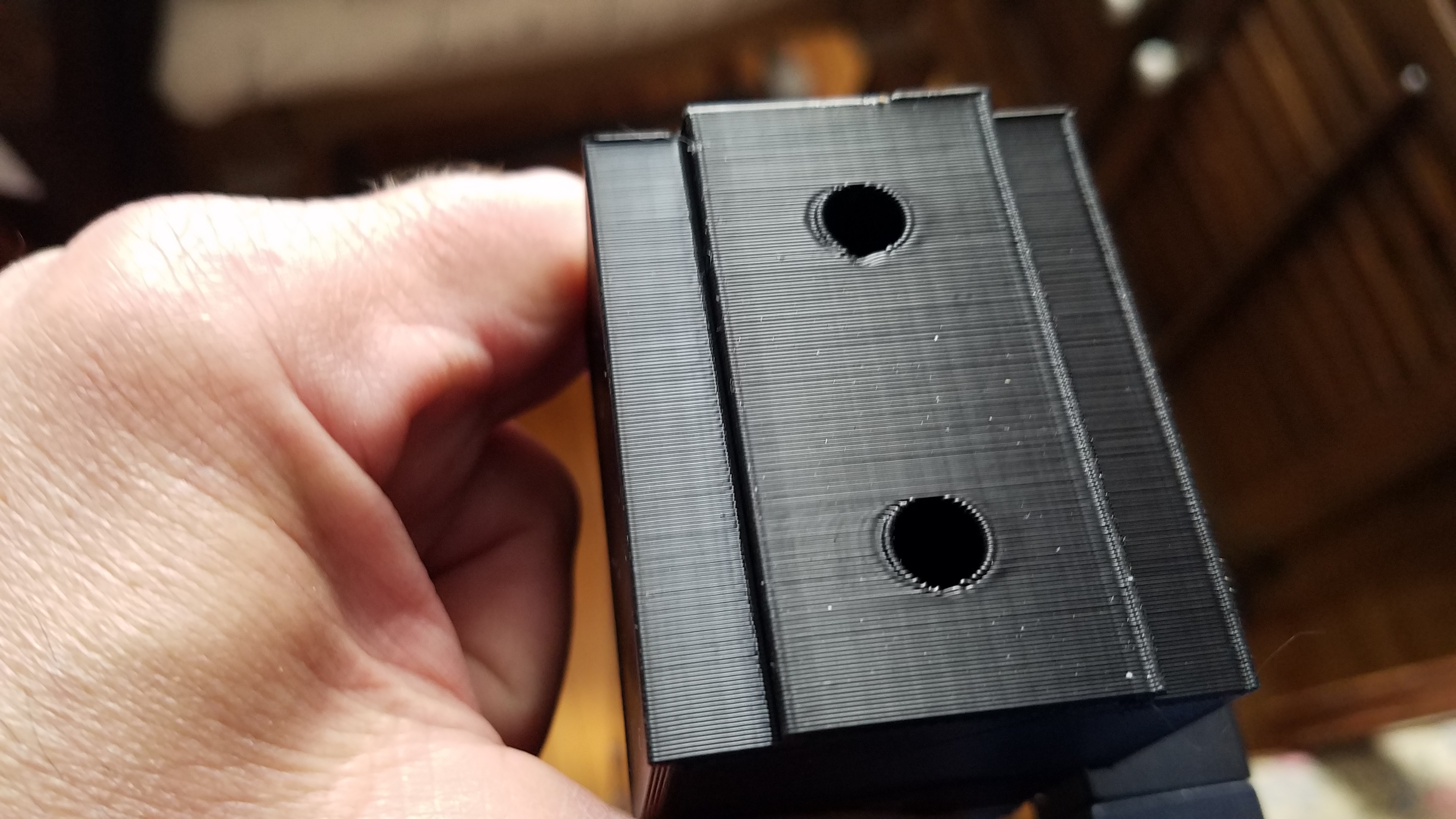

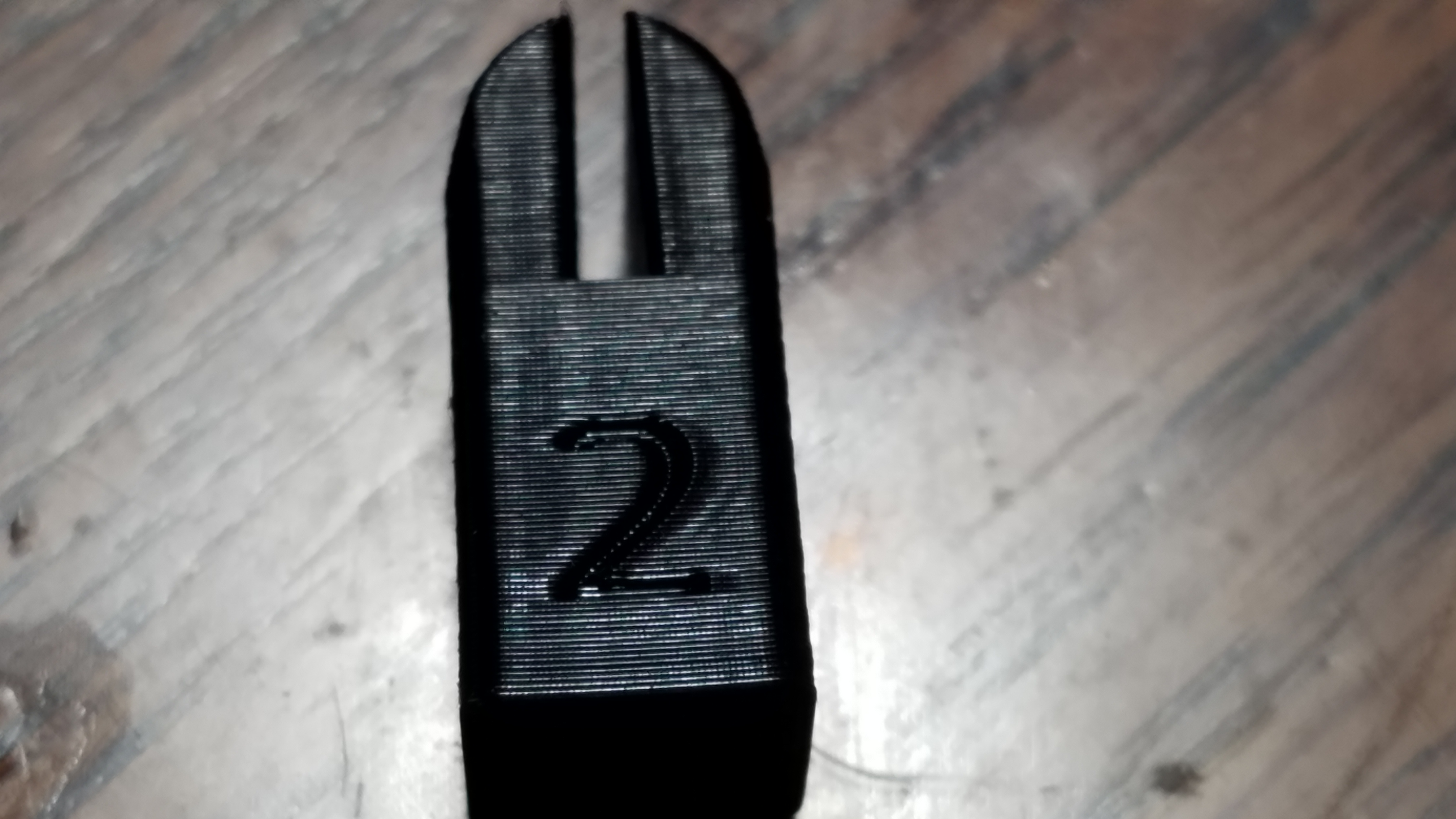

I would highly suggest you find a good model that is used to show ghosting and print it before you install the mounts. I believe ghosting is worse with the dampers but I did not do an A-B test. I do know I see it some part but would rather have the quiet operation as I am not doing production work.
See attached file for example of ghosting when using 910 Nylon

Post by airscapes » Thu May 16, 2019 3:39 pm
A better picture of ghosting, this is abs was printed at 50mmS with 70% reduction on perimeter
I have read that printer with moving beds suffer more from this artifact than other designs so may not have anything to do with dampers..
