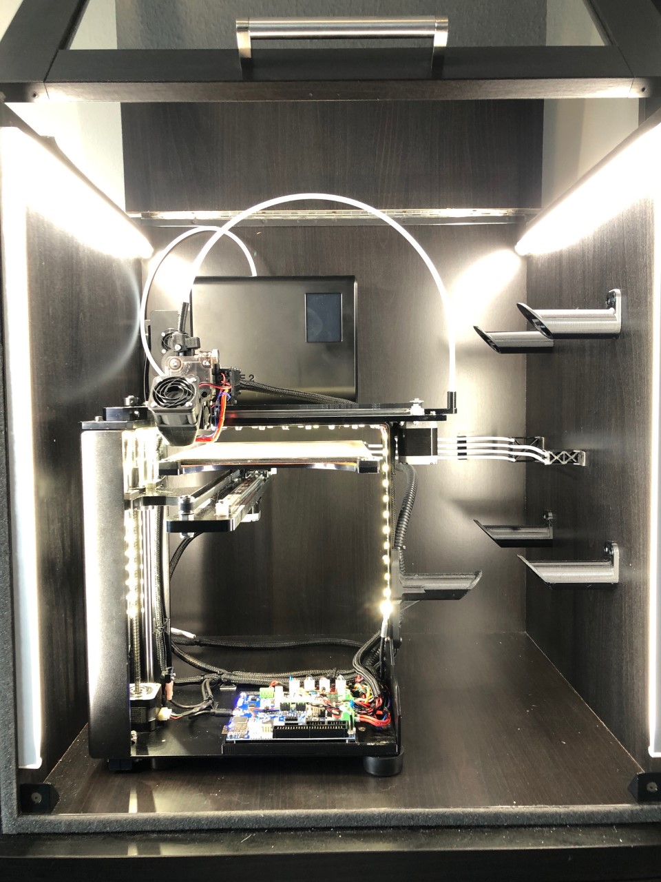

Jeremy had replaced his board due to failure and he said the Duet made for almost silent printing and the hole sizes seemed to be closer to being accurate. There was NO really good reason to do this. The board is more than the stock printer needs, but if I want to add a Z prob or other modifications, the board can handle it and the firmware is all Gcode so nothing to compile just add/modify config file and restart board.
It is a network board so if you don't use octoprint, it has its own gui built in. To be honest, I probably should have bought a Prusa mini rather than this board, it would have been more useful in the long run, however I have no room for a second printer so I opted for a silent printer. :D
The biggest pain in the butt was the couple of connectors that need to be replaced on the stock wiring harness and finding the proper crimpers..
When I get time I will do a summary of thing you need to do, all the details are very well documented, one just has to take the time to read them all and not be impatient like me :oops:
I attached a couple images of the finished enclosure. The small 5v fan in front runs all the time and the top 24v fan runs as it does with the stock stetup. I did change the temp it comes on to 60C from 50C so it does not run constantly when my enclosure is at 50C
Edit:
Now I think about it, I will change that back to 50C, I fire up the heat and let it sit for 30 minutes or more before I start printing, should have the fan cooling the board..
But behold, just click the config within the web gui which puts you in and editor, change the number, save, click yes to restart and your done.

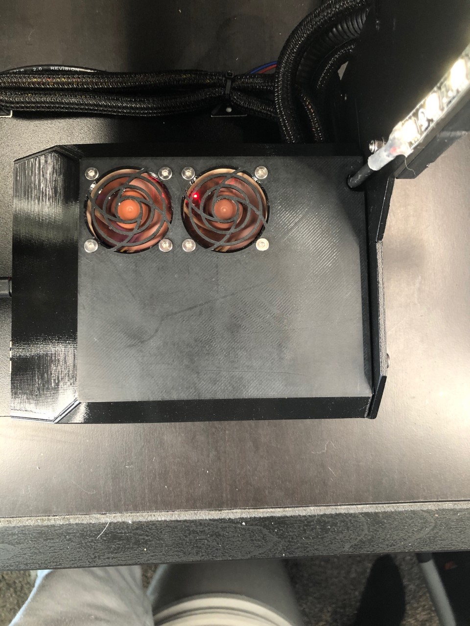

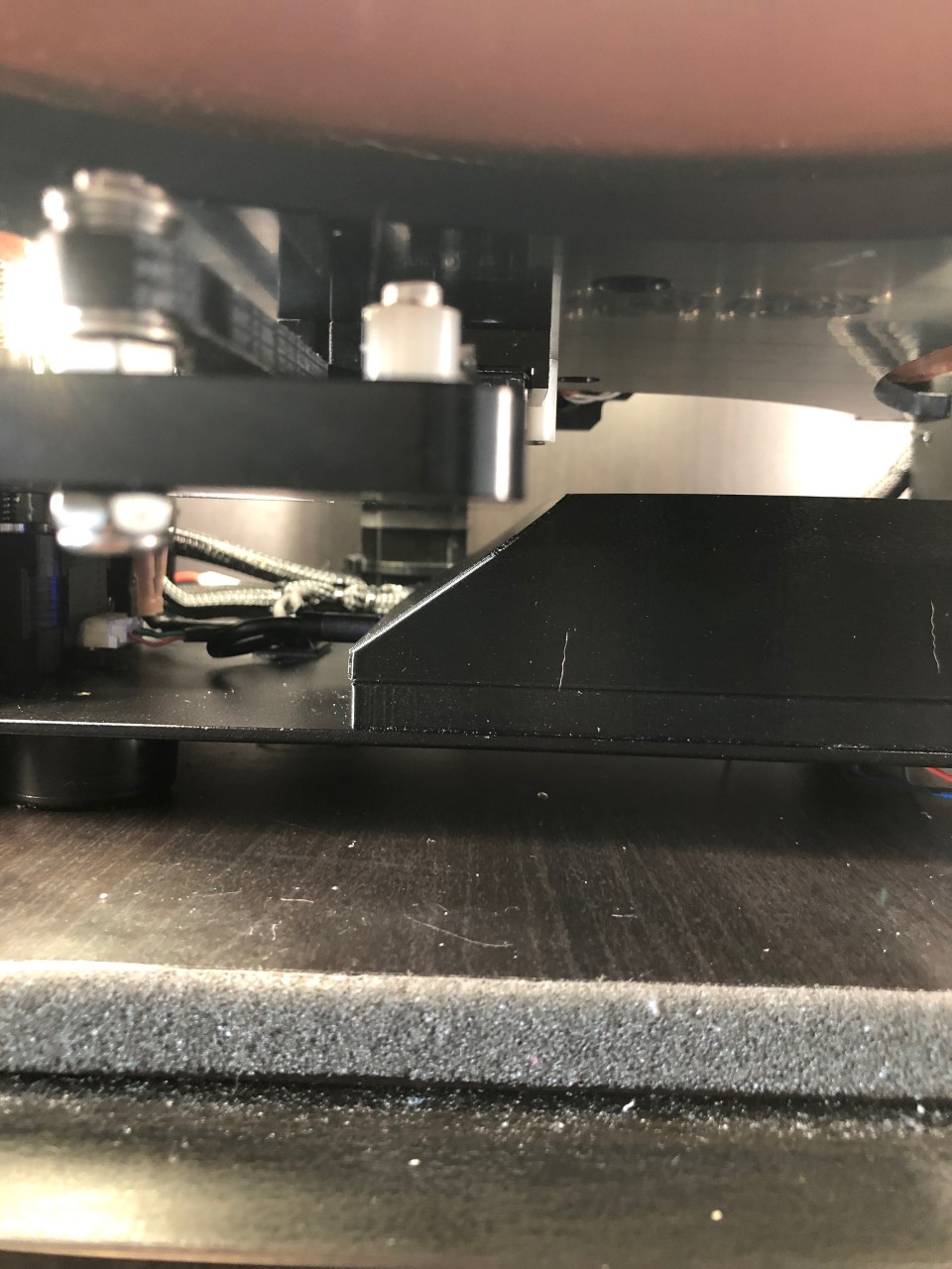

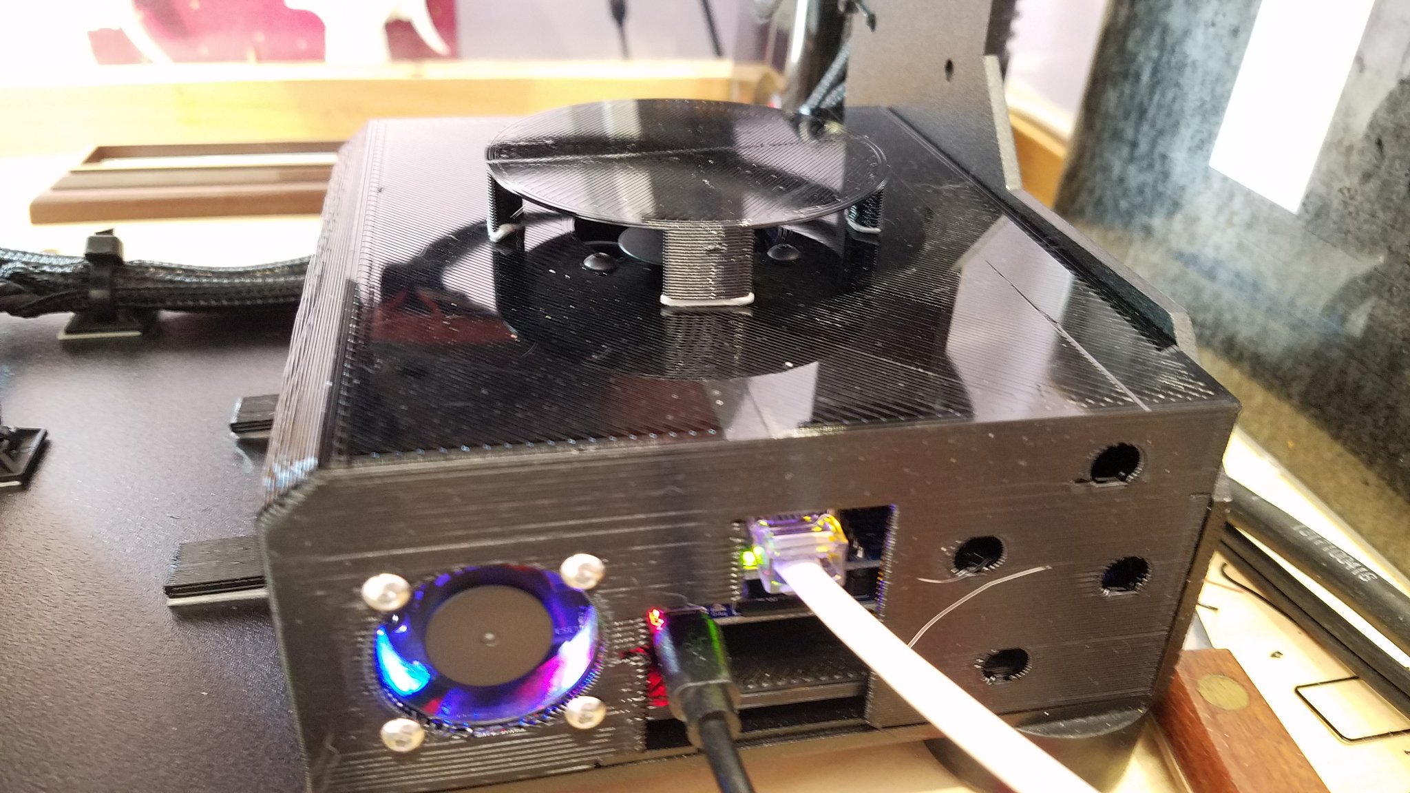

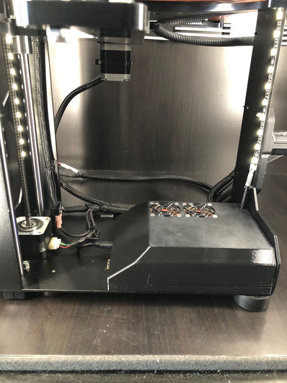

Finally got my Duet enclosure redesigned, but now with the Panel Due as a separate unit. The Y axis rail support BARELY clears the case.... Air is drawn in by the 2 top fans and blown at the stepper drivers, and then the air enters a channel under the board on the front end of the enclosure before exiting out the rear
