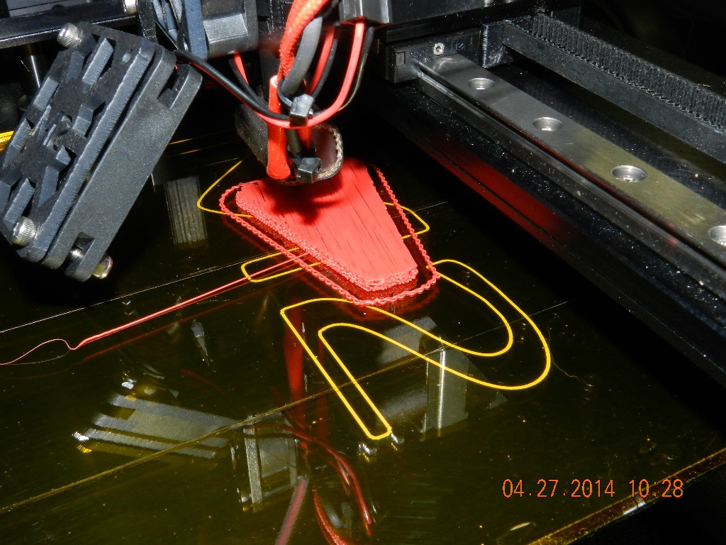

Curly Qs in the skirt, laid out before the raft?
This does not look like that when I print in PLA.
Raised the setting to 260 to get the ABS to stick to the bed Kapton tape:

Post by jsc » Sun Apr 27, 2014 4:14 pm
Check your z-height, it looks high to me.
Try clicking the z-stop end knob clockwise one or two clicks while the skirt is going down to see if that helps get rid of the little loops. If that works, adjust your bed height closer to the nozzle.

i dont use rafts but just looking at the skirt it looks like your printing really far away from the bed. even if it comes out of the nozzle all curly you wont really see it much when printed because its being squished into place. if its too far off the bed then the extruded plastic just goes where it wants to.

Success 15 hours later! Blind alley was the set screw, I will be ordering a spare gear and extra set screw.
I use 24 pound paper, my business card a thick, using common item to measure is OK for some,
but I have calipers that read to .0000 and would have rather mic-ed the dimensions.
Raised the bed with the hard to get to magic set bolt with the jam nut a bit.
ABS bag clip printed like a charm:
