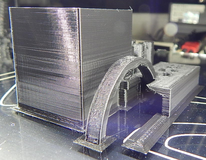

Ok, next time I run it I'll use supports. Since it was called a torture test I thought the bridge was supposed to work itself out. Aside from the "ringing" mentioned earlier on mine do you guys see anything else I need to touch up based on your more experienced eyes?

well the thing that jumps out at me is your top surfaces. see how they have holes. that is a very common thing when you have low infill. there are a few things you can do. #1 increase the # of top layers, #2 lower your printing temp and #3 in your infill section uncheck the box that says "random infill placement".

jsc wrote:Taking a closer look at the model, I would like to point out that you would never ever try to print this "for real" without supports. The eave next to the arch is entirely unsupported, and is theoretically unprintable. That corner is floating in mid air, there is nothing to bridge to. The printer manages to make it come out okay in the end, at least viewed from the top, by laying down a curve of droopy filament in mid air and building on top of that, but that would never fly in a real part.
And, for completion, Jin is absolutely right. Here's one from last November with no support. You can see the stringing under the arch and the mess under the shelf (even though on top it looks OK).
