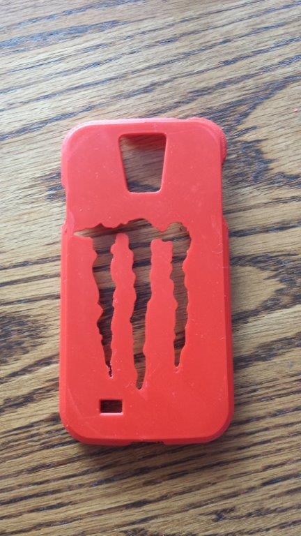

Last night I printed want I think is fake Ninjaflex it is Flex CyncronixPLA. I have V4 hot end on my printer.
I slowed down the printing as suggested and used the ABS temps.
It does not have enough stiffness to hold the Teflon tube up. Without the rigging it would just fall over.
I did a Temp rigging or something like that so it would feed. I primed with PLA then I had no feed issues at all. It fits the on the phone nicely
I use Teflon tubing is much better it very slick.
http://www.ebay.com/itm/331096770591
The white marks on the back are hair spray that I have now washed off. The first print I tried using Elmer’s glue but that did not work at all.

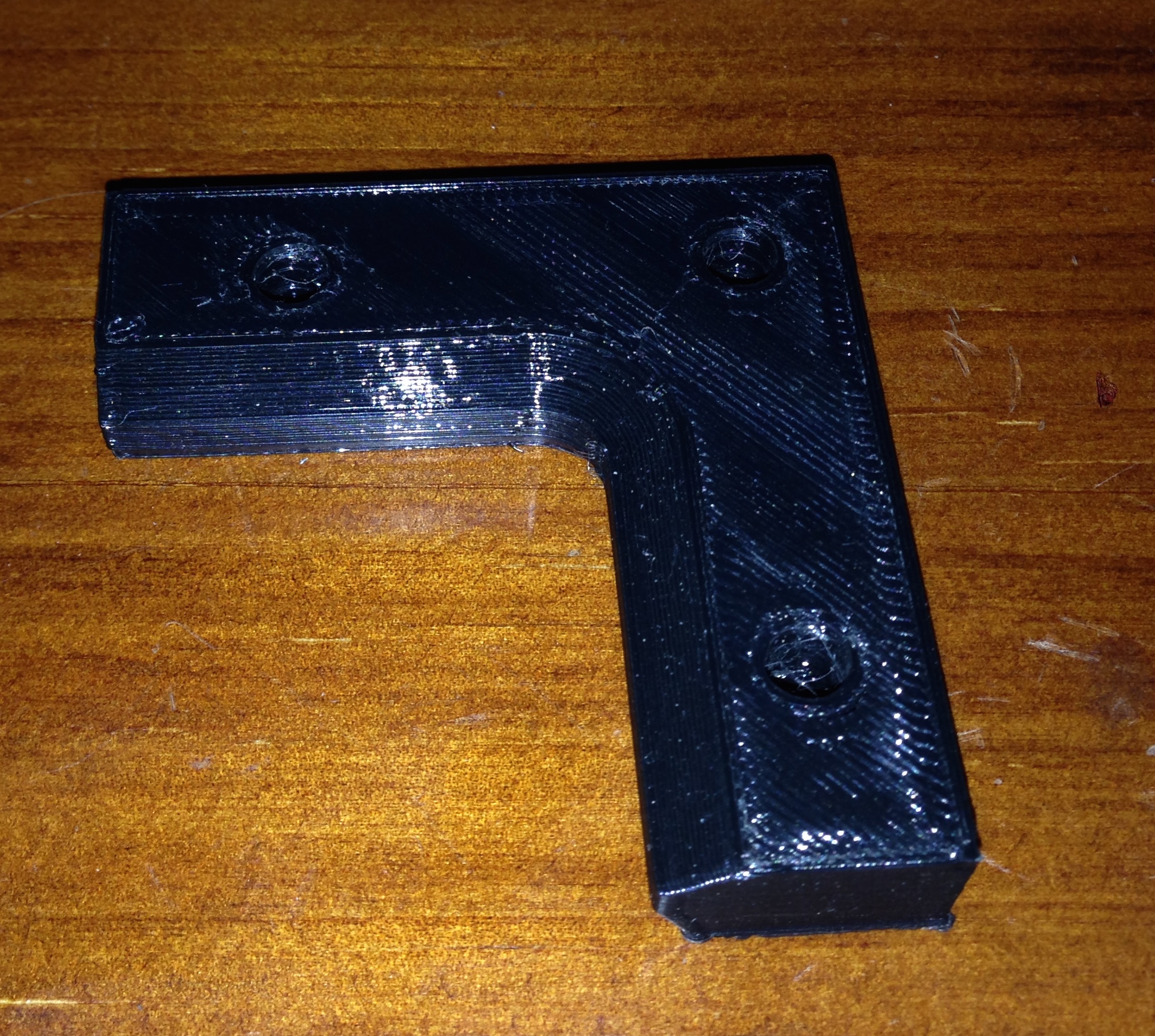

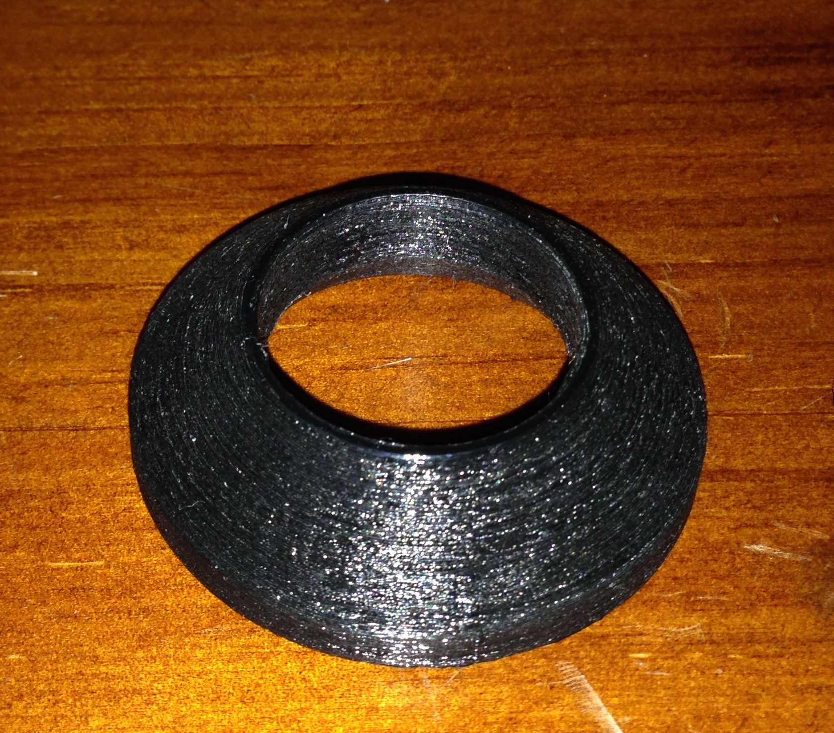

I have the V4 extruder and have found that NinjaFlex prints quite well on my M2. It is little ruff looking at times.
(1.48 MiB) Downloaded 618 times
(1.12 MiB) Downloaded 618 times
It was a little tricky feeding but just had to baby sit little closer. I have modified my FFF pretty much by reading what others have done and a little experiments as well and still tweaking as i go. I am glad that this forum is the best on the web. Currently running another part that looks a lot smoother.

anyone have any good retraction settings. Would like to clean up the part
Re: Ninjaflex seems to work in the V4!
Post by insta » Tue Feb 17, 2015 5:03 pm
Ronnien55 wrote:anyone have any good retraction settings. Would like to clean up the part
You gotta retract the bejesus out of NinjaFlex. Do like 6mm @ 60mm/sec, and 250mm/sec travel moves.
