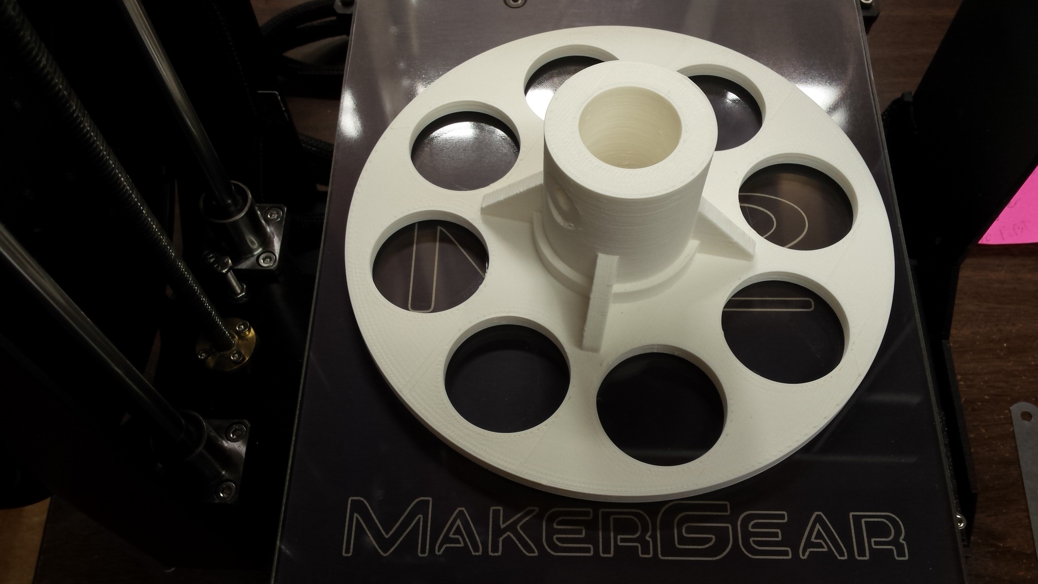

This part was printed using the .50mm nozzle
Material used was PLA
(530.82 KiB) Downloaded 274 times

Post by Dale Reed » Wed Jan 14, 2015 1:17 am
kentd,
Nice top layer! Which slicer did you use? I think more than one of us had struggled to get a top layer that smooth with S3D....
Dale

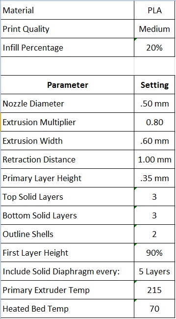

I am using S3D.
Here are the settings that I used:
