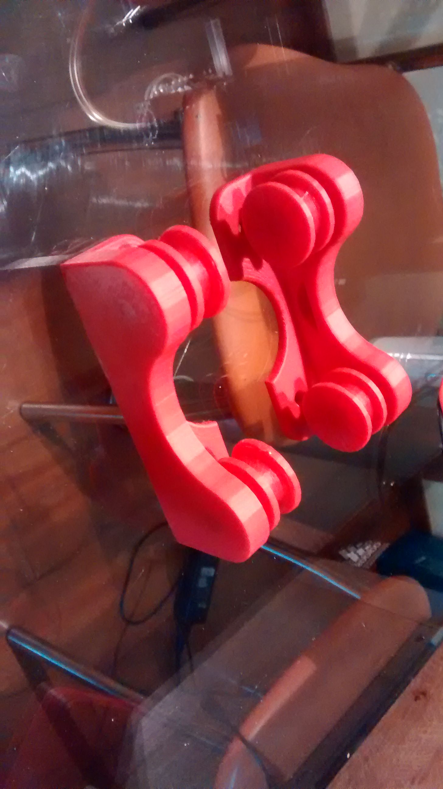

The only "detail" I'm trying to resolve is some loose threads on curvy perimeters, rounded edges, like the ones you see in the first picture. I guess I have some problem with the width or maybe I should add support for those parts? Any suggestion?

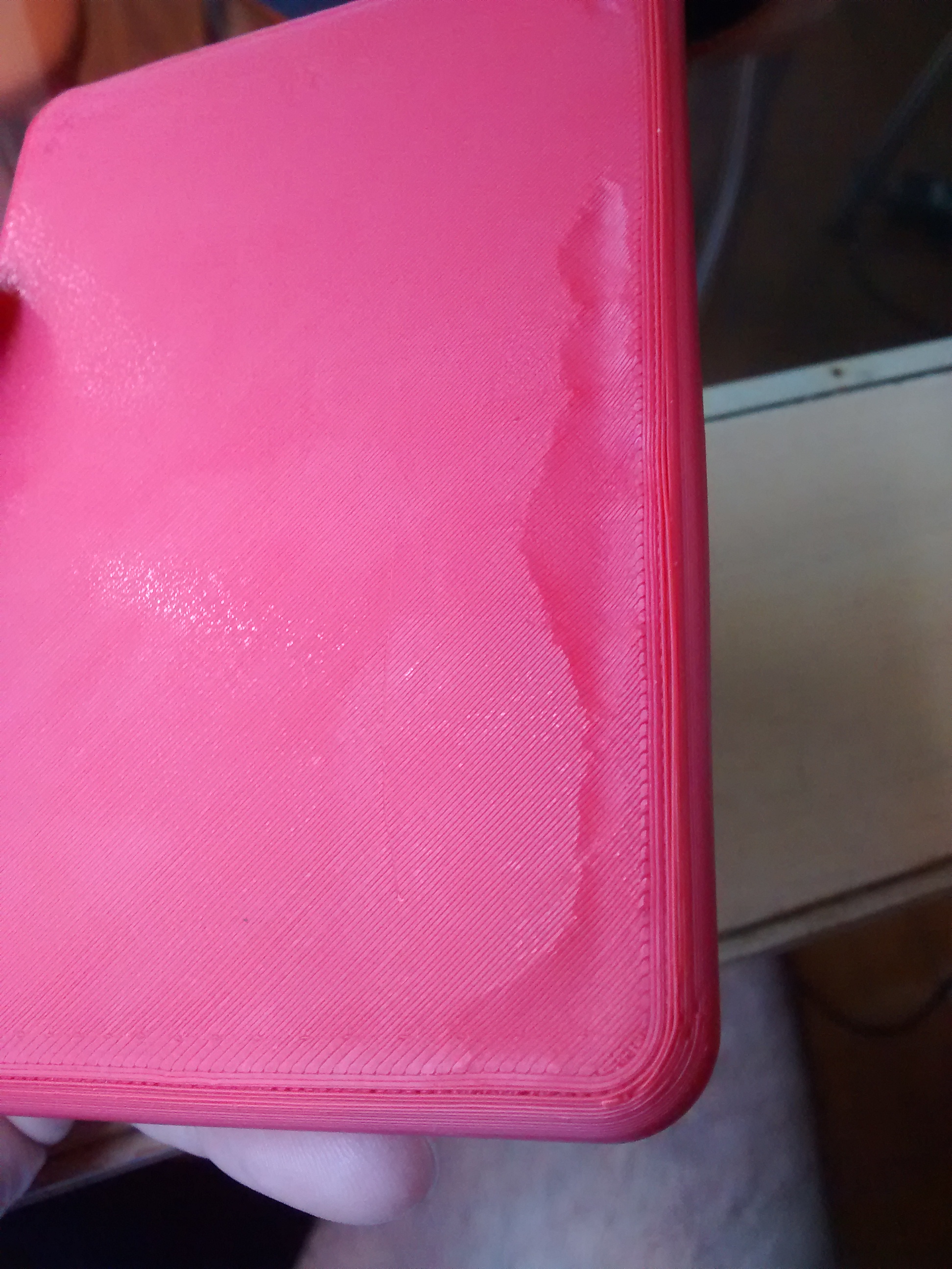

Another issue is the shrinkage the part suffered (that specifically) in some "zones". the part ended up weird... what could that be?

Chuckle! Yes, having the filament turn out to be ABS instead of PLA would make a rather huge difference as far as cooling and splitting goes!
Sometimes happens that you can get a spool that is mislabeled, and the only way to tell is by the smell. (ABS smells like burning plastic when it prints, PLA doesn't have a smell.)
I've never printed ABS, but some of the other guys here can take a look at your prints and give you some specific suggestions.
Just a few general ones that might help:
1. Your threads look fine overall but there's a spot there where they didn't stick. Clean the plate really thoroughly with a de-greaser soap followed by vinegar or alcohol. Then refresh the hairspray adhesive all over the plate.
2. It's very hard to print rounded edges on the underside of a print. That's just the nature of 3D printing. If you can re-design the file to have a flat bottom that contacts the plate all around, you will have better results. (Or you can print with Support, but the finish is usually not very nice.) A chamfer is better than rounding, if you absolutely have to have it slope there.
3. Rounded bottom edges make it more likely that the print is going to warp up at corners while the piece is printing (with either ABS or PLA). The bad thing is, warping at the lower edges causes splitting higher up in the print for ABS, so you've got to get that stuck down really well.
4. Remember that if you switch to printing PLA later, you should use some eSun Cleaning Filament to clean the ABS out of the nozzle first.
Other than that....you're in good shape, and you've had your first "Adventure in 3D Printing"!
