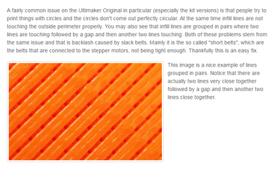

By the way, I found the following article on line:
the article comes from here: http://support.3dverkstan.se/article/23 ... ting-guide. Under the section titled "Circles not round / Lines not touching".

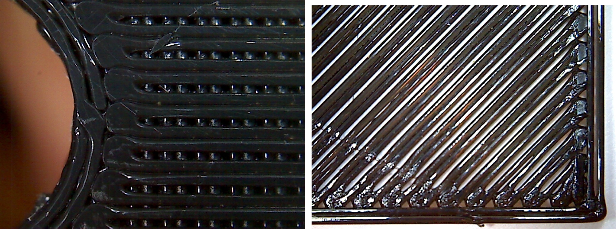

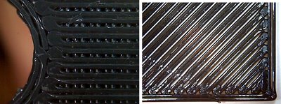

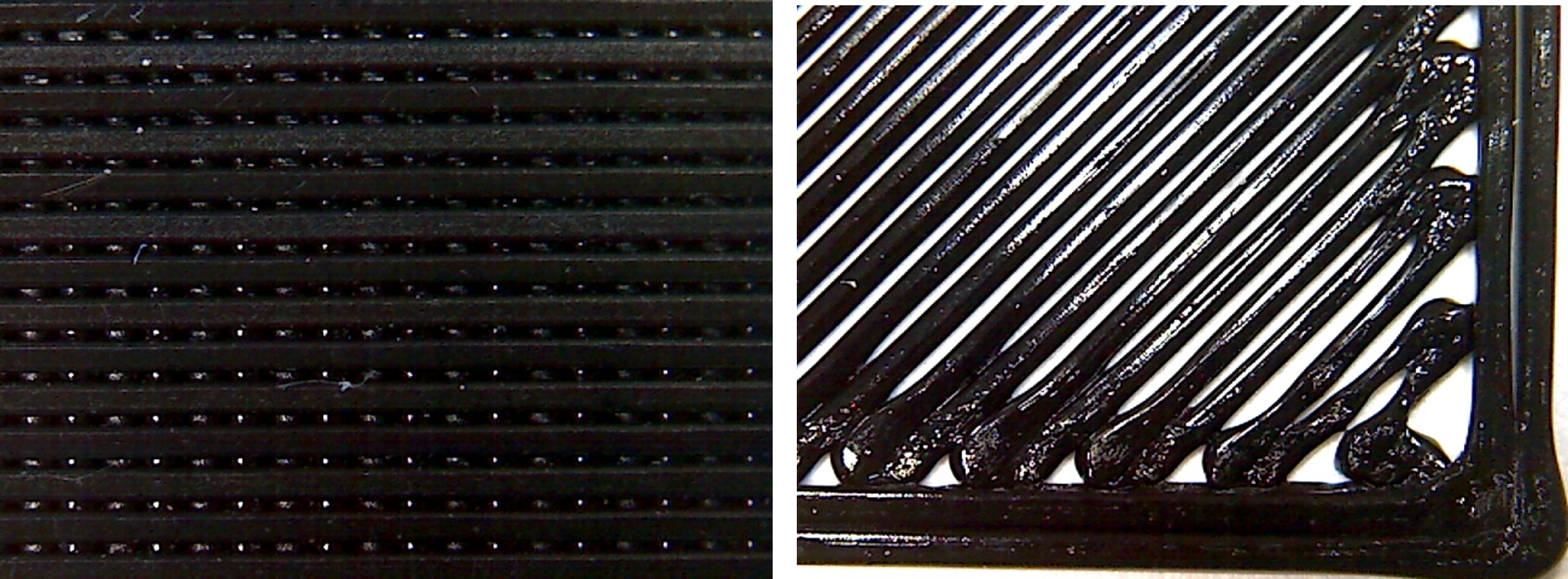

So here I am with a brand new printer and I couldn't be happier, base on my tests, the new printer seems to print perfectly fine (no apparent backlash). For reference, here is a picture of the old printer print pattern:
here is a picture of the new printer print pattern:
Both of these prints were printed with an initial z-gap higher than normal so that there is minimal plastic spread and you are able to clearly see the nozzle path on the first layer. From the images, you can see how the bad print groups the lines while the good print shows all lines evenly spaced. From this, I think it can be determined that there was definitely something wrong with the old printer and that the issue had nothing to do with initial z-height because if that would have been the case then both prints would have exhibit the exact same problem.
