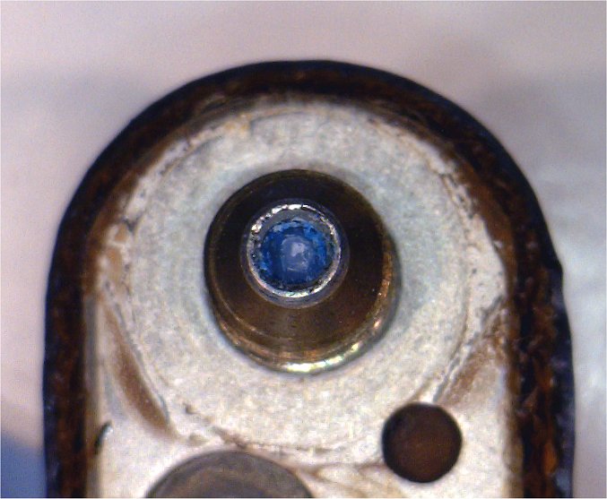

I didn't get a light under the first shot, but there is a clear hole going through. There's a small amount of baked on crud down inside that I'd like to get rid of before it flakes off & clogs the nozzle.

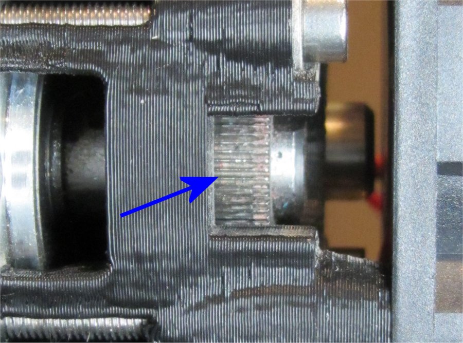

Well, I installed a whole brand new hotend & nozzle, and re-leveled the bed. Fired up a print job, and it stopped feeding filament within the first couple layers. The filament drive shaft was turning, but the bearing wasn't spinning. I tried increasing the tension, and that helped a little, and then it messed up again (and again, and again...). I looked carefully at the outside of the extruder, and there was no sign of cracks or anything. I did notice that by the time I was done, the gap in the filament drive for the tension adjustment was down close to zero.

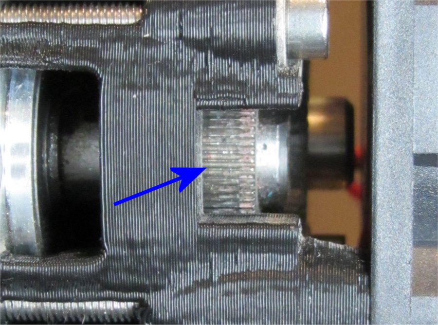

The only conclusion I could draw was that my extruder was dead somehow. I took it off the printed drive housing, and spotted something interesting:
The filament was apparently flexing enough to run off the front end of the drive gear. As I cranked up the drive tension, the offset tensioner design is such that it flexed, so the bearing ended up at an angle, which pushes the filament towards the front of the gear. It also looked like the gear was mounted a bit far back on the shaft, allowing the filament to flex enough to run off the end.

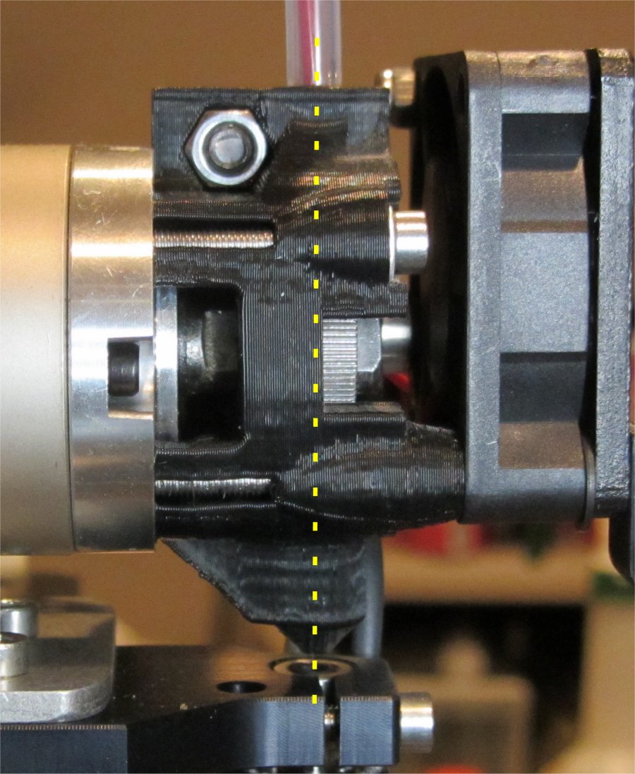

I moved the gear (which appeared to be quite secure, so I don't think it had slipped) forward on the shaft about 1 mm, which would put the filament about centered between the set screw and the front end of the gear. I should have taken a picture at that point, but I was impatient to see if this solved the problem. I backed way off on the tension screw and set it so it fed nicely and started a print job. Sure enough, two hours later, the print was just fine.
Here's what it looks like from the left side. You can see that the filament path is no where near the front edge of the gear now:
The printed drive piece didn't appear to be too badly worn, but I am going to replace it with a two-screw design to avoid this in the future. With the gear shifted forward, it's unlikely to recur, but the one-screw design is still going to have a tendency to twist the bearing & push the filament forward. I think the problem was initiated by the combination of the offset gear position and too much tension flexing things.

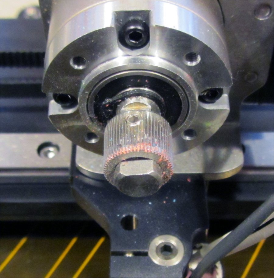

Here's what the drive gear looks like:
I tried to clean off the worst of the red dust from the end of the gear when it was too far back, but I don't know if the dust down in the teeth on the end are left over from that, or new. Also, the gear doesn't look especially sharp.
