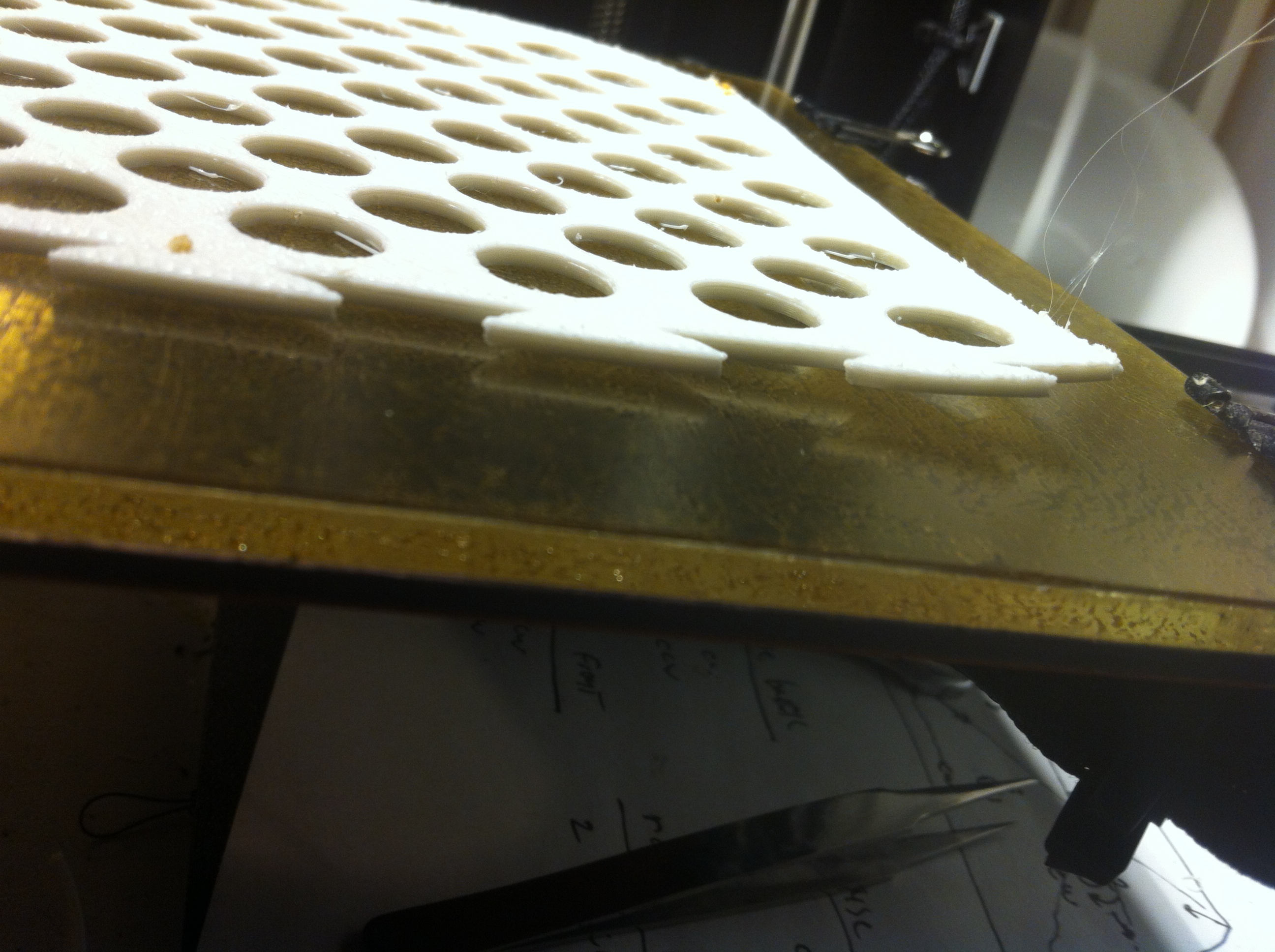

Re: PEI Bed Surface
I sanded it with 1200 grit and it did improve the hold, but it still warped and the same corner pulled off the plate after about 3 hours into the job. The first time it warped 2 hours into it and pulled loose in more areas, so I guess the next step is to keep decreasing the grit size until it can get all the way through the print. So I'll try 1000 grit next. I could see where it might be useful to have several different plates with different levels of sanding on each one to handle different prints. You could have one plate that isn't sanded at all for parts that don't warp and need to release easily. Then a plate with 1000 grit or less for real warp prone prints like this one I'm doing, and then something in between for parts with a lot of contact area that might be to hard to remove from the low grit plate.
This perforated tray half I'm testing with is a good warp test since it is thin wall tray where one side has no wall. Once the walls start getting printed is when the warp occurs. Having all the holes in the bottom also provides a good test for how even the surface is, since you get a dense pattern of circle outlines being printed across the majority of the platform surface. You can look at each circle to see if the bead is consistent in all areas. Low spots would result in the extrusion not sticking, while high spots would give you a flattened extrusion. I'm not seeing any issues with the surface not being level or having low/high spots though.
