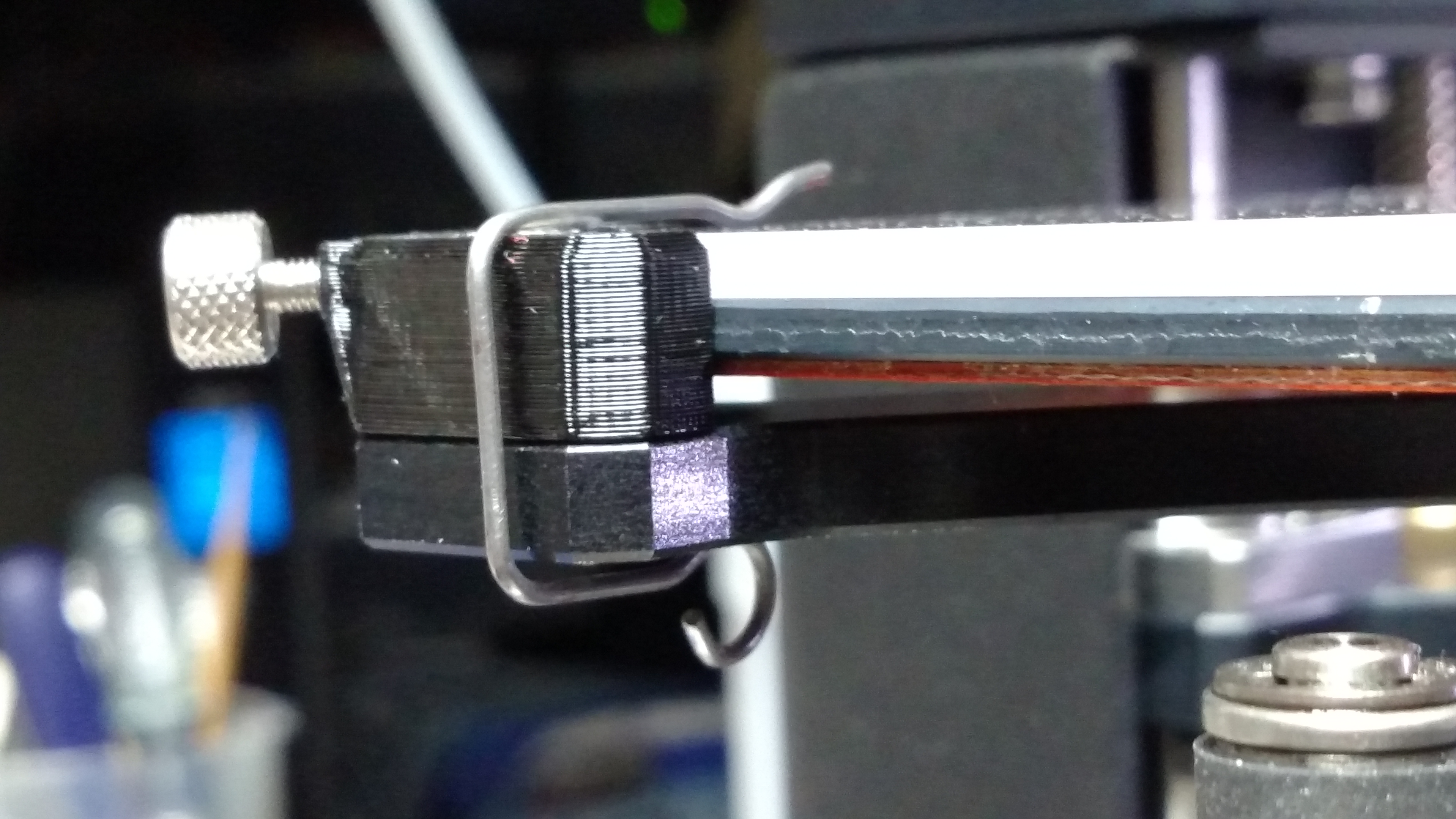

Got a week worth of playing around with the new system, very well though out, easy to install.
IMO the rubber corners are counter productive, it restricts downward movements of build plate during leveling, making it very difficule to get a accurate reading.
I'm using Jim's corners, adjusted till just shy of making full contact with glass and made some clips to keep glass down against the spider, allowing free movement during leveling.
Using a .008" shim to set nozzle height, .005" was way too close, will be ordering a .0075" to try and see if it's better.
