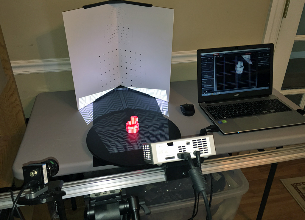

I'm very happy with my David SLS-2. Hard to beat for price, quality and performance. Once you get things figured out it's really not hard to use and you get excellent results. I looked at the NextEngine, they say $3k but that's not even close when you add in software and the other goodies you'd need.
It's not the factory SLS-2, I actually specked out my own system. I bought the David 4 software, their calibration panels, purchased the same projector they use K132, bought my own industrial CCD camera ( pretty much the same one they use), used a v-slot linear rail and 3D printed my own adjustable projector and camera mounts. I also bought a new Windows laptop just for the scanner. All in for $2100.00

Send David an email and or post on their FB page. Took me a couple tries to get my membership validated. I almost ordered the full SLS-2 and that's what I really wanted to do but given I also needed a laptop it drove it over my budget so I decided to go the DIY route and come as close to the SLS-2 box set as I could which actually worked out pretty nice.
The one disadvantage I can see is David has done some kind of mod to the K132 so it will focus closer than a stock K132. Not a huge deal unless you want to scan really small items such as coins. You can open up the K132 and remove an end stop screw that will allow you to get very close to the focus range of their K132.
The NextEngine does come with software but if you want the high-res version it cost's another grand. The turn table yet another grand. Honestly I think structured light is the way to go... at least for me.
