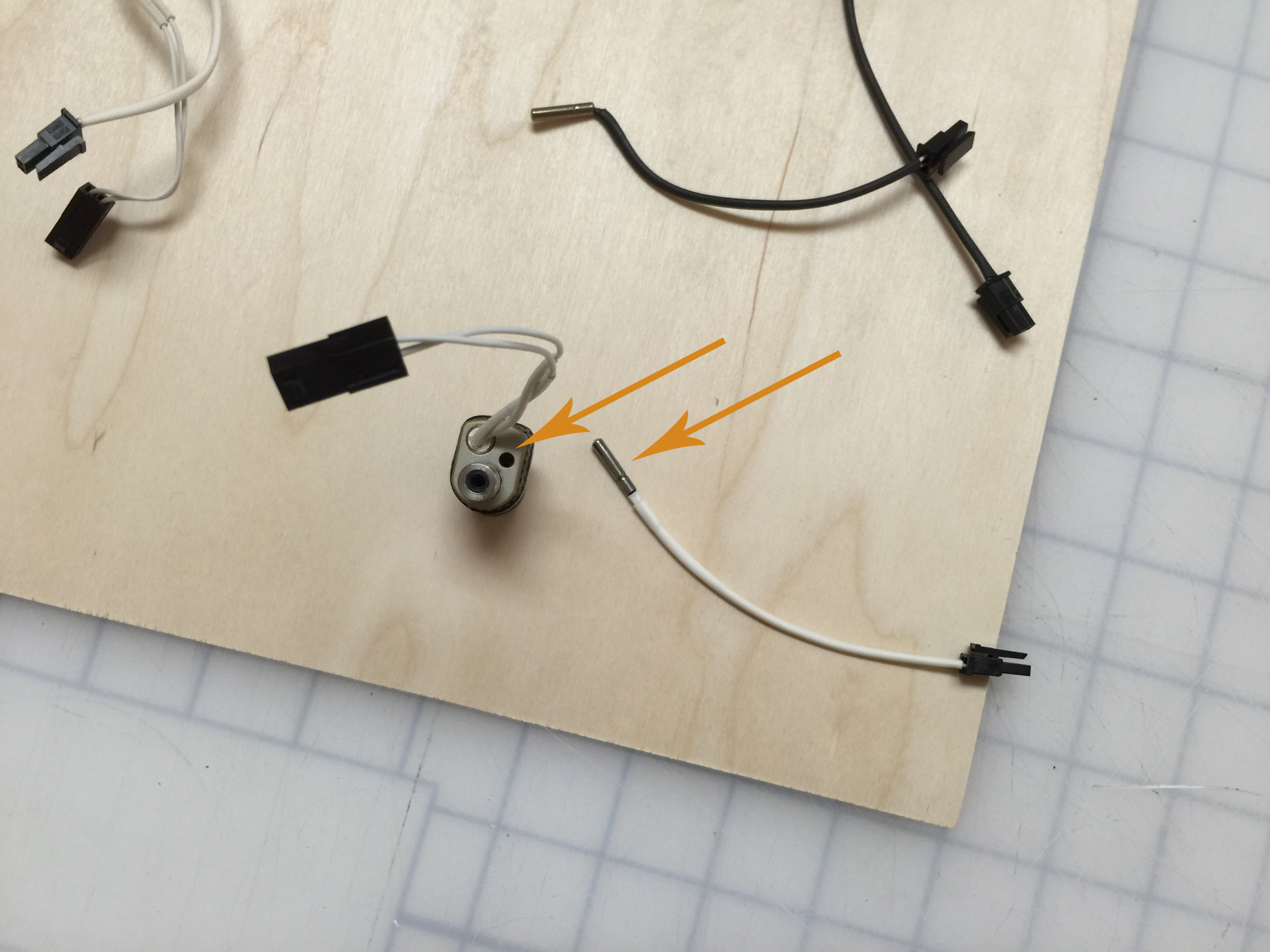

Think my V4 hot-end was fried anyway, but I got to the step "Remove the black cloth cover. Take the removable thermistor out of the hot-end and set it aside."
Well, I lightly tugged on each set of wires, and nothing moved. First off, not sure which set of wires are attached to the thermistor, but unless there's a special way of getting it to slide out of the hot-end that I don't know about, I'm going to guess mine was baked into the hot-end somehow and was not going anywhere. Anyway, wanted to ask what I did wrong, and what to look for in the future.
I get the impression that there will be additional extruder jams in my future, so thought I'd ask before I ruin more of these $75 parts.

You haven't ruined the part, but sometimes the thermistor is wedged in there fairly tightly.ajmadison wrote: I get the impression that there will be additional extruder jams in my future, so thought I'd ask before I ruin more of these $75 parts.
This is the thermistor:
You do not actually have to remove the thermistor to take the nozzle off. Or you can try poking it through carefully with a awl from the other side, there is a little hole underneath it.
Just remove the nozzle.

THE NEWER V4S USE SET SCREWS ON THE THERMISTORS HOLY CRAP DONT JUST YANK THE THING OUT

Thanks insta.
My eyesight isn't what it once was. I saw the holes, but now I know what's in them. And no worries, no yanking.

Wow.....that's embarrassing! Totally correct and i never noticed it - the one spare hot end that I took off of the Rev.E does have set screws in it! (The older ones don't.)insta wrote:THE NEWER V4S USE SET SCREWS ON THE THERMISTORS HOLY CRAP DONT JUST YANK THE THING OUT![]()
I need to go update that write-up. There's wedged, and then there's set screws.......
