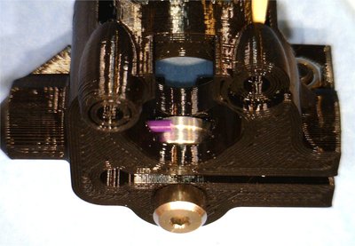

I machined an aluminum grooved sleeve using the drawing I posted earlier.

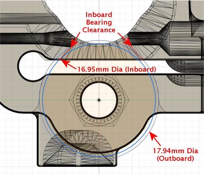

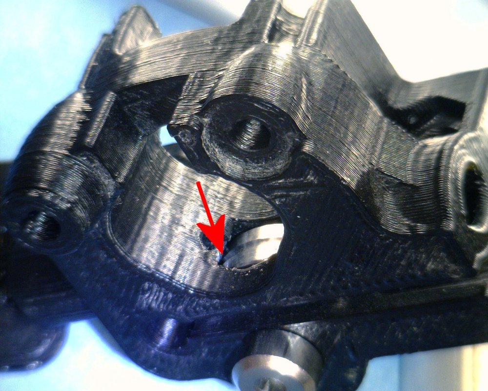

It pressed onto the bearing very nicely, but when I installed it in my worn out factory housing, it wouldn't turn. I recently converted the factory SLT into a Fusion 360 solid model, and when I checked it, I discovered a gotcha. The clearance around the bearing in MOST places is 18 mm in diameter, but at the bottom of the cutout on the "inboard" side, it is down to just under 17 mm, which is the diameter of my sleeve.

You need a little extra clearance to allow the bearing to squeeze the filament, so I don't think you can use this approach with the factory drive housing. You would have to reduce the OD of the sleeve, which would probably reduce the depth of the groove too much.
You might be able to get into the appropriate spot with a needle file to clear out the interference, but it's in a very awkward location. It's probably easier just to print a drive with proper clearance. I have been planning on using sthone's hinged design anyway, so modifying the clearance there (if it needs it) will be fairly straightforward.

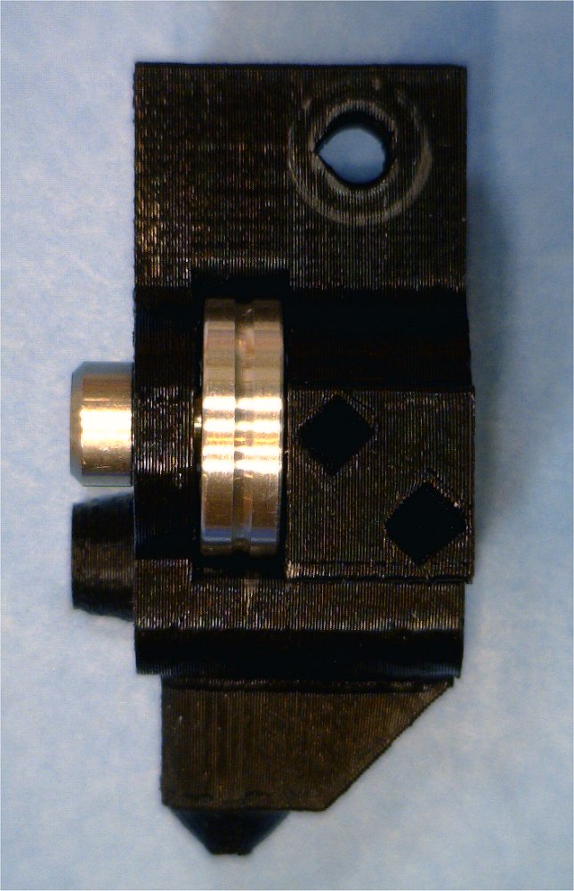

I've modified the factory drive model to give the added clearance required for the grooved sleeved bearing, and printed one up in PETG. The sleeve & bearing combo now spins freely until you really crank on the tension screw, far more than normal.
The next time I change filament, I'll swap this drive in. I don't expect it to make any noticeable difference immediately, but with normal filament, the drive should last much longer by keeping the filament confined to a straighter path. I don't have any plans to work with more flexible stuff any time soon, but it should help a lot with that as well. Here's a photo of the new drive with the sleeve/bearing installed:
It was hard to get a clear photo with good contrast between between the black PETG and the shiny aluminum sleeve. I put a short scrap of filament in so you can see how it lines up with the groove in the sleeve.

Quick update: I installed the filament drive with the grooved sleeve today when it was time to install a new roll of filament. I've been slowly using up a spool of PETG on various small prototypes, and have been tied up a lot on the CAD end of things, which is why it's taken so long.
The drive installed normally, and I got the roller pressure making nice gear grooves in the PLA I'm running now. Basically, swapping it in was a non-event (so far).
