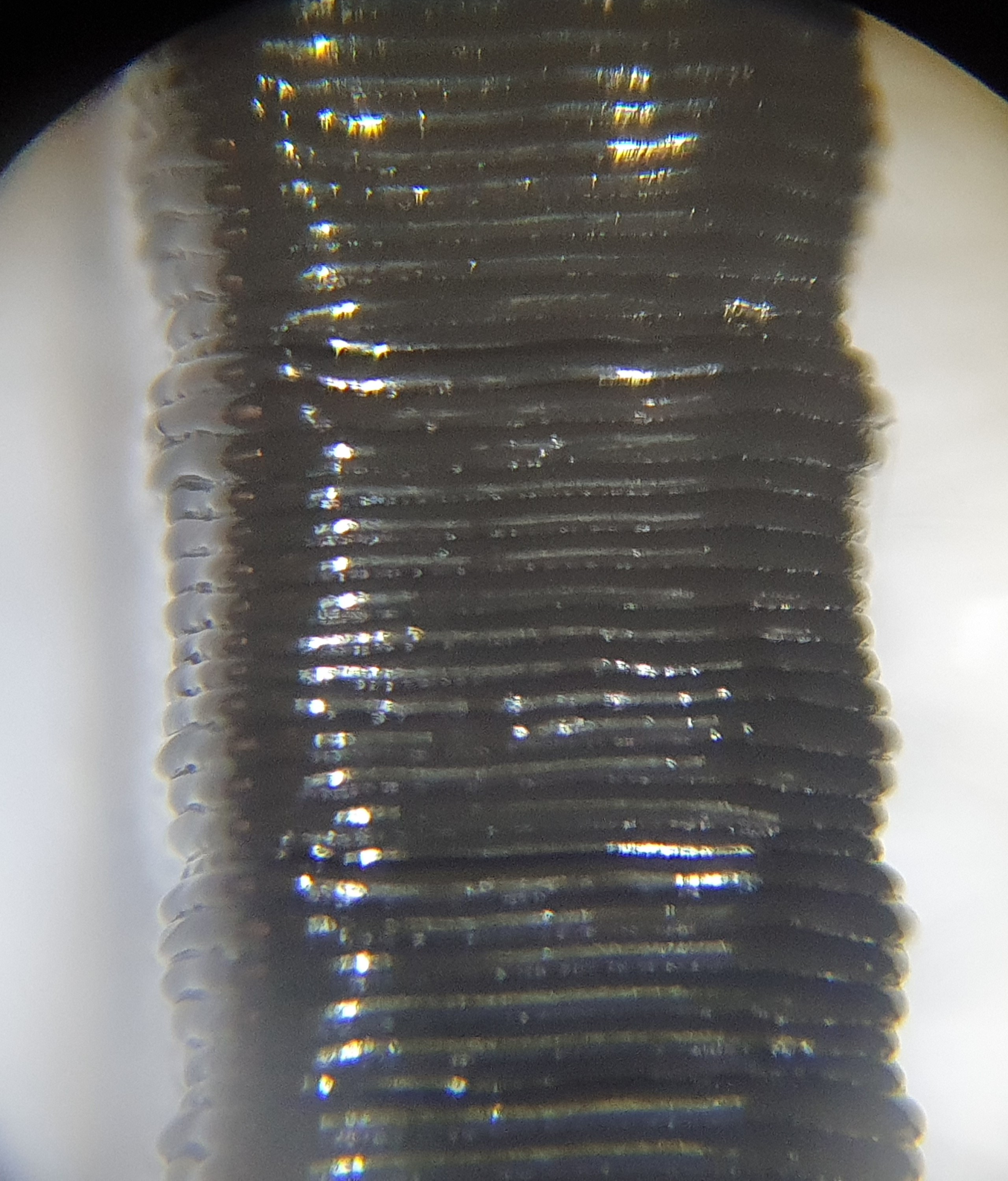

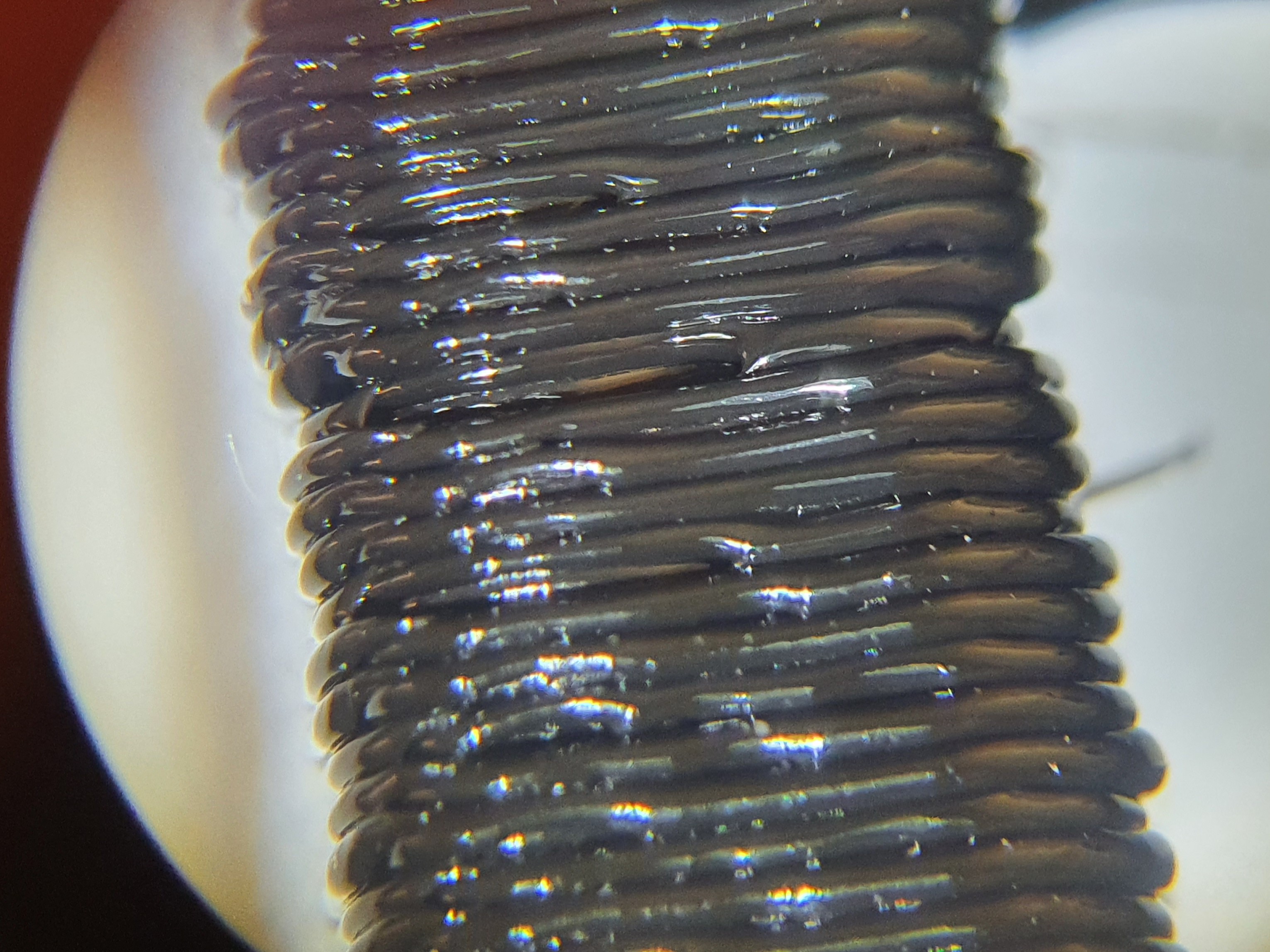

It's been a long time since I've posted here, but my trusty M2 (1. gen) is still with me. I've taken up a project that requires some level of accuracy, but something is amiss. My extrusions are really uneven. I'm attaching photos of a couple of prints as they look under a 20x microscope. Those walls are supposed to be straight, tapering off slightly with height. My printed walls are wavy.
It's not some sort of z-wobble, because the layers that stick out are wider at both ends. So I'm thinking this has to do with the extruder.
I think the extruder set screw has got loose the last few times I dismantled it. But could a loose extruder set screw account for this sort of unevenness?
I'm happy to hear any other hypothesis before I start dismantling stuff.
I'm slicing with PrusaSlicer, and printing via octoprint. Both were recently updated.
0.25mm layer height
0.2mm layer height

Glass bed loose? Jerk wrong due to fat finger when setting Z offset?

Possibly the set screws on the motor pulley are loose. I had a similar look on one of my printers and I traced it to the gears on the motor.
