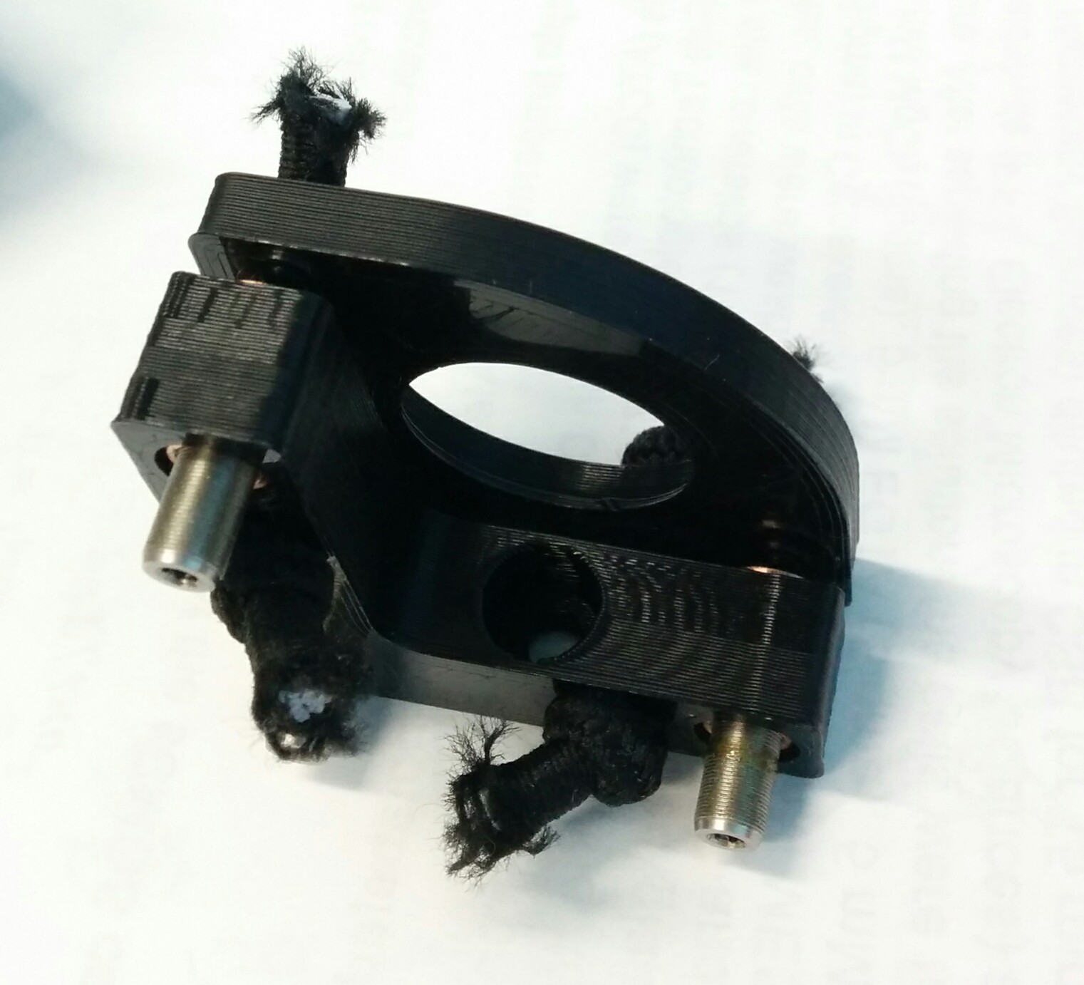

A test print to see whether I can make usable optomechanics - looking very promising thus far ...

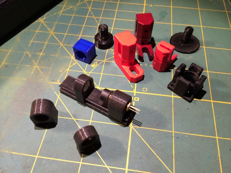

First pic you can see some flexure mounts that I machined (red) and printed. (upper right three) and some little optics test parts.

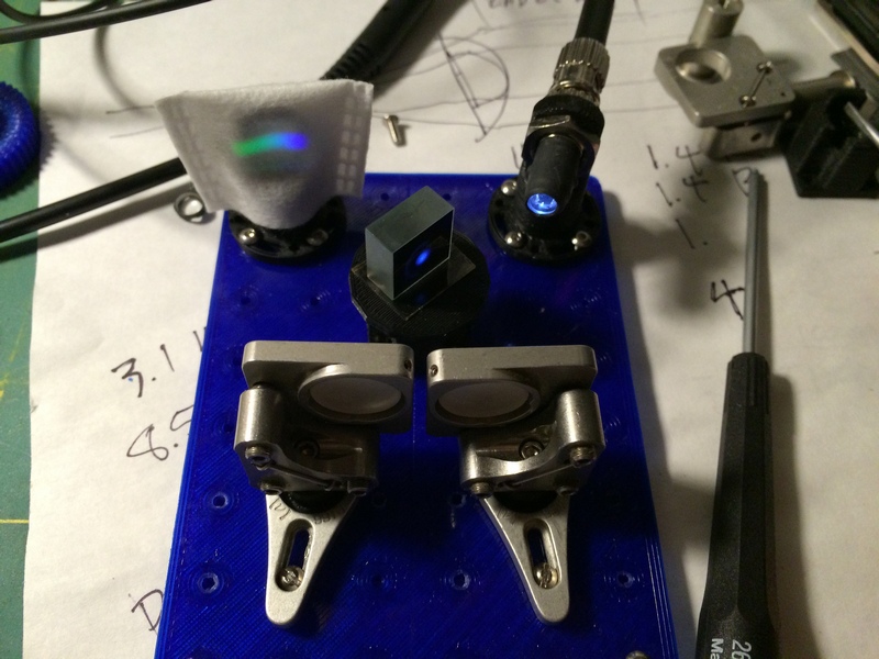

Next is test rig for a scanning Grating spectrometer. Needed some odd parts, could machine them, printed them instead.. Worked great!
