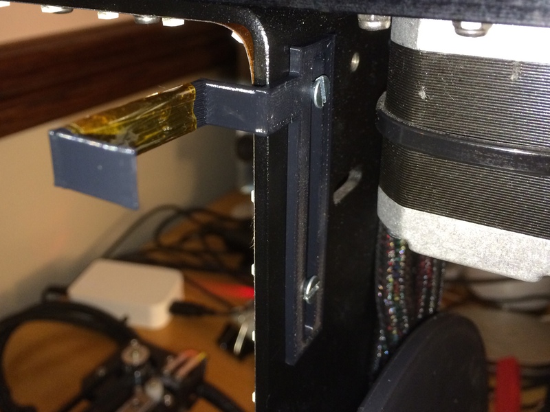

Post by jsc » Thu Aug 07, 2014 3:53 am
Here's my first attempt at a tool change wiper. It's just a bar that hangs off the right side, covered in some kapton tape to make it easier to clean off. The tool change script retracts the old tool 6mm, switches to the new head, moves it just past the wiper, extrudes 6mm to get back to zero, and moves over the wiper at a moderate speed to wipe off any residue. It is adjusted to barely contact the nozzles as the pass over. Here is my tool change code:

Here's my wiper model. After some more playing around with it, I'm not sure it's going to work out, though. I mean, it's better than nothing, but what happens is that the wipes build up after a while and then one of the nozzles will pick up the patch and bring it over to the print. You have to be cleaning it up constantly. I'm going to try Cura next, which I've read has "wipe tower" support (it will automatically build a tower to wipe the nozzles on).
What you want is some sort of brush, which will clean and retain the ooze.
Also, as I mentioned, the next problem is that even an aggressively deprimed nozzle will ooze a small amount if left unused too long, and that tiny filament blob will end up somewhere on your model. Hopefully in the interior, but if the print is small, probably on the outside. I tried cooling down the unused extruder to 190 as suggested in the wiki, which does improve matters, but that blows up the printing time with all the waiting to bring up the new tool up to temperature.
Still, please play with it and see if you see any improvements to the procedure! Oh, use M4 sized hardware; #6 is the closest SAE equivalent.

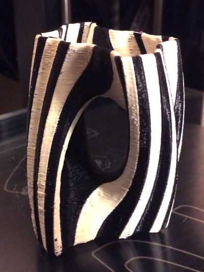

First Cura test
Post by jsc » Fri Aug 08, 2014 3:59 am

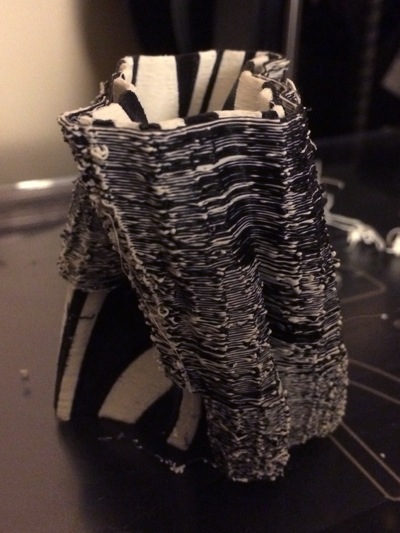

Cura's dual extruder support is good, better than Simplify3D. I ran the Julia vase at half scale as a test. The wipe tower got knocked over about 3/4 of the way through, causing a spaghetti mess, but the ooze shield kept it away from the model.
Getting the ooze shield off was a bit tricky. Kind of like trying to get the meat out of a crab, if the crab had holes that the shell was threaded through. Here's a photo a little way into starting the removal:
julia vase.jpg (69.66 KiB) Viewed 22876 times
And here it is after complete deshielding:
julia vase 2.jpg (71.96 KiB) Viewed 22876 times
