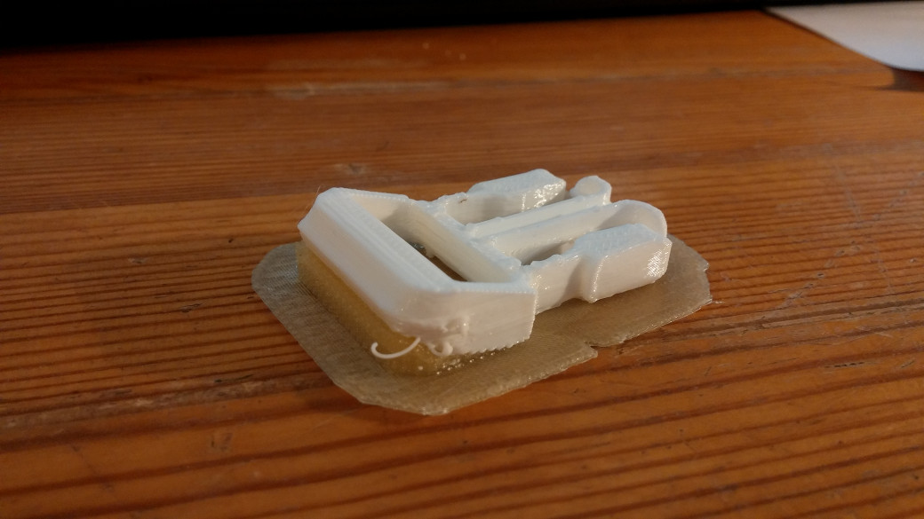

A major motivation for me to try dual printing was using soluble support material.
So I ordered a spool of PVA which is soluble in water.
I printed this male side release buckle using PLA as main material and PVA for support and raft.
I used the right extruder (all metal) for the PVA and blue painter's tape on the glass.
The print does not look perfect - but the issue is related to PLA only (my Cura settings for PLA were not right and bad PLA quality).
Actually, the PVA part turned out to be very nice.

So how does it look after dissolving the PVA? How long did it take to dissolve?
dryeti
Posts: 23
Joined: Wed Apr 16, 2014 10:22 am
Re: Going soluble - printing PVA
Post by dryeti » Sun Sep 21, 2014 12:00 pm
Q*bert wrote:So how does it look after dissolving the PVA? How long did it take to dissolve?
The bottom layer (where it stuck to the raft) looks just like a top layer. I let it dissolve overnight. Most of the PVA was still there
but it was quite pulpy so you can easily remove it.
