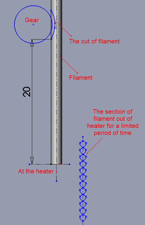

Post by lycat2008 » Tue Sep 30, 2014 7:38 am
We remove the heater away the gear and let filament go through the slot by hand,that it can work fine.Then we assemble the heater on the gear,the filament can be out of heater for a limited period of time,with a rough draw showing the cut of filament and fuse filament section,see the picture.
the cut.jpg (61.21 KiB) Viewed 13242 times

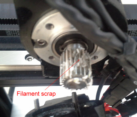

Post by lycat2008 » Tue Sep 30, 2014 7:42 am
the scrap.jpg (34.03 KiB) Viewed 13241 times
Re: M2 gear cutting filament
Post by jimc » Tue Sep 30, 2014 12:49 pm
ok so the filament isnt actually breaking, the gear is stripping out on the filament. this happens for a few reasons. one can be the temp is too low. a second is that the extruder is clogged or getting tight. the extruder can get tight or clogged from poor filament or switching plastic types often. in any case, unless its temp related then its probably time to do a hot end cleaning.
