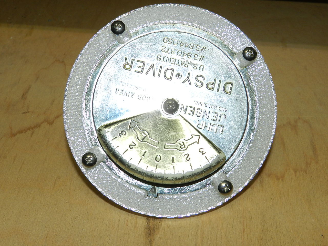

Learned a parts made from PET+ have little, to no shrinkage.
ABS does have a 1 to 2% shrink factor, if you're trying to retrofit to another existing part.
Took 3 tries in S3D trial and error up-sizing to get my ABS diver rings to fit right.
Diver_ring 001.jpg (326.09 KiB) Viewed 6102 times
M2 made me some money today! Have these rings installed at my webstore
and sold a few that will grow into many as time marches forward. Home manufacturing
these rings is a great test marketing idea, that can be turned into an injection mold
if the demand it there.
jimc did the design work and nailed it on the first revision when I went
to moveable hold down tabs.
Object in the photo is a diving planer that takes your lure to depths of 110'
depending on how much line you let off the reel. Ring is the white part.

nice john! glad that all worked out. so the final ones are going to be abs or did you decide to go with pet? looks like clear pet in the pic.

The rings I'm test marketing are ABS.
Ring in the first pic is PET+.
If I ever make an injection mold for these rings, polypro would be the
likely material. Issue with the rings is over time all injection mold erode
slightly, in other words the original metalized/chromed diver part, made in the millions grows a very small amount.
Polypro would have a small amount of give/stretch to accommodate the diver part.

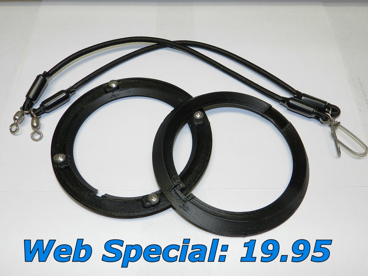

Here's the rings in black ABS:
Diver_ring_deal 002.jpg (256.63 KiB) Viewed 6093 times
Had to up-size the moveable tabs under the #6 stainless steel truss screws for ABS too.
Interesting on how different plastics react when the same .stl file is used. PET+ clear part was printed at 250C, bed temp 75C.
ABS was 245C, bed temp at 110C. Even thought the print temp was close, parts came out differently.
