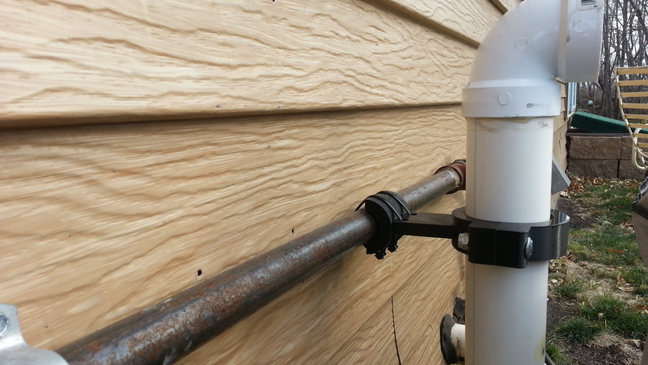

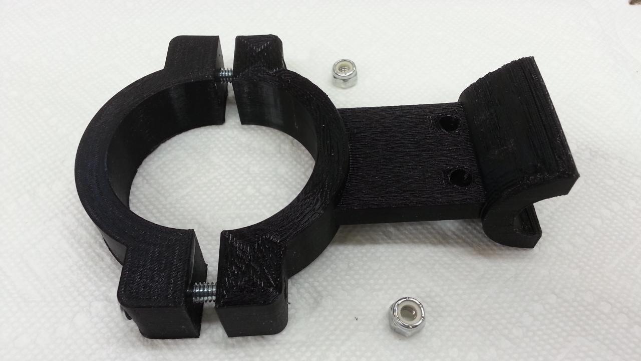

I needed a bracket to hold my furnace PVC exhaust pipe on the outside of the house..... so here is the bracket that I made on the M2 using PLA.
It is made to fit a 2 1/2" pipe on one end... and then it lays up against a 1 " pipe on the other end and gets tie strapped to the 1" pipe.

Nice job! I can see how the one semicircular part was printed (the shiny surface on top in the second picture gives it away). But the main shoe --- did that require some fair amount of support material? If so, you've done a masterful job of trimming it up. And if you've got several perimeters, which follow the curve of the pipe, this part will be very strong in just the right directions.
As you've obviously discovered, having an M2 makes creating custom parts for a job into a fun and rewarding experience, instead of hacksawing something together out of steel strap and angle iron and three trips to the home center and one to the pharmacy for bandages and disinfectant for the cuts from the sawed-off metal.

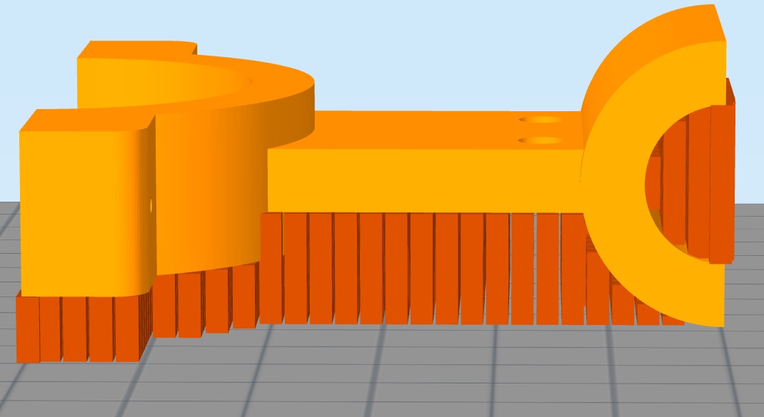

Yes, you are correct... this piece did require a lot of support material.
I also had the software create a raft under the whole piece to help hold all of my support material in place.
I ran this whole print with my cooling fan turned OFF.
I tried the print it with the fans on but the fans kept loosening up my support material.
I've actually found that I've had my best luck running the prints with the cooling fans turned OFF for the whole print.
Here is a screenshot showing the support material placement.

With PLA, you should (generally) keep the fan on in order to help cooling. Helps with exterior overhangs and reduces heat induced warping. If you're having trouble with support adhesion, you can start investigating which of several methods will become your favorite; see the "M2 tips" thread in the tips forum. They all have their partisans, I'm partial to glue stick. My experience was that my first few prints turned out great, then I started having first layer adhesion problems. The only cure is to keep the glass meticulously clean, or rely on chemical adhesives.
I've read that PLA isn't the most suitable material for outdoor use, although I've also read of some people's experience that contradicts that. It appears to have good UV resistance, but is sensitive to heat, so if it gets very warm where you are you may see it degrade over time. It is also considered biodegradable, although that is mainly in an industrial composting machine context.
One suggestion on designing for 3D printing: if you split your print into two parts so that the main beam inserted partially into a recess on the left clamp like a mortise and tenon, you could rotate the right part by 90 degrees on the X axis and print the whole thing almost entirely without supports. Saves on filament, and supported surfaces never come out as nice as the others. (You would solvent bond or glue the mortise into the tenon, like in joinery.) I've found that a .2mm clearance on all sides gives an easy fit, a .1mm clearance a very tight fit.

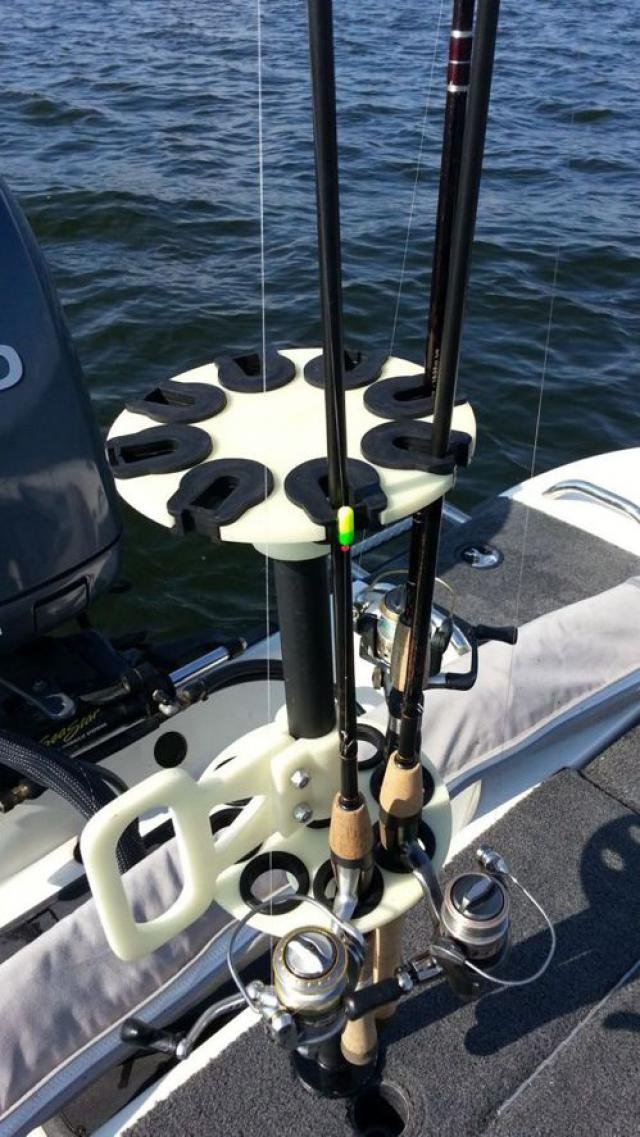

Here is a fishing rod holder I made using poured resin material.
I made my original parts on a 3d printer, and then made molds from those for reproducing the parts.
I used Smooth-on Task3 materials for these since it has to stand up in the hot sun and so far I haven't ran into problems with the parts sagging from the hot sun.
All of the rubber parts on the rod holder I made using an injection molder I have in my basement.
