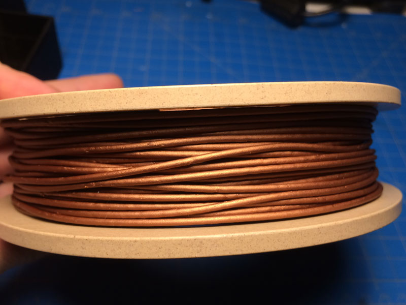

since i was placing an order with reprapper i decided to give their copper pla a shot. this is their copper version of bronzefill i guess. they just released this stuff a week ago. it looks very interesting on the spool. the extrusion is a little scary but from what i can see it doesnt look like there are any extruder jamming bumps. this stuff is loaded with copper. ill print something with this stuff first chance i get and post it up

Post by jimc » Wed Jan 21, 2015 5:30 am
here is a pic of the copper. you can see it has many little indents. it will be a little bit before i will have some free printer time to give this a go. there were a couple other people in a thread on another forum who got it as well. they havent mentioned difficulties......yet. time will tell i guess. maybe in a couple days when this spool of pet is empty ill give it a shot before i put on a new one.

Post by jsc » Wed Jan 21, 2015 5:45 am
Where's the pic, Jim?
Re: reprapper petg and copper pla
Post by jimc » Wed Jan 21, 2015 5:56 am
haha oh crap...i forgot to attach it.
here you go.
Post by insta » Wed Jan 21, 2015 3:56 pm
That stuff looks terrible :( Hopefully it print better. That's about how good the HDPE I extruded looked and I wouldn't dream of selling it to someone.

Post by jimc » Fri Jan 23, 2015 3:23 am
ok well i tried the copper. it looks real nice for the 2-3 min i can print with it before it jams. i went to another forum thread where another person ordered it same time as me and they posted a pic of their spool and the extrusion looks perfect. nothing like mine at all. i guess i just got a bad one. waiting for the factory rep to get back with me to see what they want to do. im pretty sire they will send me another one. as for the petg..its great. no issues and im on my second spool now. printer is running 24/7 with this stuff. took me a couple shots to fine tune the settings for it. it seems to have a very narrow margin where it prints correctly. pet seems to be like that in general but this stuff seems a little narrower. prints great though at a slightly lower temp. extrusion is perfect on it. i am running at 235 instead of 245 with the others.

just wanted to say that reprapper is sending me a new spool of copper. that one was definitely not right.
