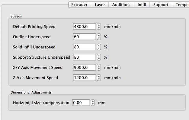

How can I reduce the acceleration rate in S3D? I'm having a similar problem and have seen that suggested here, but don't see that setting. Also, I've got several areas that I can configure a retraction. Where is the best place in the settings for changing retraction between layers?
Re: X direction shift during printing
Show Advanced > Other > Speeds (on the left)Katwitch wrote:How can I reduce the acceleration rate in S3D? I'm having a similar problem and have seen that suggested here, but don't see that setting. Also, I've got several areas that I can configure a retraction. Where is the best place in the settings for changing retraction between layers?
For the retraction:
Show Advanced > Extruder > Ooze Control
