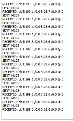

Hi,
Left working printer overnight and when I woke up this morning I found out that printer head is all the way to the left, bed is lowered and my prints are not finished (mat be 30%). I have started a fresh print and when it was readu to move to the right to ooze print head didn't move and I saw a lot of error messages in the log (Fix errors and M999 fo restart). I reset Rambo, started printing again, temp of bed and extruder went up, printer head moved for ooze but didn't ooze any filament, I did stop printing and was trying to extrude filament manually but extruder motor started to click and no filament showed up, I retracted filament and then I found out that extruder is not hot, although it shows 240 but it was not, I easily touched black part with fingers. And s#d show me temp around 240. I turned off printer, restarted a computer and it was showing 220C and still why I type this message it slowly going down, 198.6, 198.5, but sometimes i goes up again : 198.6, 199.0
I reset rambo already. what else can be done? right now hot end is ice cold

Checked all connection and wiring. Came back to 20° but when I turned on Hot-end heat temp jumped to 187 in couple seconds and back to 60, then again 180 and 70... Makergear sent me a new thermistor already.
I think it was bad from the beginning because I saw that every time Hot-end heats up temperature could go back couple degrees, for example it climbs and in about 220 it goes several degrees down, for example, 210.9, 211.5, 212.1, 212.1, 211.4, 210.3, 209.4, 208.6, 208.6, 209.8, 210.3 and so on.
