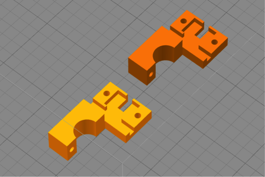

My new limit design uses a Sharp GP1S56TJ000F opto sensor, with a 2mm slot and a 0.15mm aperture. This should provide repeatable homing to within a couple of thousandths of an inch.
I printed a housing. The housing consists of two identical halves that capture the opto and provide an egress for the wiring... I tapped the holes in one half with 4-40 threads. II drilled the holes in the other half for clearance. It is designed to mount on the 10mm guide (in the same place as the snap switch)... In addition to the opto, you need a couple of extra components - a 200 ohm resistor to bias the IR emitter, and if you decide to invert the signal instead of modifying the firmware (which I did), you also need an NPN transistor (any general purpose transistor should do) with a 10k resistor on the base... This essentially inverts the switch logic to making it compatible with the current firmware settings.
The last thing you need to do is to replace the old limit adjustment bolt with a flag (thin metal strip) to trip the opto.
Here's a picture of the housing... By the way total cost for the modification was less than $2... Not bad for thousandths precision!
