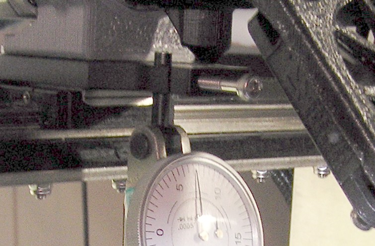

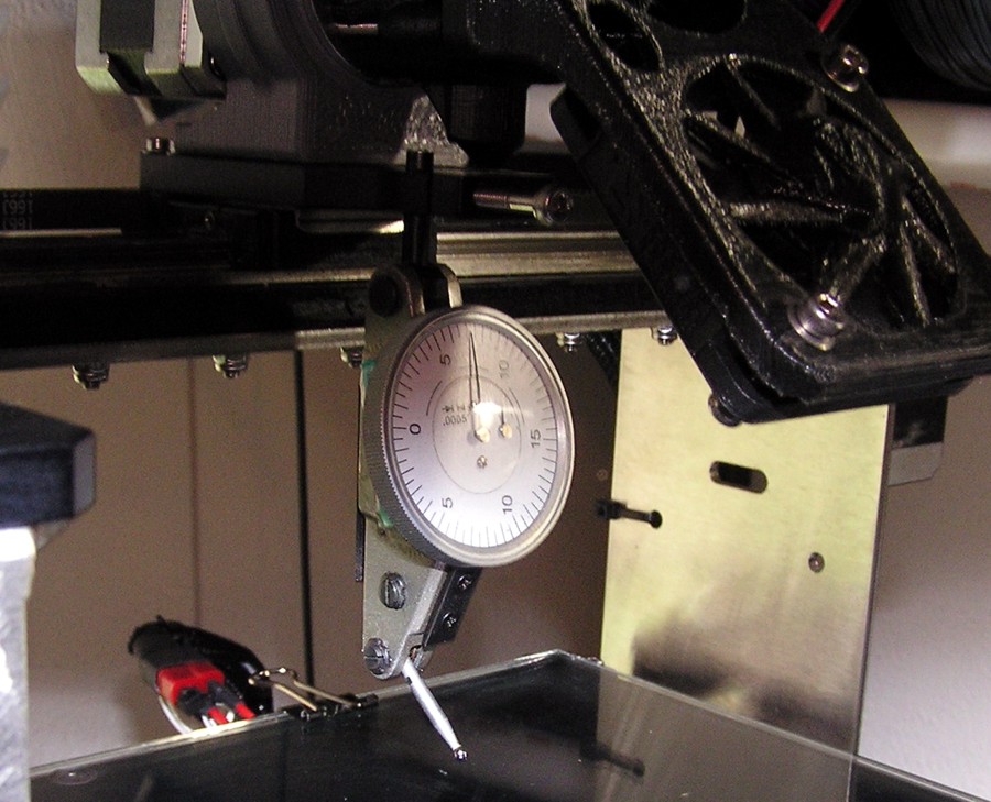

I just finished putting in my v4 Hot end upgrade and discovered the most wonderful thing.
Their is a indicator mount built right in to the hot end holder.
if you take out the clamp screw and use a longer one you can mount an indicator right in the thread clearance hole.
A little better look
Indicator
m2 indicator.jpg (161.72 KiB) Viewed 23914 times
Close UP
m2 indicator-2.jpg (120.14 KiB) Viewed 23914 times

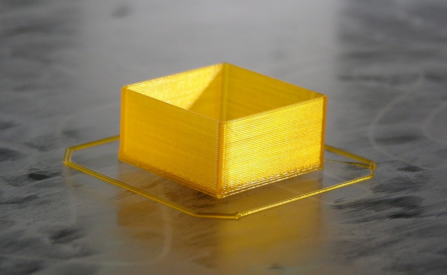

First Calibration cube with v4 hot end. Man is that thing stable.
calibration cube .25 layer

Great idea. These lever style dial indicators require less force than plunger style indicators, so they shouldn't compress the bed's springs and give a false reading.
zemlin
Posts: 467
Re: v4 Hot End Indicator Mount
Post by zemlin » Tue May 10, 2016 12:23 pm
Ryan_ wrote:Great idea. These lever style dial indicators require less force than plunger style indicators, so they shouldn't compress the bed's springs and give a false reading.
I removed the spring from the plunger in my cheapo indicator. Since gravity always works in the right direction, it's not needed here. It was just a small extension spring out in plain view behind the back plate.
