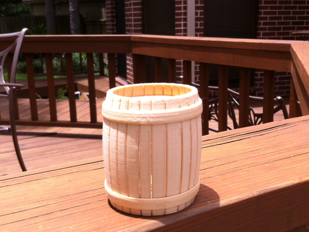

Post by Jules » Mon Jun 22, 2015 7:20 pm
This is some pretty cool stuff, gang. I think you'll like it. I'm starting this thread if you want to discuss it or have any questions about it - I've entered the particulars on how to print it in insta's "Filaments that Work" thread. And the only finish work on this is a light sanding at this point. (It needs more to finish it off, but it's low priority at the moment.)
So, without further ado, i give you....a wooden barrel! :D
Re: instas "filaments that work on the M2" thread
Post by jimc » Tue Jun 23, 2015 12:03 am
I printed a sample of this filament and everything went smooth as could be. I thought it was quite easy to print with BUT that was with an e3d and that has a ptfe liner. I can see where it might be quirky with a metal bore like the v3b. I love old barrels. Where did you get the model? Is the brown one in the pic painted or did you try stain on it?
Post by Jules » Tue Jun 23, 2015 12:23 am
jimc wrote:I printed a sample of this filament and everything went smooth as could be. I thought it was quite easy to print with BUT that was with an e3d and that has a ptfe liner. I can see where it might be quirky with a metal bore like the v3b. I love old barrels. Where did you get the model? Is the brown one in the pic painted or did you try stain on it?
Thank you very kindly - I worked that one up to test the wood filament. :) (I'll put in on Thingie later - we've had a little crisis here.) The dark brown one is just printed in PLA, for comparison, but the wood filament does take stain to a certain extent, which is interesting, and needs further testing.
(And we need to get off this thread - i know!) :lol:

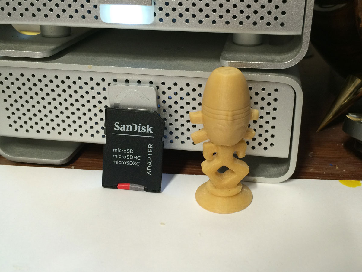

Post by jimc » Tue Jun 23, 2015 12:51 am
here is one. i tiny horga'hn i printed awhile back. i think i did this a .08 layer height. you cant see any layer lines with this stuff.
Re: eSun Wood filament
Post by Jules » Tue Jun 23, 2015 1:22 am
Cuuuuute! Unbelievable detail that small! :D
