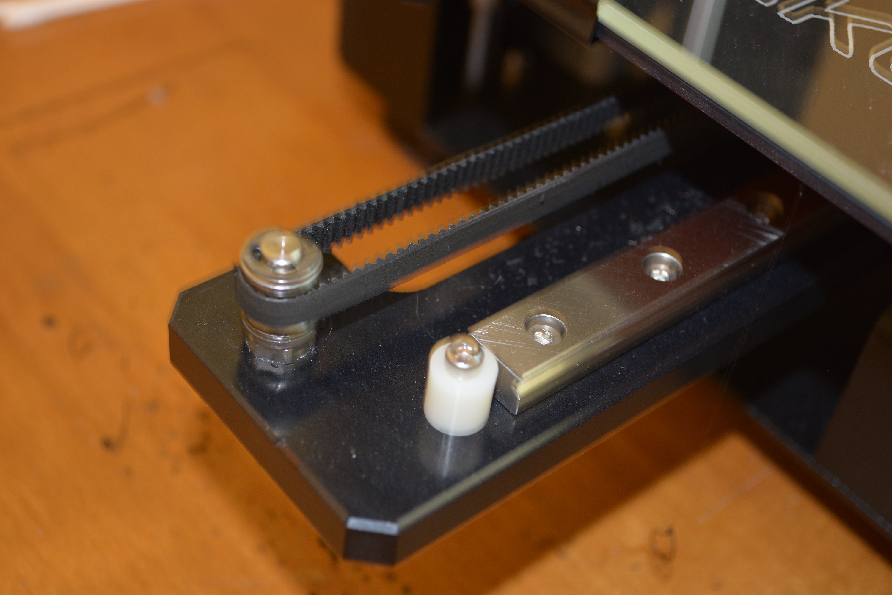

I am a new m2 owner, I've had my M2 for only a couple of months. One issue I noticed pretty quickly, but after my first few prints was that I has missed a zip-tie underneath the print bed. This caused a bunch of rubber to shred off the pulley located there. The strange thing is that once before & after my printer was printing awesome : I printed a really cool twisted vase, and a small gearless heart from thingiverse with no issues.

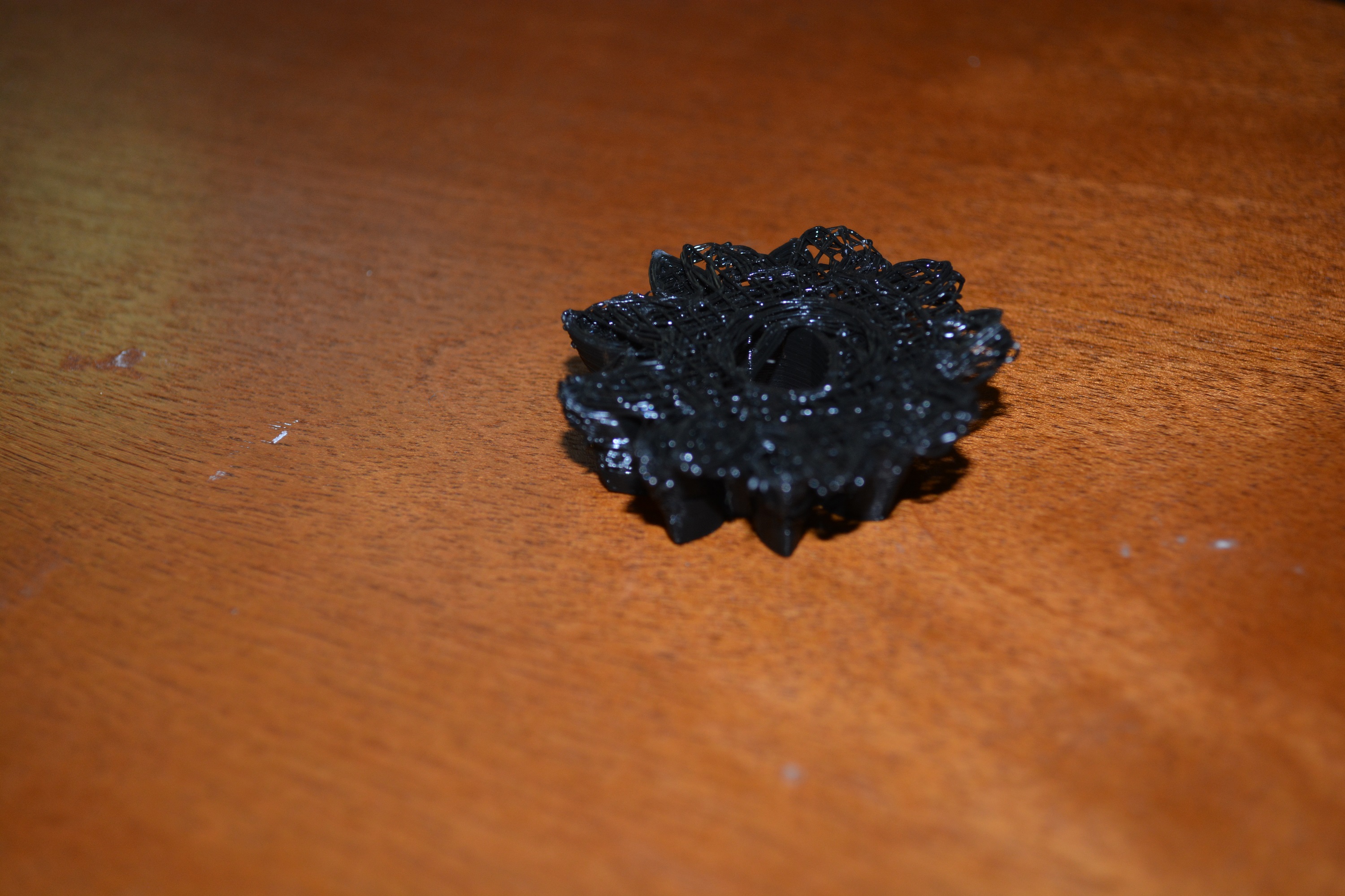

Then I started to print a large gearless heart and all was still going well, I was able to print all but two pieces. Since then however I haven't been able to complete the print, they will start out & then after a short bit start to 'shift'. I've recently tried my best to re-level the bed & z-stop and believe those are good, but the problem persists.
Do I need to replace those pulley's ? and if so, where can I get new ones ?

can you post pictures of the damage?

these small black plastic dots are what wore off of the pulleys, they don't actually look that bad - but maybe they are damaged enough to start causing the prints to shift ? and also added is a picture of the shifting I'm experiencing on one of the last few prints I made.

Make sure it's not the print that's wrong. I distinctly remember one of the heart gears being non-manifold and producing a weird shift every time I printed it, until I found a replacement version on Thingiverse that somebody had cleaned up. Shifting at exactly the same place every time is a symptom of something wrong with the print. That was several years ago, but it wouldn't surprise me at all to find the same bad non-manifold objects still there on Thingiverse.
Otherwise, is the shift always in the Y direction?
The belts are really hard to damage (someone recently posted a picture of one with a serious defect in it, but that was a unique experience as far as I know). Skipping is more likely to be caused by a loose set screw on the gear on top of the motor. If something was catching the belt enough to start shredding bits off of it, then it could potentially work the set screw loose after a while.
I'm curious as to what's rubbing against the belt. I don't have any zip ties on the Z stage at all except one in back that keeps the wire harness from moving around too much. But that wire harness has a short lead to the Y motor, so it can't get anywhere near the belt.
