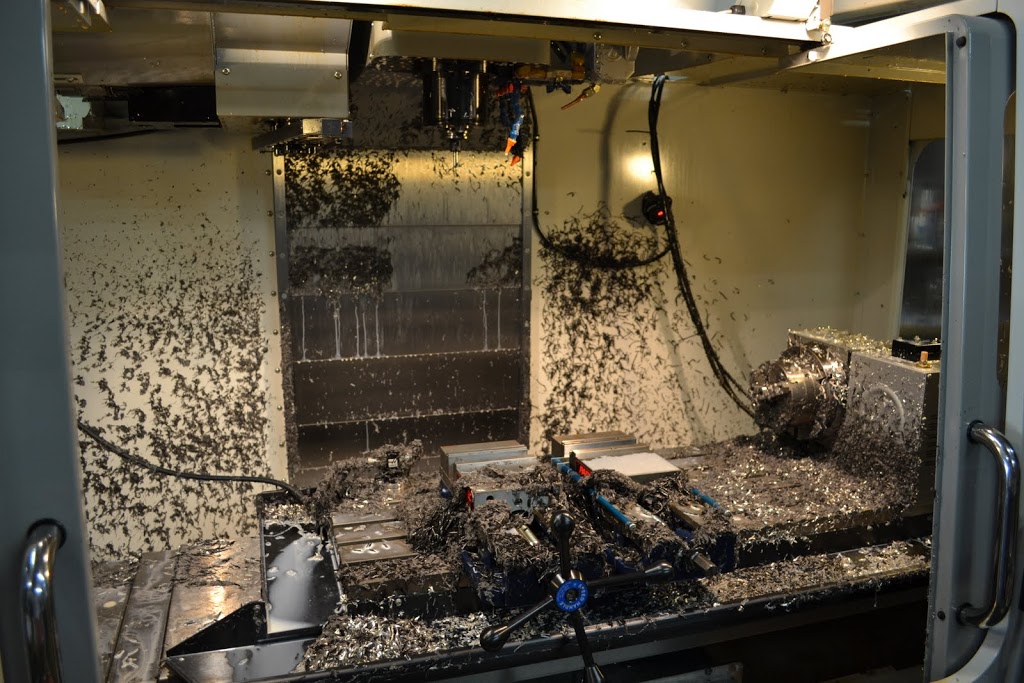

Mark the Greater wrote:what would happen if you replaced the hot end with a spindle?
One word: swarf.
Rough milling an aluminum plate
Rough Milling.jpg (231.59 KiB) Viewed 27888 times
Also: coolant spray.
You must figure out a way to clamp the workpiece to the Z stage, then beef up the Z-axis motor to apply enough upward force to drive cutters into it. Plastic maybe, wax for sure, metals not so much.
Belt drives aren't intended to withstand cutting forces, so the surface finish would be somewhere on the bad side of awful: there's a reason CNC machines use leadscrews on all axes.
You'd discover why CNC commands originally used "mm/minute" (well, actually they started with "inch/minute") rather than "mm/second".
Aaaaaand Marlin doesn't implement many of the G-Code commands used by subtractive machine tools. Worse, it implements some vital commands completely differently, for no good reason that I can find.
Back in the day, Makerbot's Cupcake / Thing-o-Matic firmware actually had a CNC mode, because they thought that would be useful. It wasn't.
I loves me some Sherline milling action, but ... it ain't a 3D printer, either.
