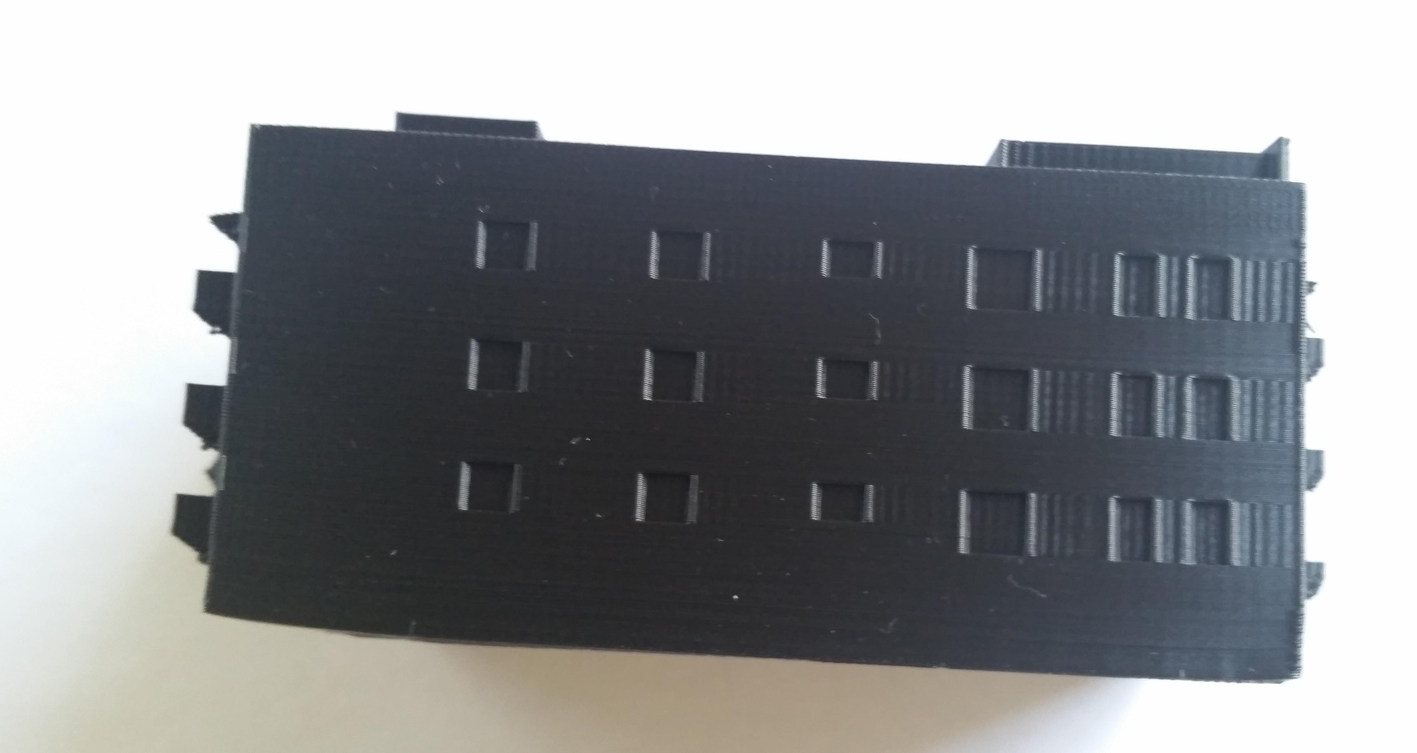

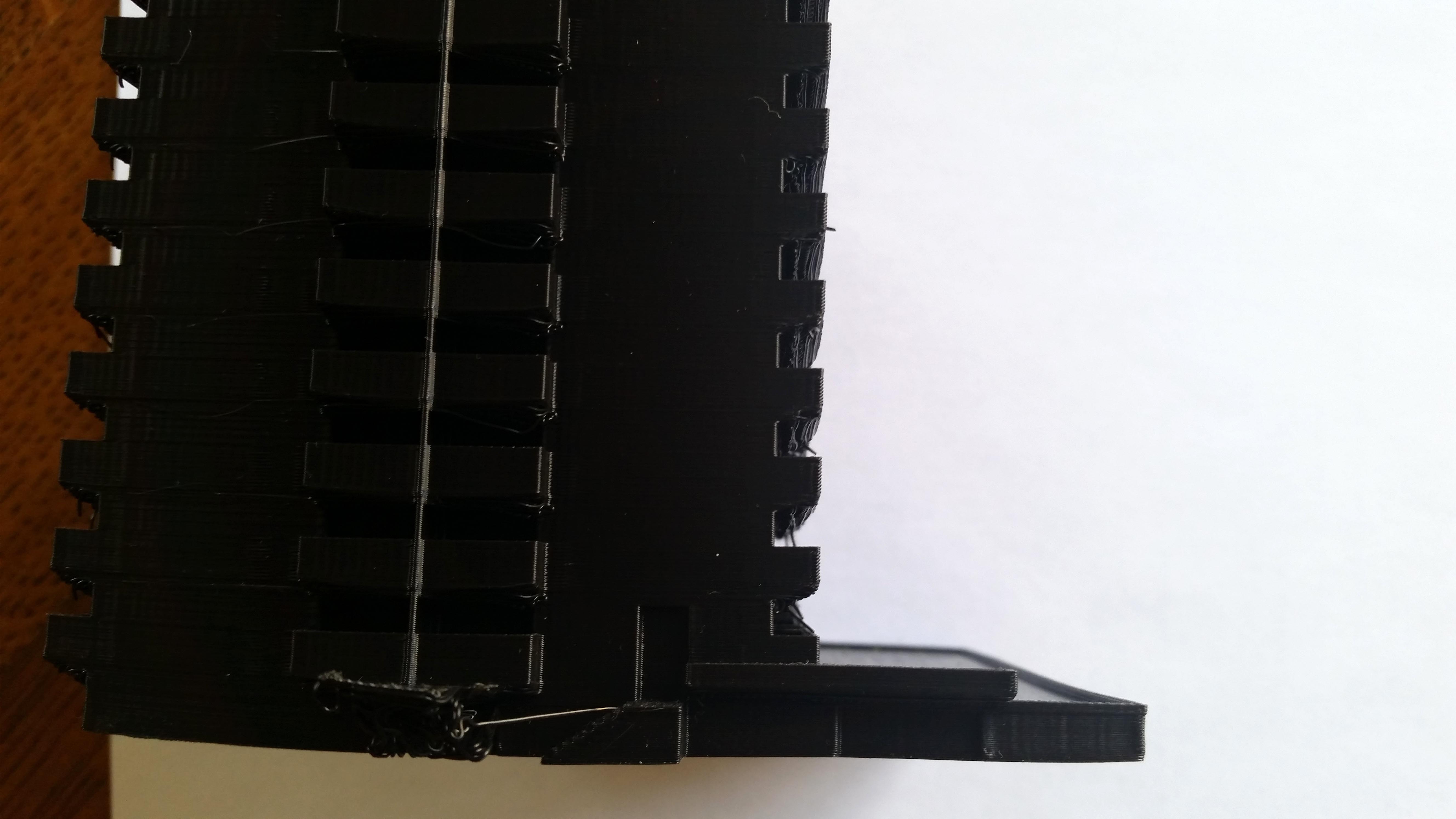

Hi,
I'm new to 3d printing and am doing my best to get acquainted with everything, but am getting a little frustrated. We bought the makergear m2 fully assembled. I'm printing w/ PLA and have tried a lot of different bed temperatures from 40-80 degrees. Our nozzle is 215. I've tried setting first layer 5 degrees hotter and then reducing.
We're mainly printing architectural models that have a large solid base, but 20-30 minutes into the print, the corners are always pulling up. It's usually the same corner that is always the worst. We've always printed directly on glass. We've tried the fructis hairspray that is recommended, elmers purple glue and bare glass. The skirt always sticks, the first layers always stick, but it's way later in the print that the corners come up. Is this a bed adhession issue? It also seems to be realted towards larger prints. When we print smaller objects they usually stick fine.
The other thing is that our desk is a little shakey. Could this be the problem?
I've looked at the zstop and bed leveling. The bed appears to be very level, I've used feeler gauges at .006 and it seems like there is adequate resistance. I changed the extrusion multiplier to .92 based on caliper readings. I've tried printing rafts, but they eventually pop off at corners too.
I've attached two photos showing the corner warping. I have since figured out how to add supports that were not in these.
Can anyone help? I feel very overwhelmed with conflicting information, and stuff spread out everywhere.

i can see that your print is warped from the side view. give me a well lit pic of the bottom so i can see how the first layer is going down. i can tell by looking at the extrusions on that layer if your bed gap is too high or low.

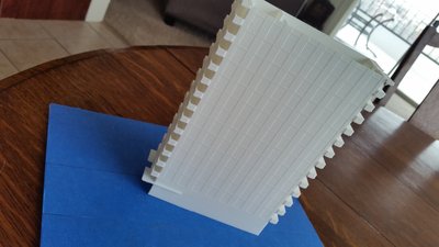

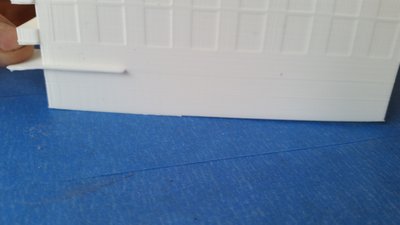

Lowered print speeds to 4200. Set temp to 60. Nozzle to 205. Also lowered speed to 30% on support, because it seems like supports sometimes get knocked over when going fast.
And I already see the corner pulling up, but it's slight. And this is a model that has fairly small footprint, about the size of a pack of playing cards.
What can I do next? Taking a pic now of previous print on bottom.
