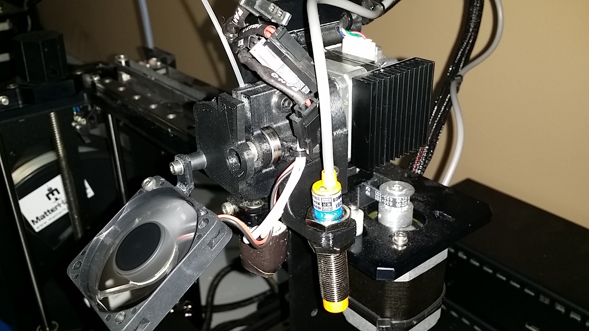

This is my current attempt. No fan on the RAMBo either. The heatsinks seem necessary on the extruder motors...

Where you have a heat sink on the extruder stepper, I have a large electrical connection block that looks as though it would be an immense pain to relocate...

dramsey wrote:Where you have a heat sink on the extruder stepper, I have a large electrical connection block that looks as though it would be an immense pain to relocate...
How many fan-less prints have you done?
You must have the new metal motor mount. These machines are running the inductive probes, and therefore the old ABS motor mounts that're modified to hold the probes.
I've done about 25 prints across all my fanless M2s, had a serious PLA jam once, but several other successful PLA prints. Every other filament has been fine.
