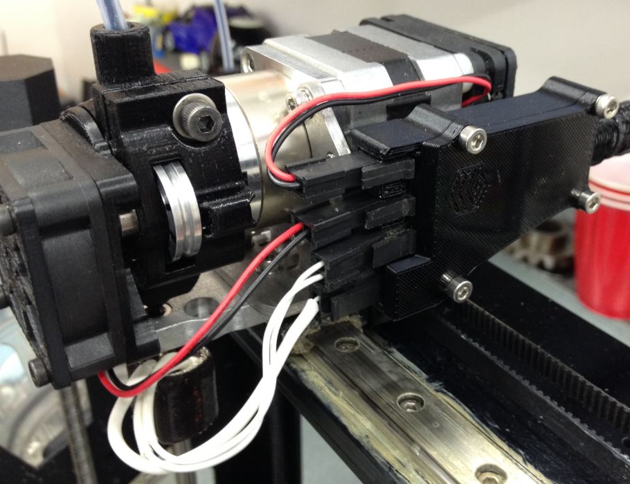

Post by over-$-pent » Thu Mar 03, 2016 10:30 pm
I had the same issue with the first wire box in that it was a pain to change hot ends often and quickly. I use PetG, nylon, ePC, ninja flex, etc. on a daily basis switching between them and came up with my own design with a "fastener-less" lid. Then after talking with tech support on some other items, they mentioned the new wire box shown here by Rick. I have been using this latest design for a month or so now, and it is very nice and well engineered. Great job Maker Gear in your quest for constant product improvement.

WHOA.... :shock: Whats that funky bearing in the filament drive that custom or is that something new too?
Someone holding out on us? :D
over-$-pent
Posts: 27
Joined: Thu Apr 10, 2014 11:11 pm
Re: Metal Extruder Motor Mount - availabile
Post by over-$-pent » Thu Mar 03, 2016 10:50 pm
I thought someone might notice that. I had issues with the ninja flex moving around on the drive gear and giving inconsistent extrusion, so I came up with the larger wheel (more contact area) with the circular cut to match the filament. This part presses over the existing bearing and required a redesigned filament drive to allow for the larger size. There are also internal changes to the filament drive to guide the flexible material and keep it on a straight and narrow path. This keeps the filament centered on the drive gear and directly over the hot end hole. The ninja flex has no where to go accept through the hot end upper hole now. It seemed to help when I had it on the V3B, so I continued using it on the V4.
