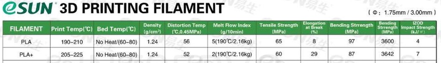

From eSun via intservo.com
http://www.intservo.com/products/esun-p ... 9061128323
Major differences between PLA+ and regular PLA:
Elongation At Break: PLA+ 29% Regular PLA 5%
Izod Impact Strength: PLA+ 7KJ/m2 Regular PLA 4.2KJ/m2
This pic is easier to read if you click on it.
