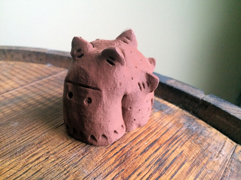

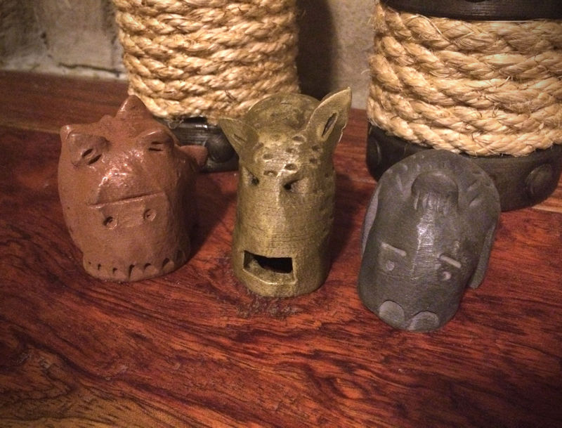

so I got ahold of some samples of some esun stuff still in beta. a stainless steel and copper filament. these are unlike their bronze which is more pigment based. these are heavy and actually have metal in them much like colorfabb filaments. both of these printed very nice and clean. the stainless in the just printed for looks like raw cast iron/steel and when its buffed out a little it brings a shine or shimmer out on the print. I didn't bring any of my pieces to a high poish at all. if you sand out layer lines and polish it smooth it will get fairly shiny. that look just didn't go with my prints which are all designed by walter's sister. not much into knick knacks but I really like these little things. very aztek like. anyway, the copper.....the copper when printed looks and feels just like red clay pottery (second pic). nothing like copper at all actually. when you buff it is when the pinkish orange shine comes out. again, its not overpowering. just enough to give a slight metallic look as the light passes over it.
