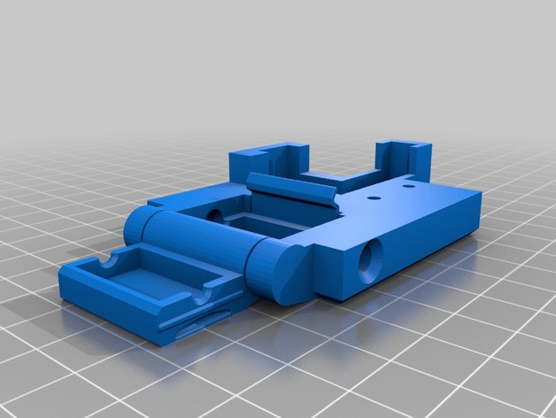

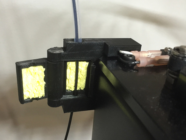

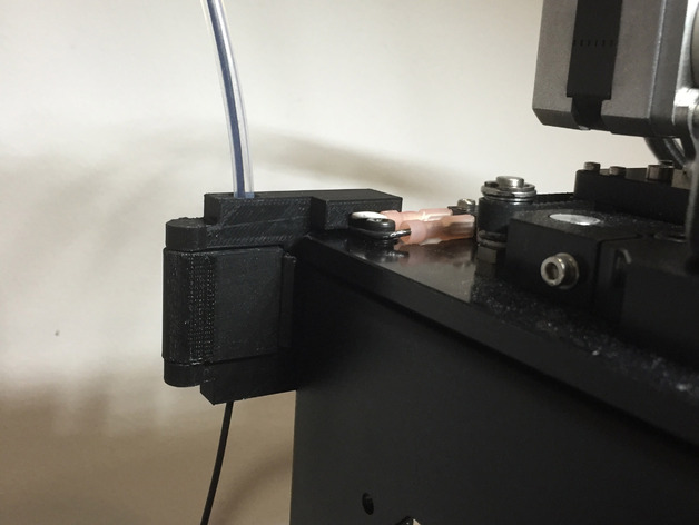

I have improved on the M2 filament holder to have an incorporated door for adding a cleaning sponge.
It also has and entry and exit lead in press fit shaft fro the 4.8Ø Bowden tube.
I made an entry lead in because I am also working on creating a sealed box for the filament with an exit tube the same as M2 Bowden tube so it plugs right into the entry under side.
Please let me know if you like it and if it was useful.

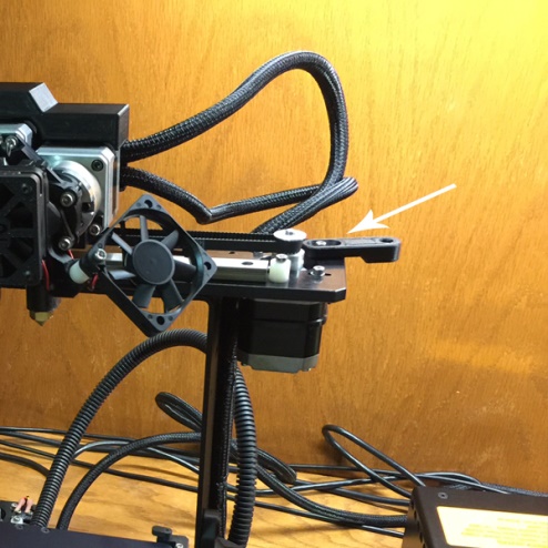

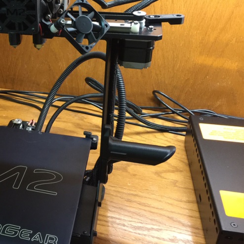

Found a couple of pics from the assembly instructions:
Pretty simple - they go like this:
Remove the M3x12 screw from the back right corner of the X Motor.
Secure the Right Filament Guide into this position using the supplied M3x14 screw and washer.
