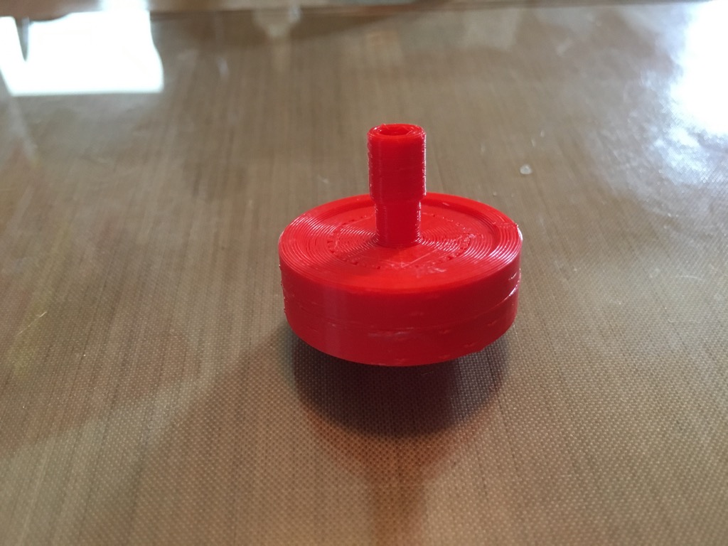

Rsilvers has gotten me into tops now. Here's a printable version: http://www.thingiverse.com/thing:1614283

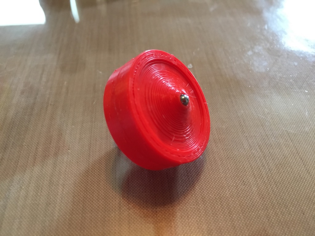

Relies on a 1/8" bearing ball as the contact point. On a smooth surface (I'm using my M2 glass bed) I can get a 2:45 spin, which is not stellar for a performance top but pretty amazing for something made out of PLA.
Printed with 20 shells to get a solid concentric infill, split in half through the body and glued back together.
