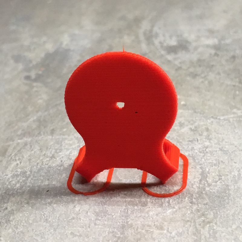

I have to make a small part for a client; it overhangs at one point towards top by .117" (2.97mm) The part is so small that supports don't seem to want to work
I am using Petg; the rest of the part prints perfect
Any ideas? Am I able to upload a part and have anyone look at it?

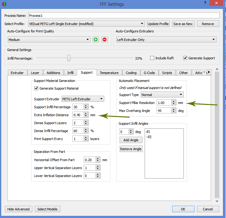

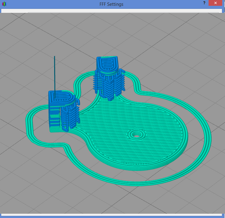

Post by Jules » Fri Jul 08, 2016 12:42 am
Okay, try the settings below:

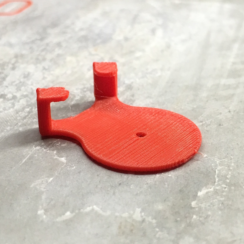

Post by Jules » Fri Jul 08, 2016 2:11 am
That turned out well! :)
