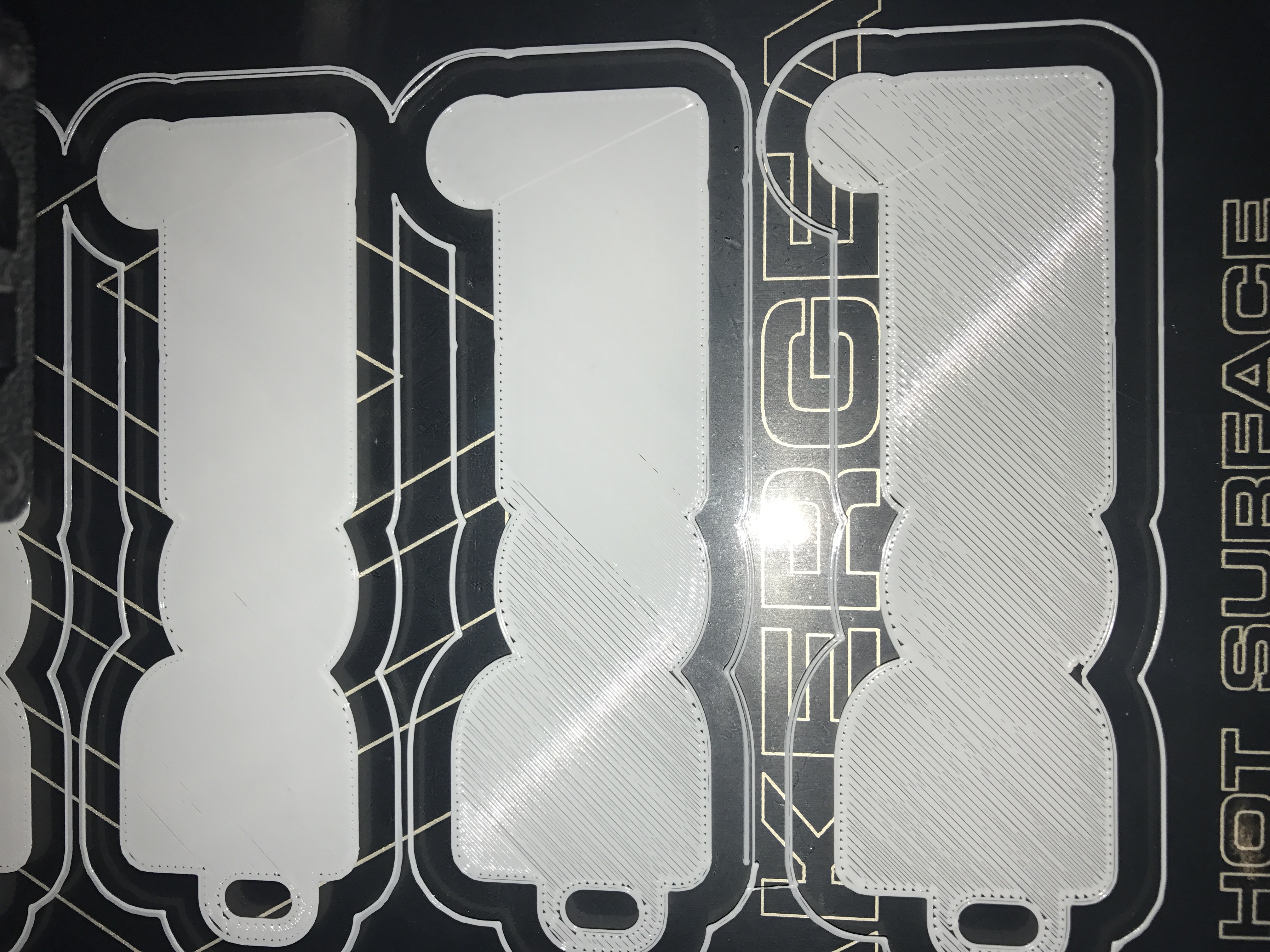

Please take a look at the attached image. Parts of the first layer are gapless and then to the left and the entire bottom object, there are gaps between extrusions. Curious what is causing this. I am using MakerGear White PLA at 220C/70C. The printer profile is for the dual extruder. I am printing with only the left T0 extruder for this print job.

Time to level the plate a bit. (That's what it looks like.) :D

Jules wrote:Time to level the plate a bit. (That's what it looks like.) :D
Thanks Jules. That is the answer I was expecting.
