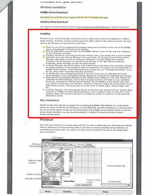

Post by Jules » Wed Jan 25, 2017 1:31 am
Ahhhh! My apologies, i glossed over the switched from a Mac part.......as i recall, there was different firmware for Windows versus Mac, that might make a difference.
Make sure you are running the correct firmware for it - the newest firmware does not apply to machines purchased in 2015.
http://www.makergear.com/pages/user-guides
You want the Windows driver at the bottom of the page.

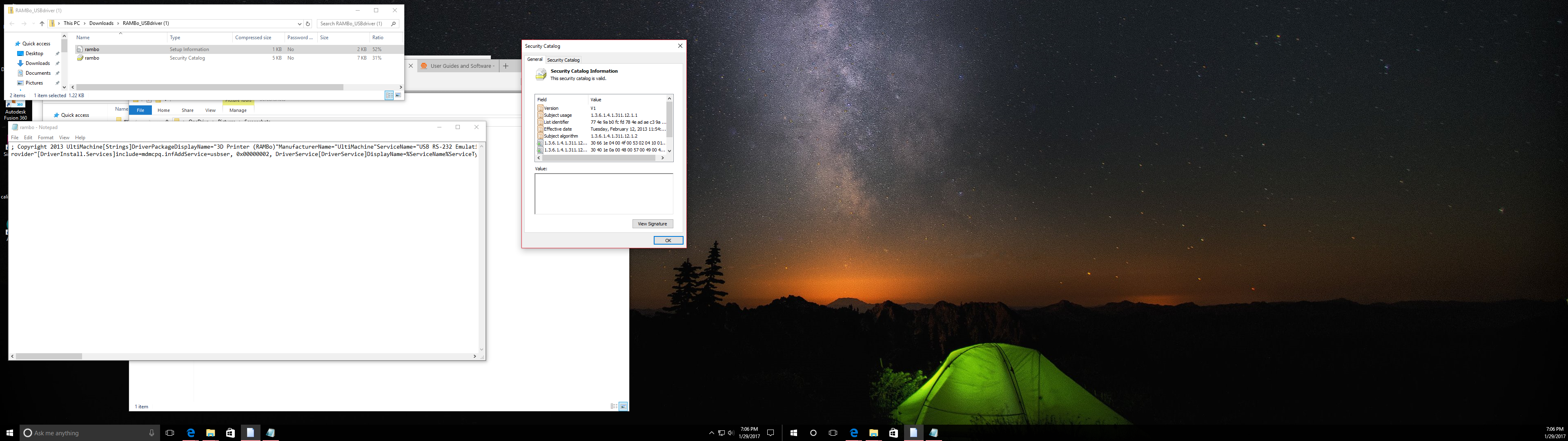

Post by Nofear202 » Sat Jan 28, 2017 2:47 am
I downloaded Arduino 1.8.1 program. Then I went to the link you told me and downloaded Rambo_USBdriver. I opened up Arduino and tried to open up the Rambo_USBdriver. It told me it can only open up its own sketches. Is there a new way of doing this or a video to show how to do it?
thanks

Post by Hugs » Sat Jan 28, 2017 1:59 pm
Nofear202 wrote:I downloaded Arduino 1.8.1 program.
You need to use an older version: 1.5.5. That's the tested and recommended version.
https://www.arduino.cc/en/Main/OldSoftw ... ases#1.5.x
