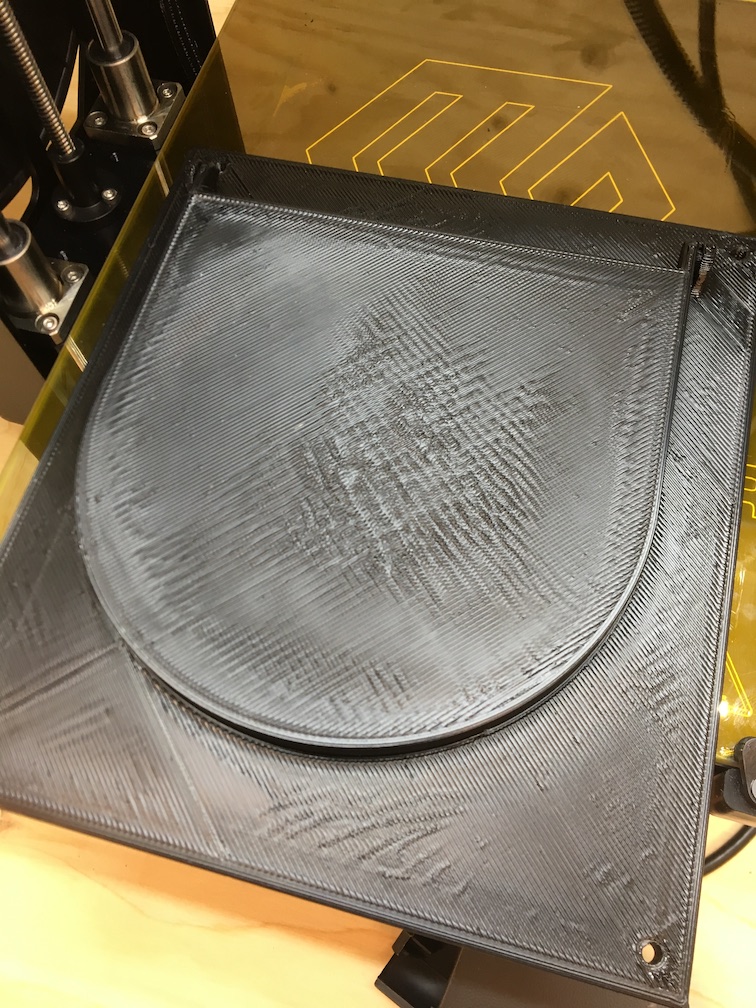

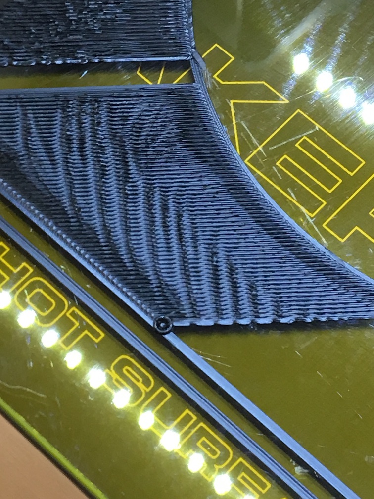

I was able to improve on the above printing by running through the quickstart app again and re-leveling the bed and setting the start height again. But I'm stilling having the problem quite a bit as in these prints:
I have the printer in an enclosure (which stays at 40-45c during printing) and I'm using Simplify3D. I'm printing with Push Plastic black ABS. I've tried adjusting the extrusion multiplier (from 0.9-1.1) and temperature (from 235-260) and haven't seen a huge difference in quality.
Any ideas/pointers as to what my problem could be?
