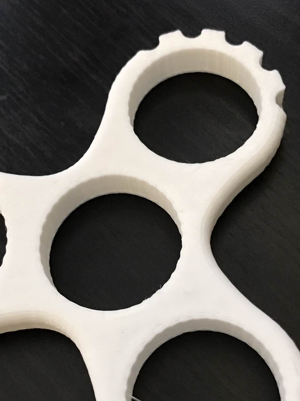

The problem is that when this Rev. E printer prints the circle of the model, it shakes as if it's printing something that's very not smooth. The print came out with a lot of "zigzags" on the circle edge. See picture below, the White one is printed on this Rev. E printer.
The weirdest point is, all 3 printers are using the SAME GCODE FILE. The estimated print time shown in Simplify3D is a little more than 3 hours (I printed 9 pcs in every run) and the 2 Rev. D printers finished the print in about the same time as estimated. However, it took almost 6 hours for this Rev. E printer to finish the job.

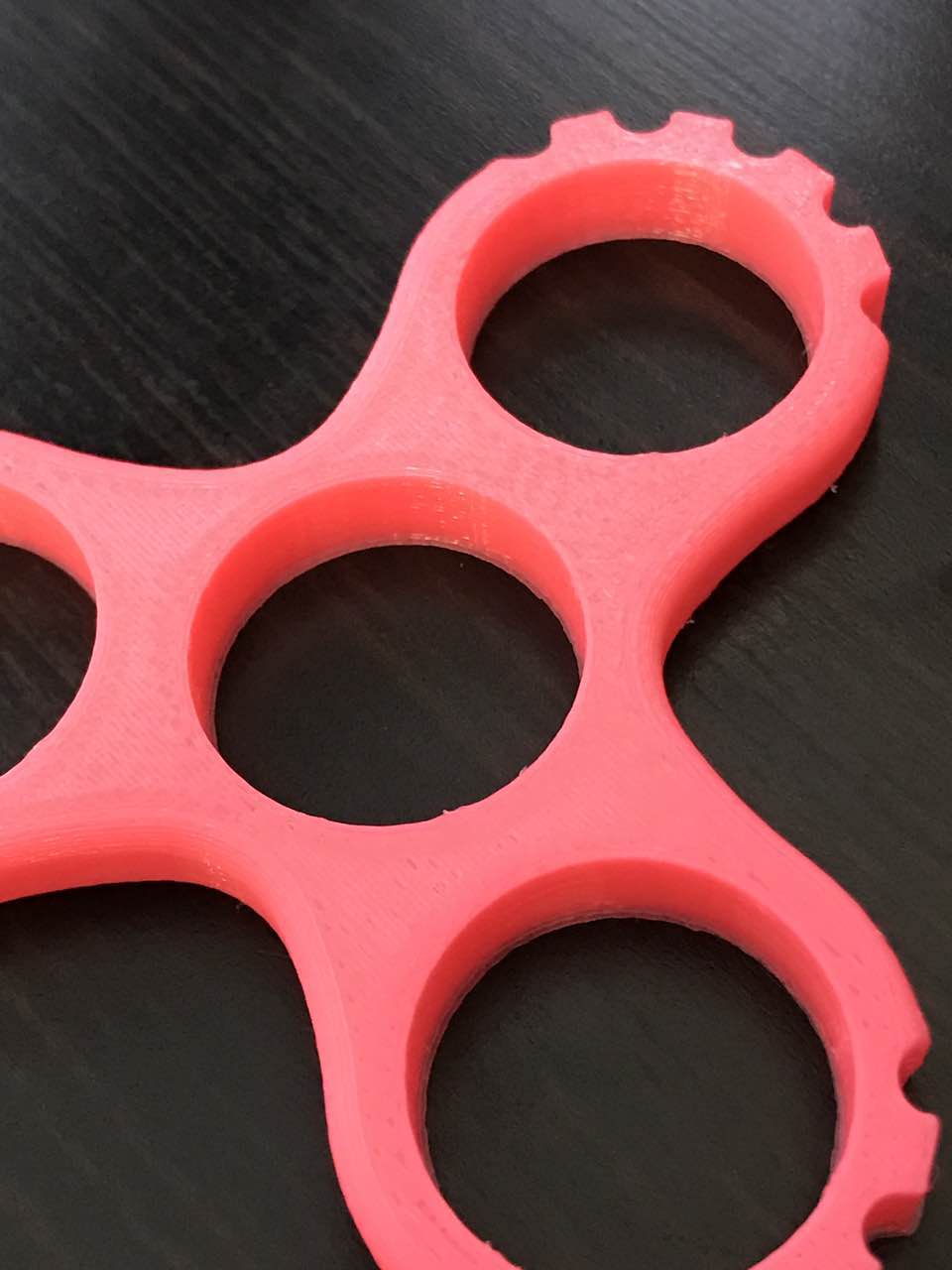

Below (Pink) is the model printed on one of the 2 Rev. D printers.

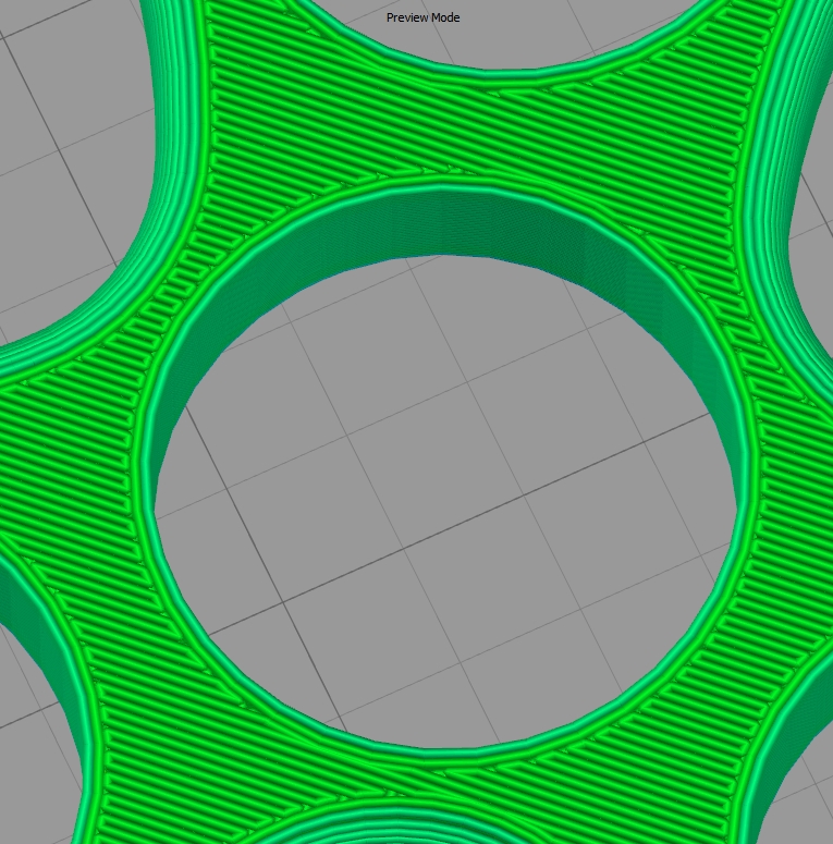

The file in Simplify3D looks like this:

I'm going to guess that this is due to firmware settings for acceleration and jerk. There were changes in the settings between these 2 machines firmware.

3dPrintingMD wrote:I'm going to guess that this is due to firmware settings for acceleration and jerk. There were changes in the settings between these 2 machines firmware.
Thank you! Do you have any idea which part should I change in order for this Rev. E to match the performance of the 2 Rev. Ds? In my Simplify3D settings, I have "M204 T10000" and "M201 X1200 Y800 Z500" in the starting script. Shouldn't this overwrote the firmware acceleration settings?
