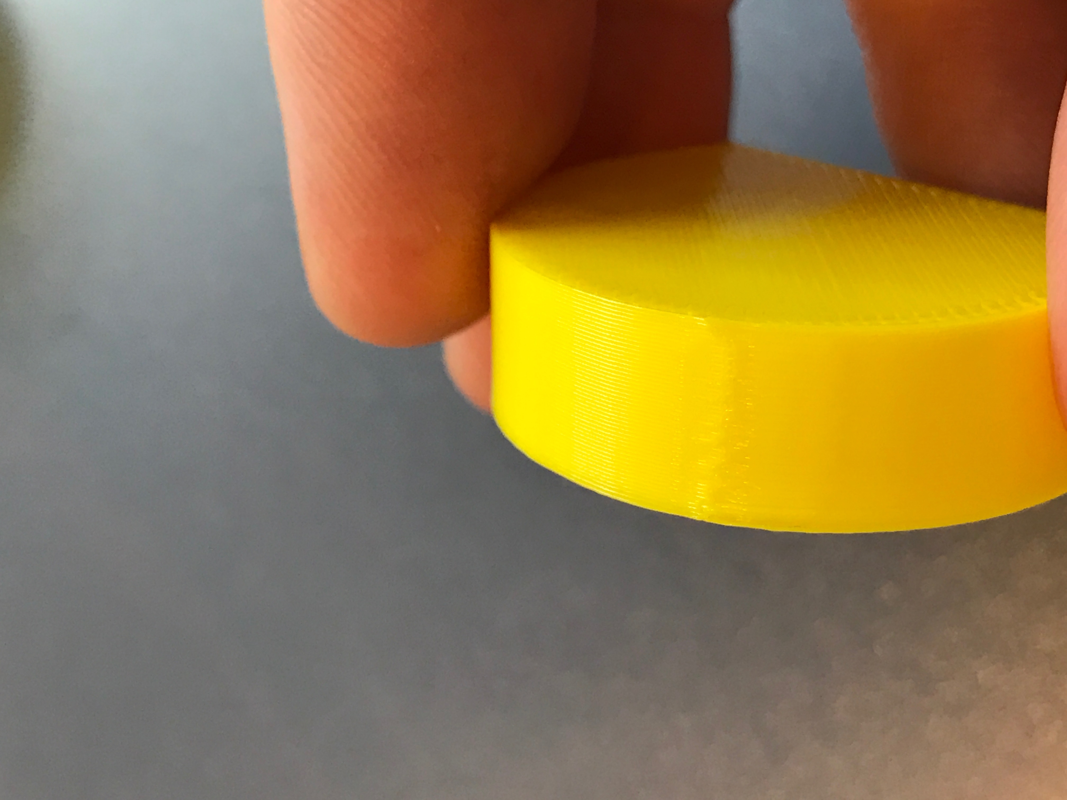

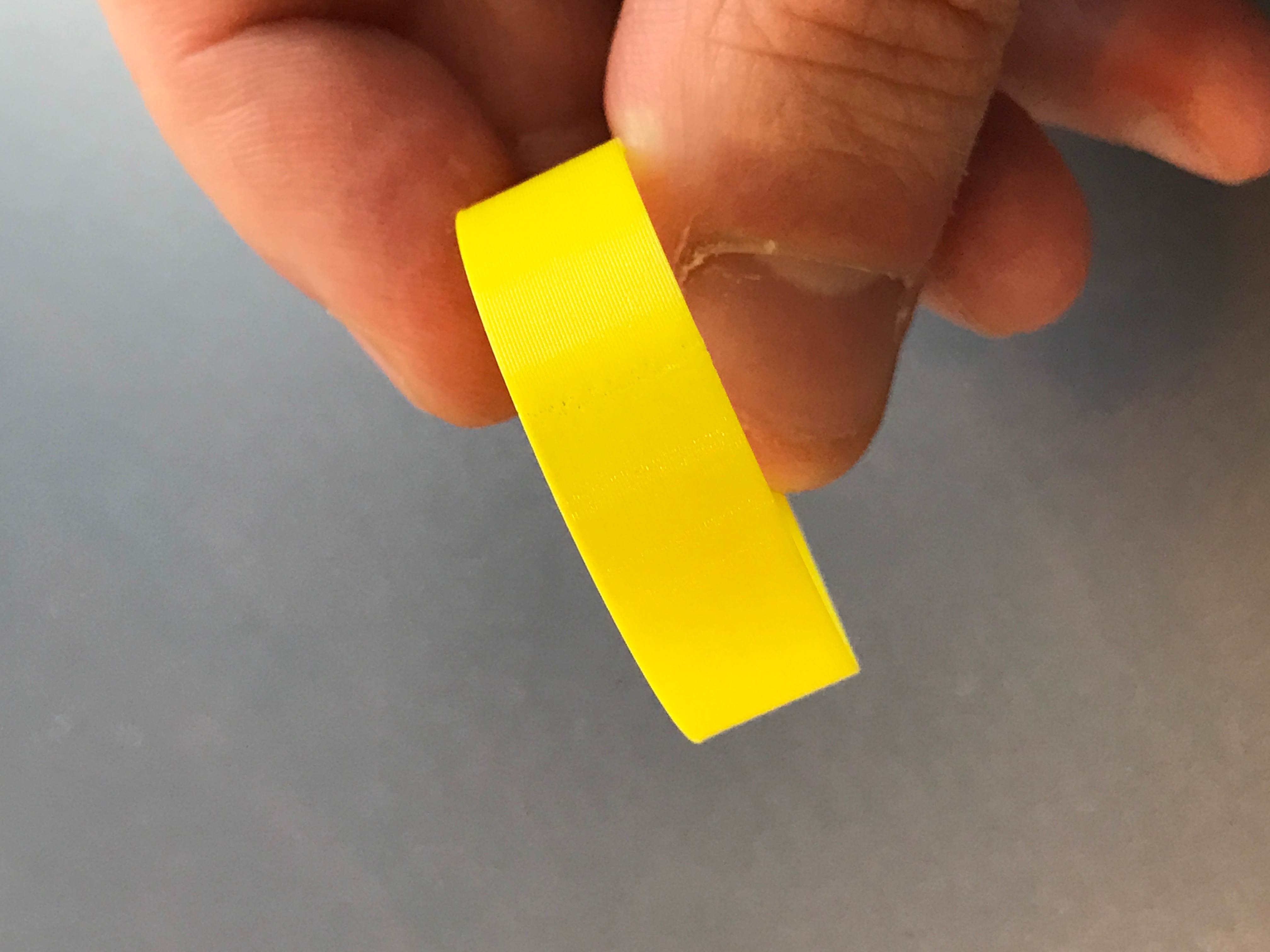

So some of you may have seen my last cry for help in relation to blobs and zits. I've done a LOT of printing trying to eliminate them the best I can and I'm REALLY close. I've played to no end with coasting and extra restart distance but it never really seemed to make it go away on round pieces. In recalibrating my printer as I changed spools (using the cube here on the forums), I got the idea to print one of my trouble pieces similar to how I'd print the open cube. So I printed and guess what...there's a seam but NO blob or bump.
So I'm getting somewhere
I next changed my infill settings to have my outline overlap to 0%. I figured go big or go home. It still didn't make much of a noticeable difference. Are there any other settings related to my infill that I can do to stop this seam from appearing??
Here are some pics one of the empty piece and one with 15% fast honeycomb (it does it on retilinear as well)

The first picture (the one with the bump) has infill and 3 top and bottom layers. The second picture has no infill and no top and bottom layers. There's a small seam but no "bump" on it.
I've played with most of my retraction settings to no end and if I tell Simplify3d to print starting at random spots I'm back to zits on curved surfaces. If there anything I could be doing wrong with my infill or top and bottom layers?

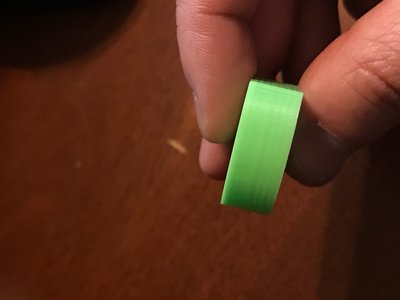

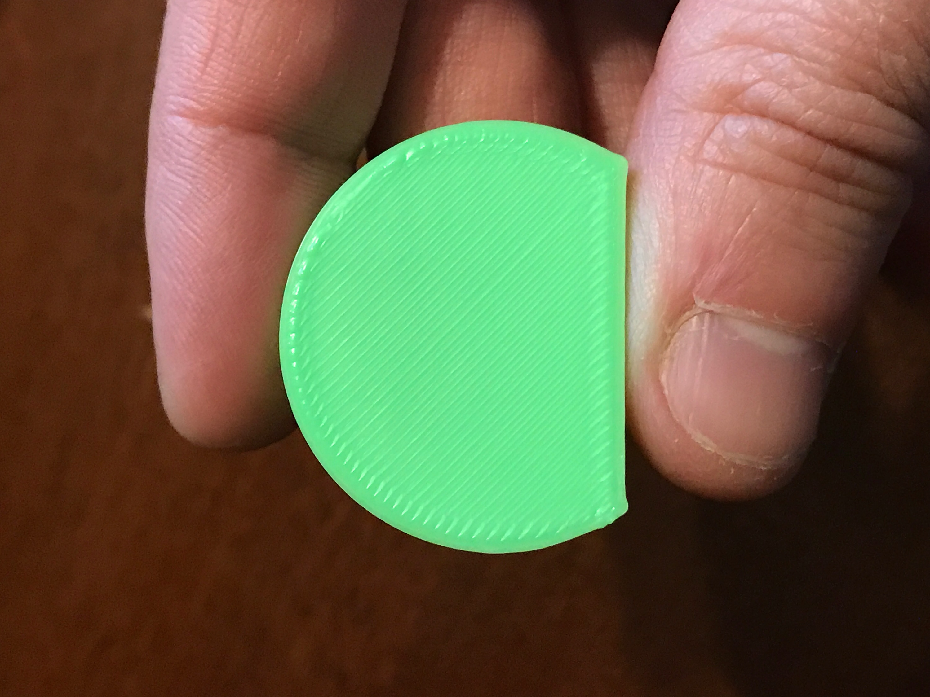

Thanks Ed - that was a good read. I have a lot to learn. I've only been 3d printing for about a year and I'm tend to chase perfection in everything I do. It can get me into trouble! :D
Here's the latest with some more tweaks. Looks pretty good to me!
