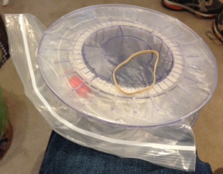

I use ziplock 1 gallon bags with ~6 no name silica packs (amazon: 50 packs cost ~$8 and are reusable). These are inside a trash bag with a damp rid tub. That's in a plastic bin. Works fine for at least 3 months (longer if you switch damp rid tubs).
