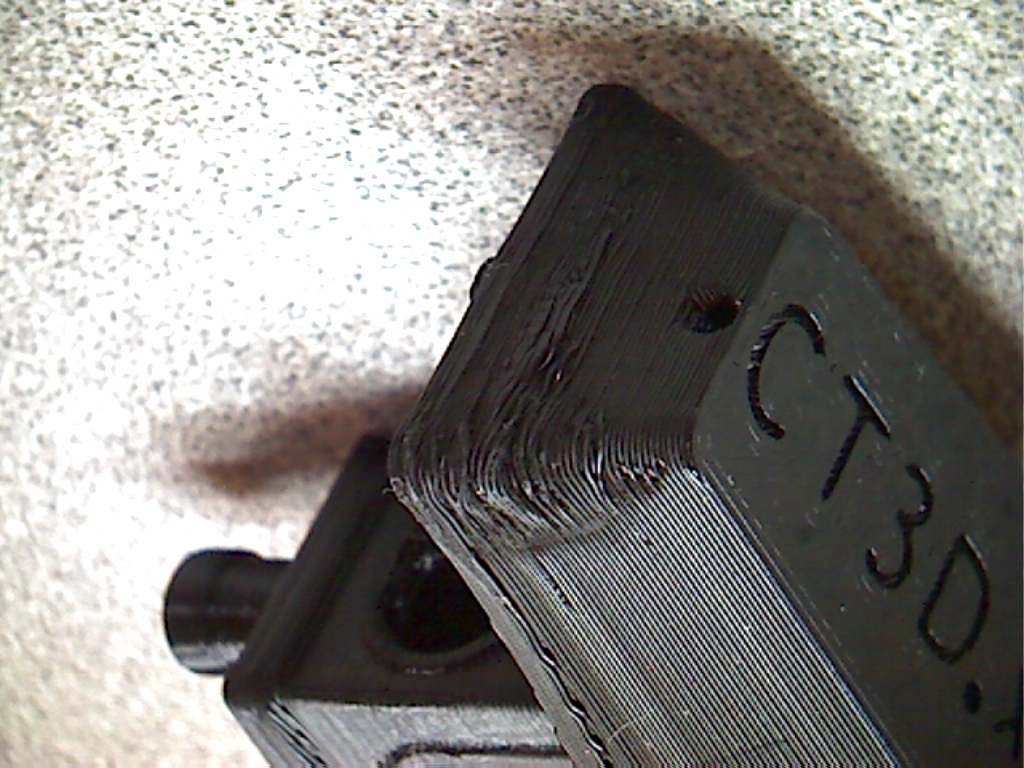

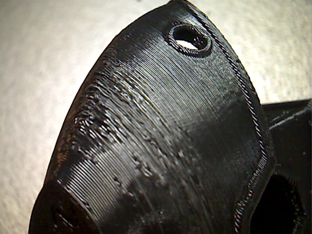

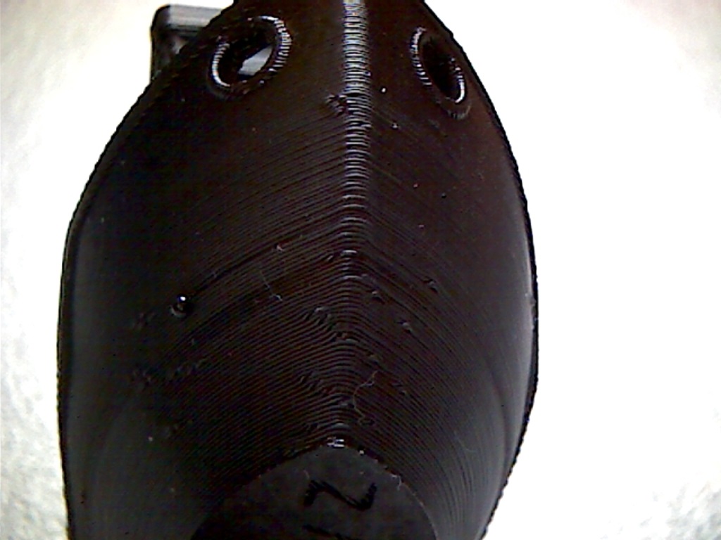

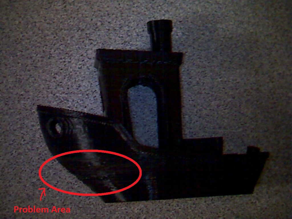

A couple of days ago I decided to print a Benchy just for fun and noticed that the quality of the print was not very good. Specifically, the hull of the boat had some issue, I was expecting the hull to be nice and smooth but that is not the case. Please check out the pictures below:

Usually those problems on a Benchy indicate a cooling problem. How was the boat orientated on the platform? Try positioning the front towards the front of the printer were the fan is (if it wasn't) and see if that helps.
Posts: 2000
Re: Benchy quality issues.
Post by insta » Wed Oct 11, 2017 4:15 pm
Print it slower, cooler, and with a lower layer height (0.1mm).

If I remember correctly the last time I printed one I noticed that the front of the boat was using bridging due to settings. Check for bridging on the preview.

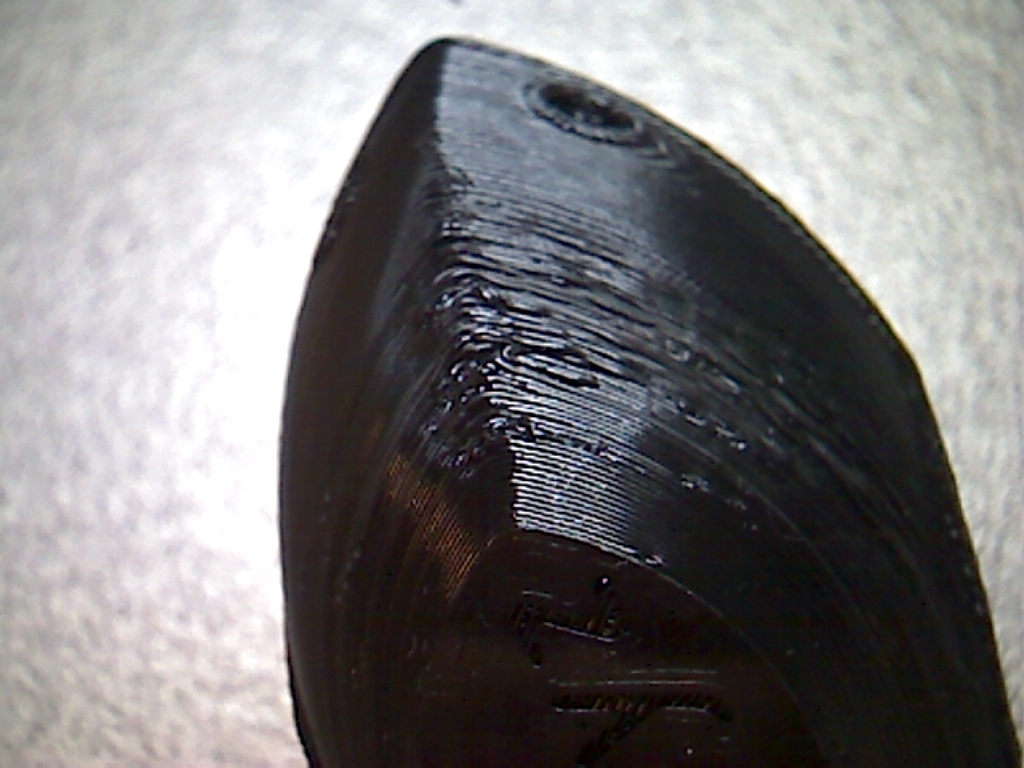

OK, so I followed the advice and printed a new boat this time by orienting the print so that the front of the boat was pointing towards the printer fan. I am happy to report that the front of the boat now looks much better, however, now the back of the boat looks much worse:
