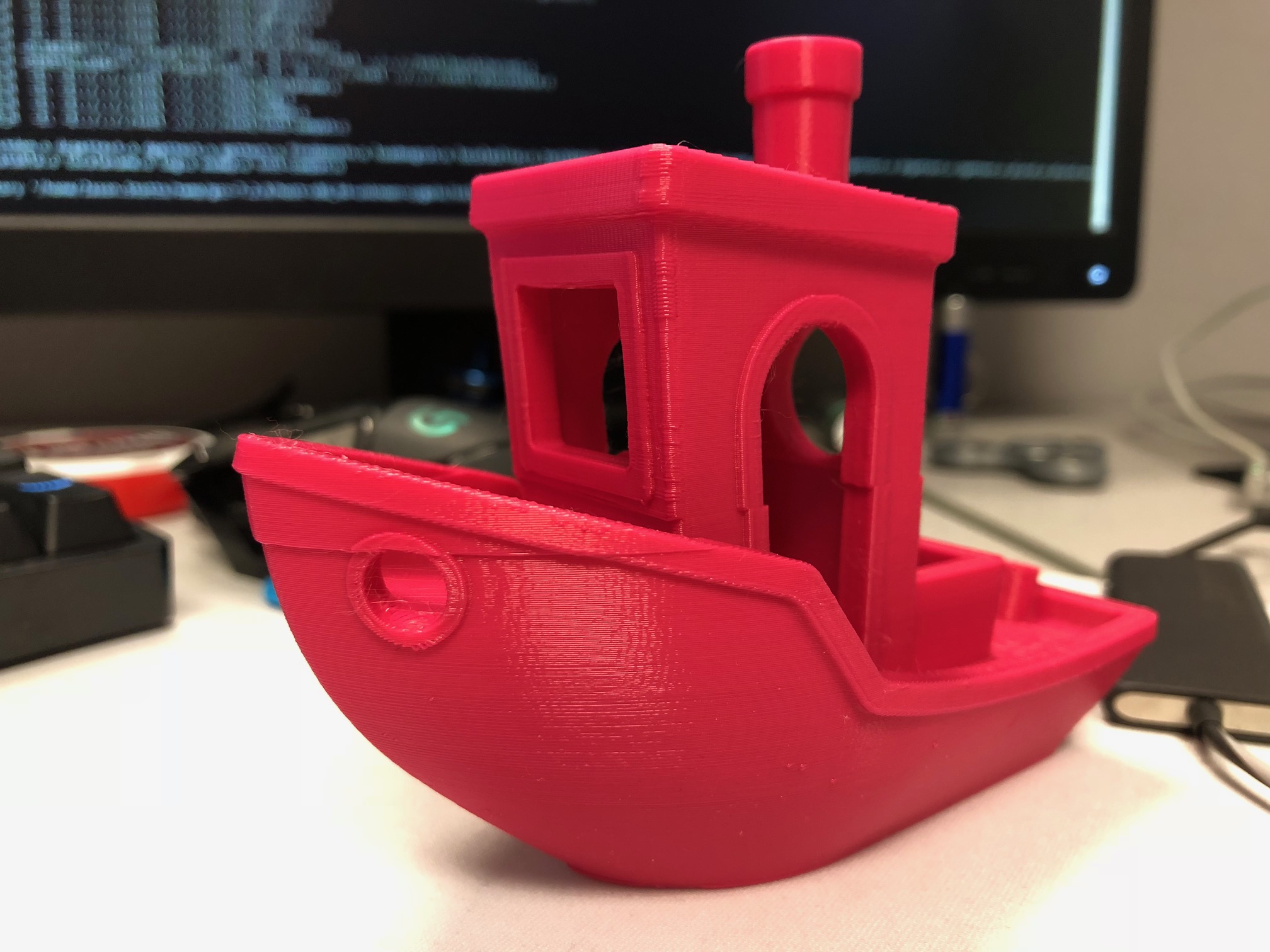

So I brought a "EINSY" board http://reprap.org/wiki/EinsyRambo (the one in the Prusa MK3) since I kinda wanted a Prusa but didn't want to buy a Prusa. I've spent some time with it on my M2E and so far I'm in love with it, I highly recommend this board! Here's my thoughts so far:
Pluses:
Quiet even in speadCycle mode.
Sensorless homing is wonderful.
The Trinamic 2130s seem to produce a better quality print.
Stepper motors run cooler.
Negatives:
All the fan outputs are 5v. This is the apparent reason why Prusa is using the Noctua fans. I have a 40mm Noctua and that one seems to be fine for the extruder, but the 5v that I have for my part cooling seems a little inadequate.

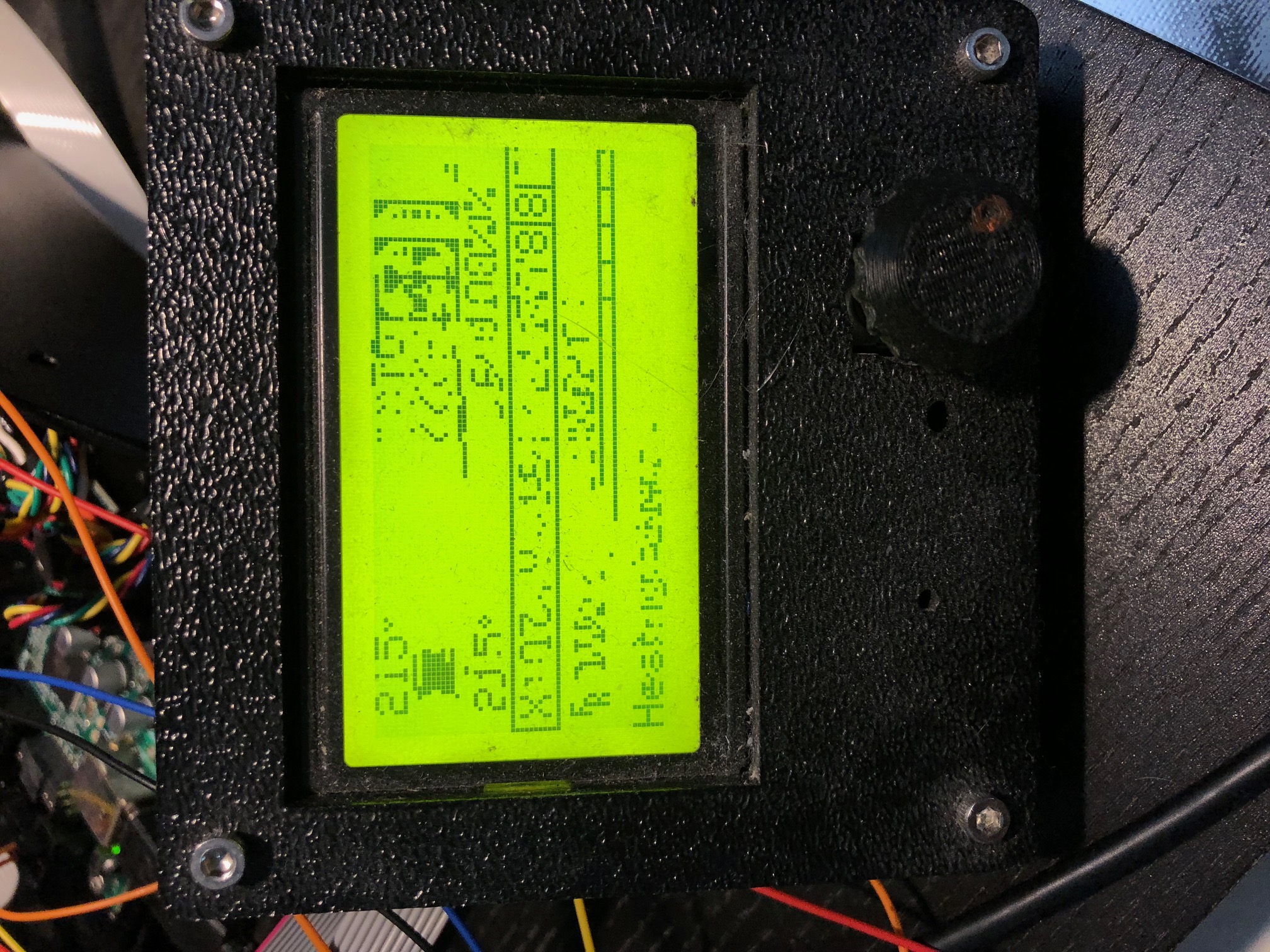

The REPRAP_DISCOUNT_FULL_GRAPHIC_SMART_CONTROLLER I have for the display is a bit garbled, it still works but it's a tad annoying.

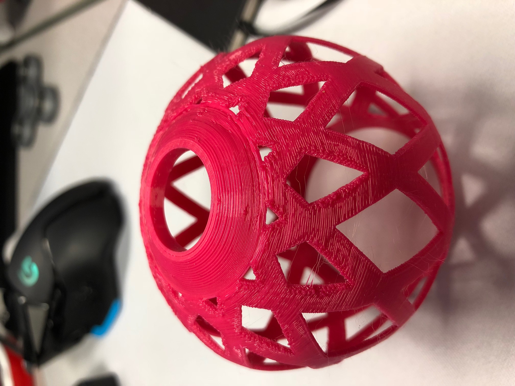

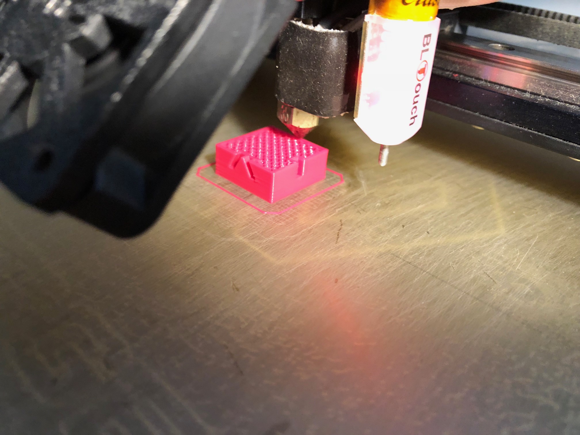

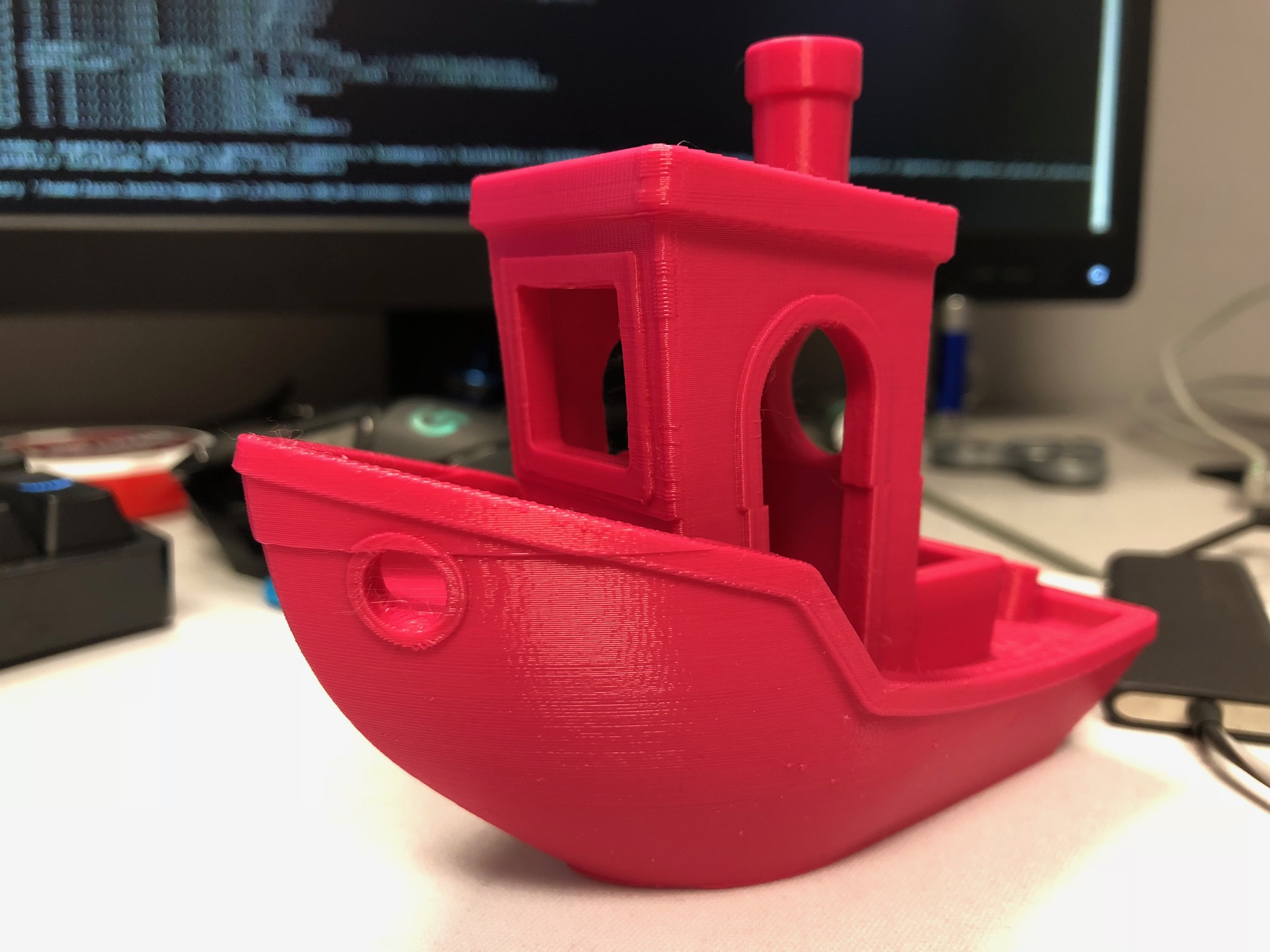

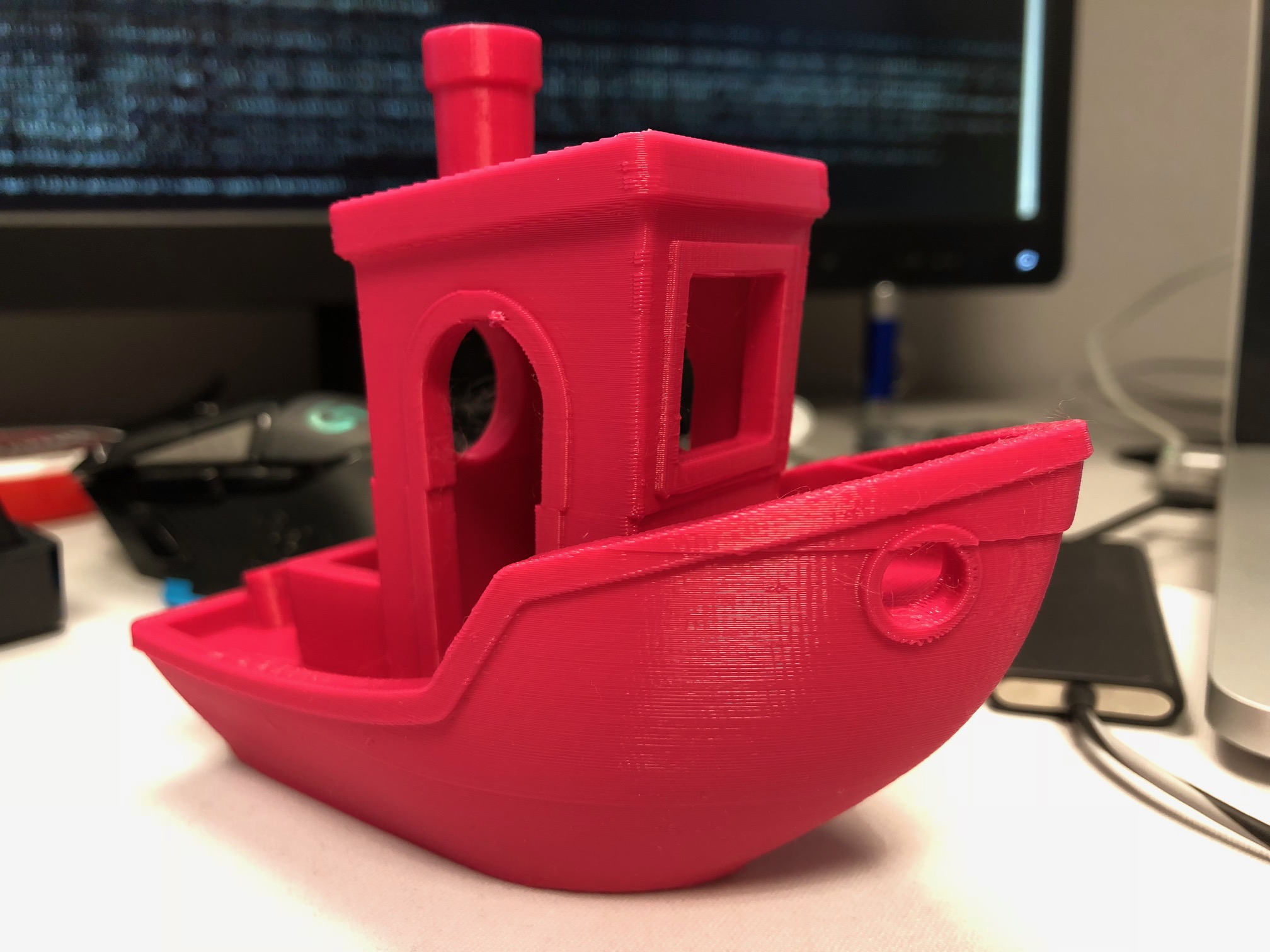

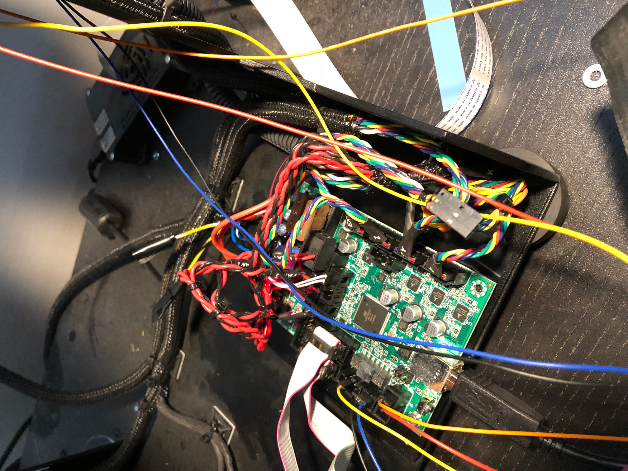

Here's a photo of the board wiring is messy at the moment: Sample print but this is with the 5v fan and you can see cooling artifacts in it: Garbled screen: Things left to do / research:
I'll look for a fix for the screen, but I really don't use it that much since I use OctoPi so I may even remove it.
Find a 5v fan that outputs adequate cooling or I may go with a MOSFET solution and use VCC for the fan.
I would highly recommend the MG guys to look into this solution for one of their future printers!
Pluses:
Negatives:

I'm using the the NF-A4X10-FLX 5V for the extruder fan, and Gdstime 5 Volt 50x10mm 50mm for the part cooling fan currently. I've ordered a couple of blower style fans that I'll probably use for the part cooling as the 50x10 doesn't seem to provide enough airflow for PLA cooling.
I did solve the garbled display issue, it was a timer issue that I failed to implement when I was creating the Einsy configuration files in Marlin.
I've got a layer shift on the Y axis on a 4+ hour print (200% Benchy @ 80mm/s) but everything on it looks pretty good surprising with the 5v fan. I'm going to add a little more voltage to the Y driver to see if that fixes this issue. I haven't started actively cooling the drivers so it could be a driver overheating that caused the skip as well. More testing to be done there (it could be an acceleration issue as well).
On a more difficult print the cooling inadequacies are more prevalent. So a blower may be needed to get the cooling needed.
Still tweaking and tuning to be done, but overall I'm really happy with it. I do find it eerily quiet when it's printing, I need to change the fan in the power supply so that it'll be even more quiet. I'll report back more when I've got more prints / tests done.
