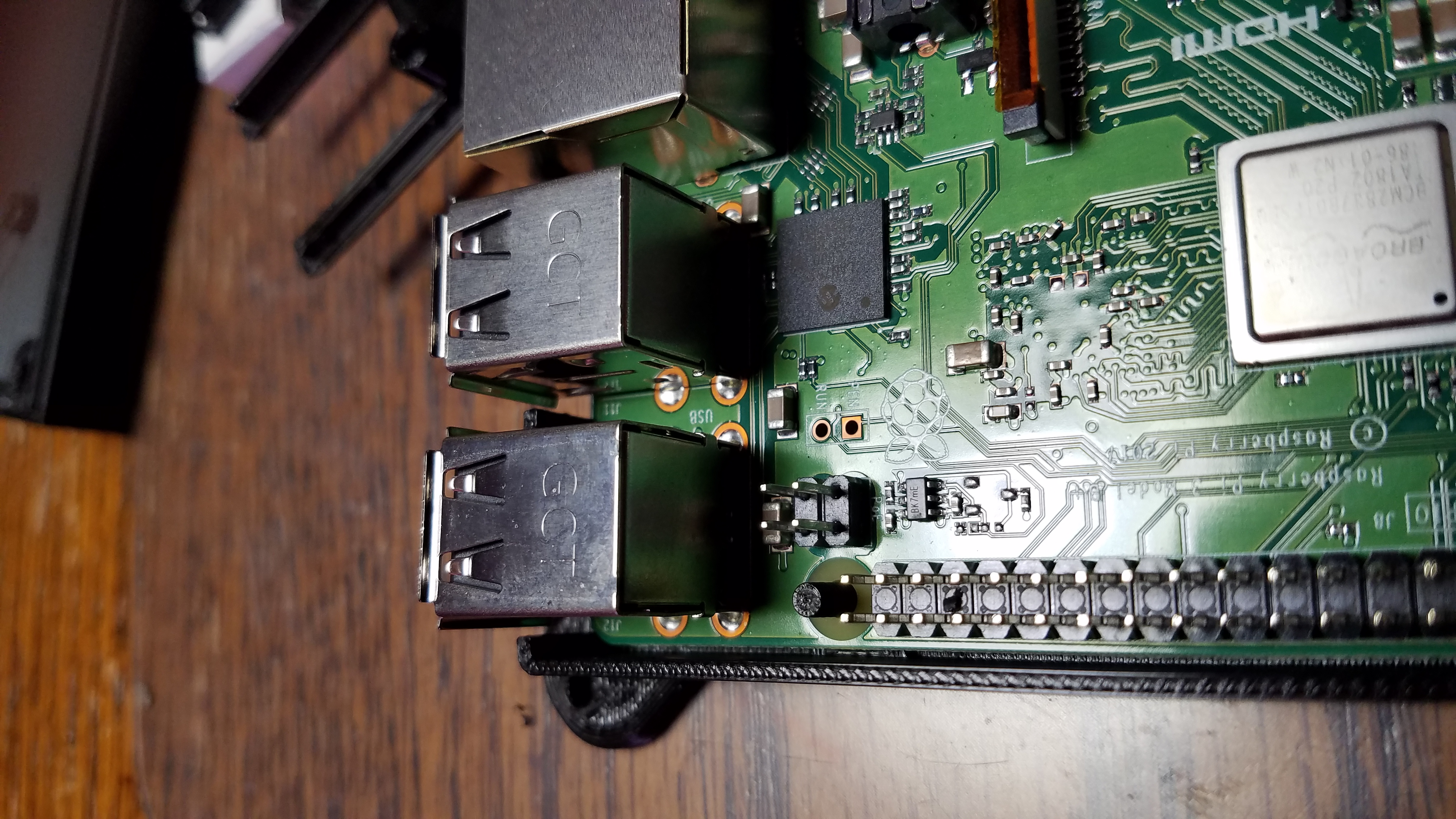

Will just give it a try and see how it all shakes out.. still printing enclosure.. first one was a bit over kill found a nice one that seems to do what is needed.. keep the back of the board insulated and let as much air in as possible without using a fan.
https://www.thingiverse.com/thing:2896278 However it won't fit the B+ as there is an additional 4 pins that must not exist on the older model .
