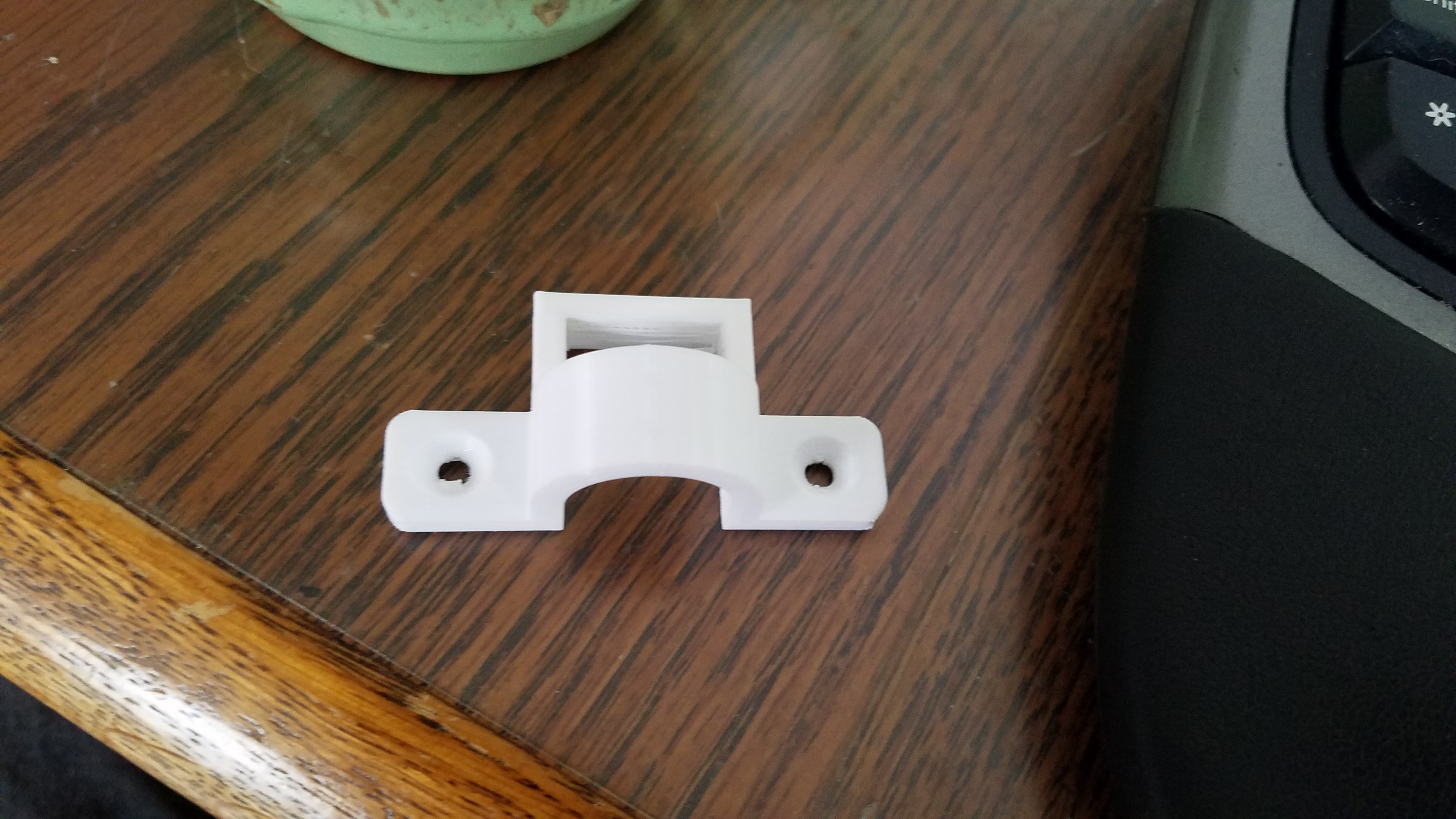

just recently bought a roll of eSun white PETG and it is really nice for mechanical part! With a proper calibrated starting height and extrusion multiplier it prints just like PLA . Sticks to the polymide tape really really well, almost too well. I use canned air upside down to freeze the parts off so as not to destroy the tape which I have done. The esun prints really nice at 245 with an 85 bed no fan.. Really like the stuff for mechanical stuff but is a bit stringy.
