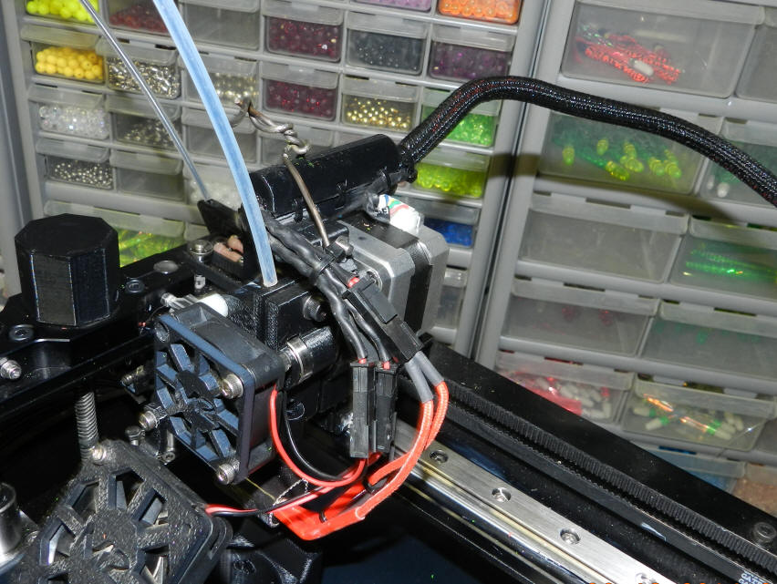

Changed the filament drive, noticed the hot end moved pretty easy off vertical.
Went to snug the allen sets that hold it and discovered a cracked housing.
Could be part of the reason some of my prints had furrows/indents.
Temp fix is mechanic's wire while I print out a new one from Thingiverse.
First one I printed, ABS warped to severely. Went to PLA and hope this print comes out.
I know, this can't be the first time this happened.

PLA print came out perfect. ABS unless you can print it without supports, it's gonna be problematic
clearing the slots where the stay-ties slide thru.
Now, that I have the new mount installed, 1st check head space and print out a new spare is job 1.
Mounting screws on the mount to the slide/belt part were loose too.
Having a complete spare motor mount part for this on-hand is a wise move.
http://www.thingiverse.com/thing:354424 is the part.
Come with a spare sleeve for another motor, but the main part is good to go.
With this motor not being fully secured? ...I see the reason some of my prints didn't come out 100%.

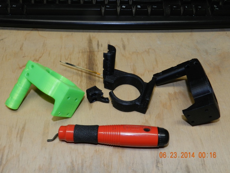

PLA doesn't work that good, had it loosen up twice, then the hot end clearance needs to be reset.
PLA is not how this part should be made. Never have any issues getting part to stick the glass build bed
since I went to Aquanet hair spray.
Looked at the the factory piece, top layer-side-bottom is .046. Factory part weighs .6ths of an ounce.
Part I made was .9th of an once, so Makergear has a better recipe for parts that do not warp.
Photo shows the green PLA which I do not recommend. The ABS one I printed the holes deformed
and the whole piece warped badly. Also, there was a stress fracture in the wire holder. Stuck a
toothpick in it.
This part does not lend itself to injection molding. Injection molding tools do not like putting holes
in things and can only work by adding expensive hydraulic slides.
Generally, I have decent luck with ABS, but not in printing out this part.
My junky ABS part I printed out was at 240 and a bed temp of 110. Infill was 50%.
Might try to make this part out PET when time allows.
Red handle in the photo is a NOGA de-burring hole reamer, used in trimming plastic.
I feel my limited skill level is not that much help to others. NOGA trimmer/reamer
is my attempt to pay others back for getting me over the hump. These are not expensive
tools and can be found with a simple web search.
I know ...I have time left on my warranty and next move is to contact Makergear.
OK, had the bed wires break, now the motor housing cracked. No big deal, the
great rewards the M2 offers me in fast prototyping far out weighs a few issues.
