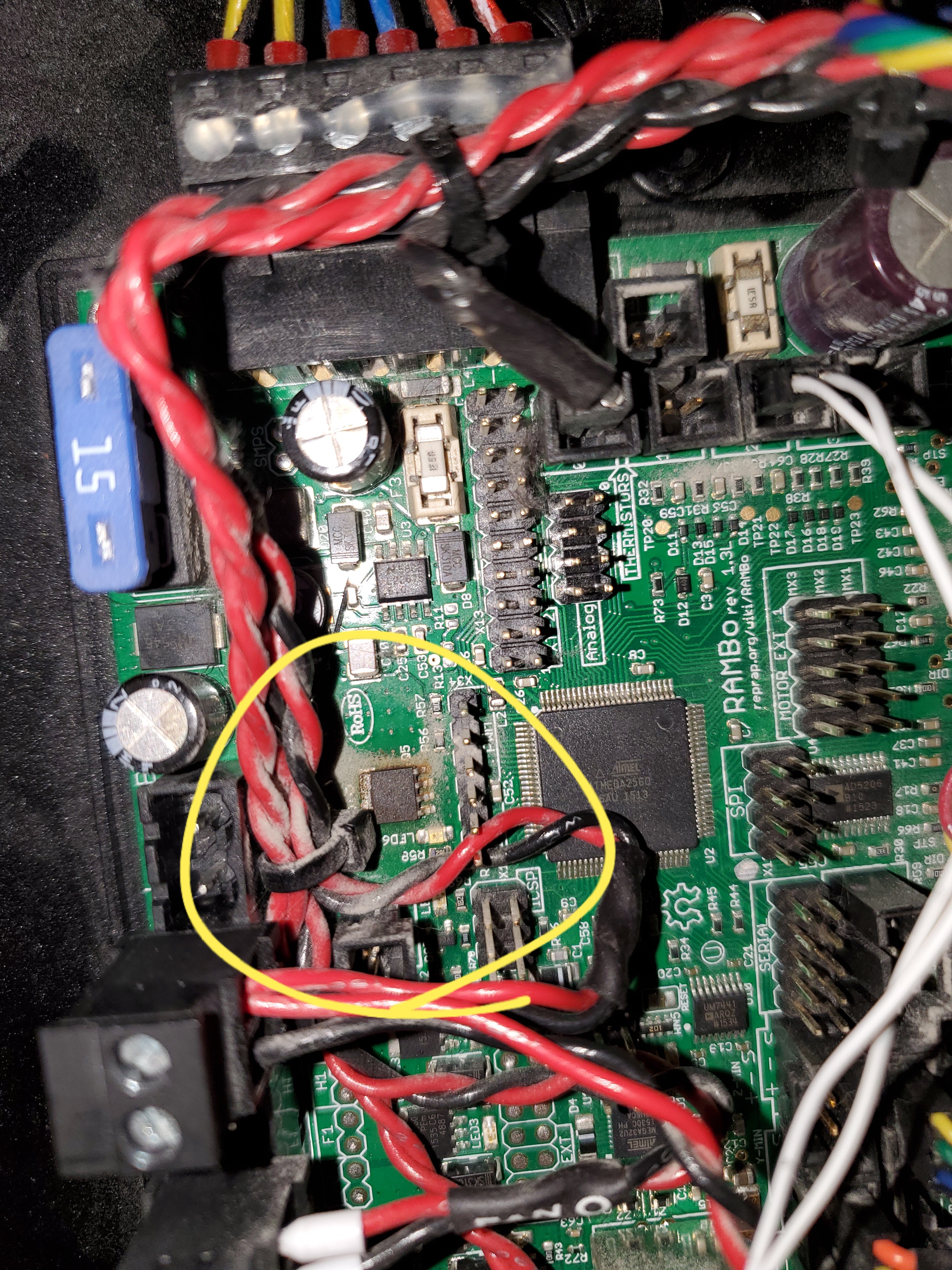

Is this the mosfet in question, and is it supposed to be covered in dark brown stuff? Already wiped a bunch off the top of the chip.

Just thought to swap the bed and extruded connection on the Rambo, and the bed heats right up. Rambo must be the problem, I'm assuming that mosfet. Can I replace just the mosfet or is that a symptom of a bigger problem?

Given that picture, yeah, things look grim in there. The fuzz is normal, but the MOSFET looks like it's been way too sweaty.
The MOSFET is firmly soldered to big copper pours on both sides of the PCB specifically designed to suck heat out of the solid tab on the chip, so, unless you're set up with PCB rework equipment, you're not gonna get that sucker outta there.
In principle, you could re-flash the microcontroller firmware with the Extruder Heat 1 output pin assigned to the Heated Bed function and move the cable over. That might be with considering, although it'll probably take a while to get all the firmware configuration options sorted out if you've never done such a thing before.
The least awful outcome: a new RAMBo is in your future.

Talking to support over the phone, unfortunately I can't swap the connector via firmware, as the heat bed uses that 15A blade fuse, which none of the other connectors are wired to.
I've got some replacement mosfets arriving tomorrow and I'll give that a shot before condemning myself to a new board.
